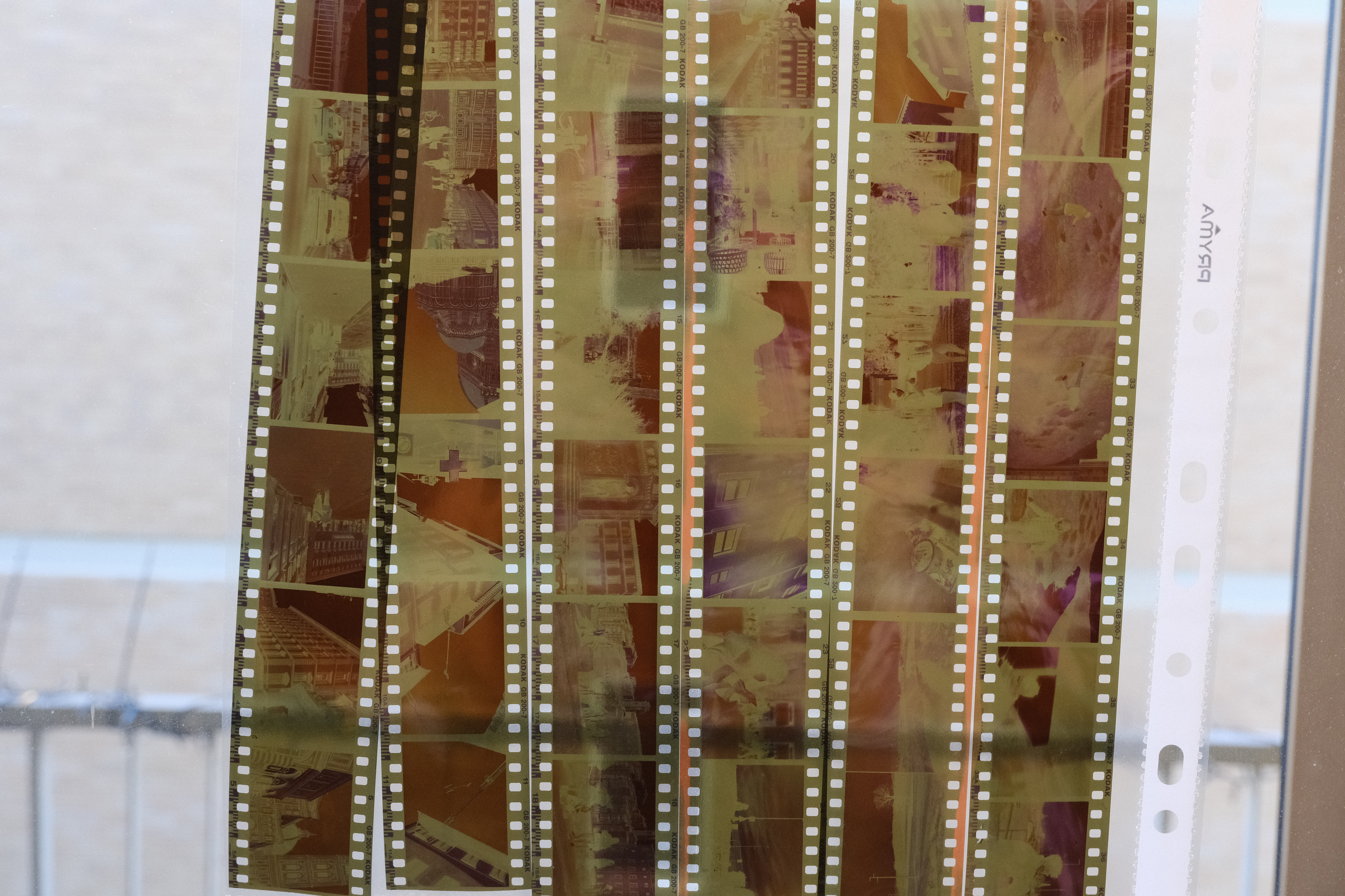

Hi everyone,

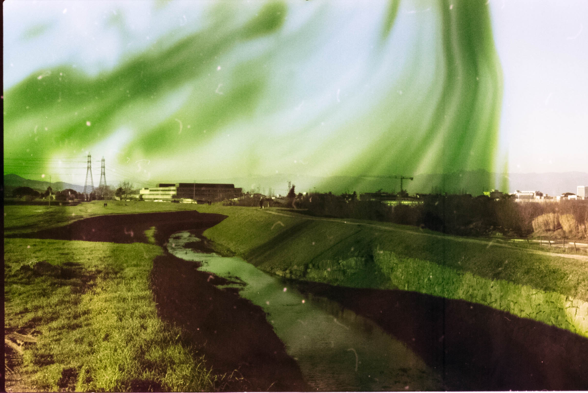

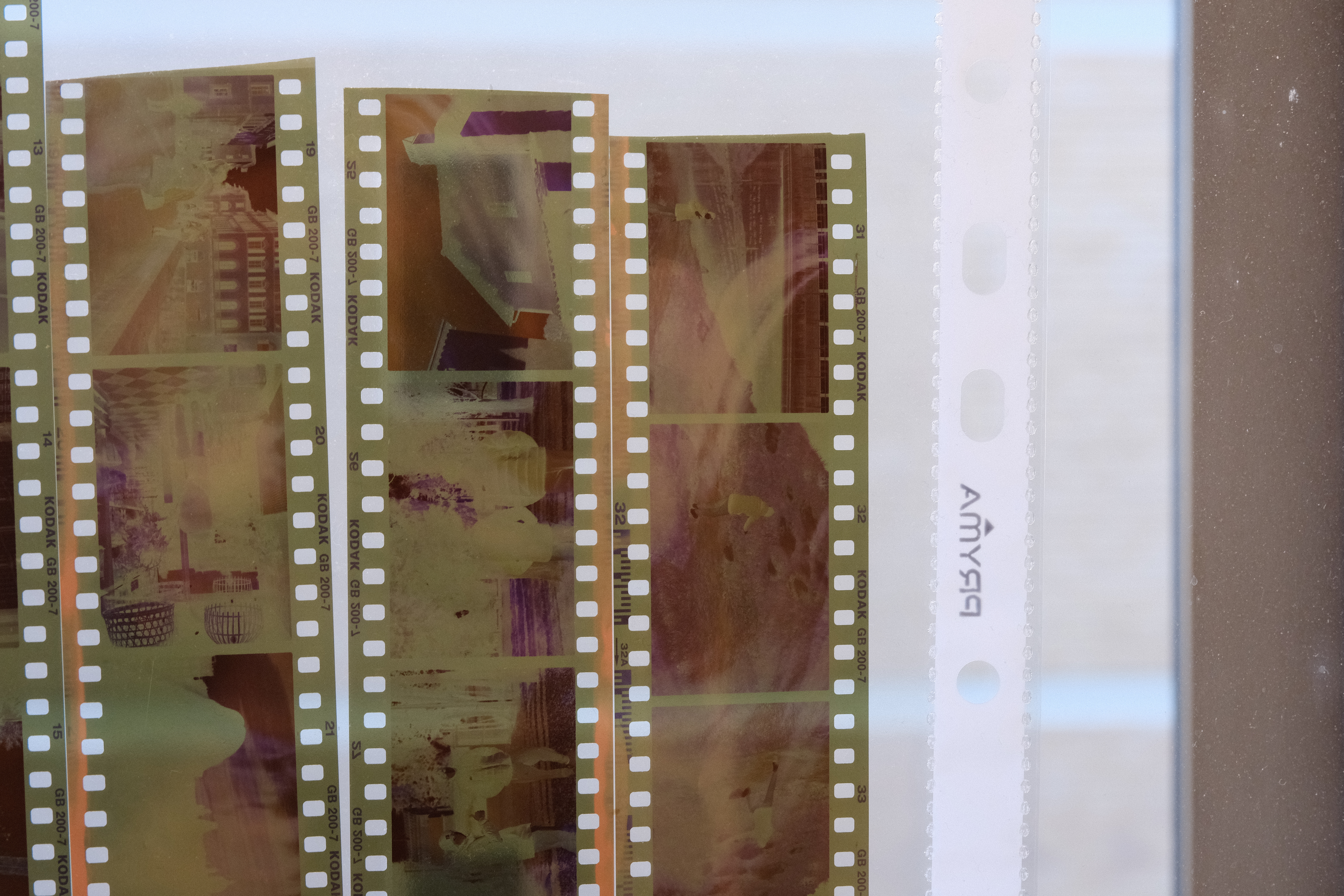

I recently developed a roll of Gold and it turned out a complete mess. Negs have a greenish base and there are harsh magenta spots around everywhere. A small amount of film border is even (almost) completely orange as if it fixed without developing. Scans came out dark and green.
My C41 chemicals are 6 months old and I successfully developed 13 rolls with them (not including this one). While I was extremely careful in storage by keeping bottles filled to the brim squeezing them and in a cool and dark place this is a clear indication of a need of replacement, as it was to be expected after such time. I have separate bleach and fixer and no stop bath.
Some examples:
Question is, what exactly caused this? I have the feeling the fixer may be exhausted as it took quite a while to completely fix a little piece of exposed film, though the orange part makes me think the developer did almost nothing there. Is this the action of both developer and fixer? Or it's a common thing to happen when the fixer expires? After all, rolls I developed previously came out fine. Does bleach expire?
Thanks!

Are you using a kit with blix, or do you have separate bleach and fixer? That looks like uneven silver retention, as a first guess. Look on the right end of the large single frame above -- I see a full dye set there, but then the green streaks in mid-frame.
Can you mix fresh bleach and fixer or blix and run the film through those steps again?

Yes as I said bleach and fixer are separate. Unfortunately I don't have fresh chemicals to mix, I will buy another kit shortly. Thing is, I wanted to avoid mixing concentrates if I can still use something :smile:

If you suspect fixer, the first thing to try is refixing in B&W rapid fixer. Ideally, you'd use a neutral fixer rather than the usual acid fixer.

Hmm. Then I guess there's nothing else for it than to try rebleaching and refixing when you next mix a new kit. FWIW, you can do these steps at room temperature, they just take a lot longer (especially bleach).

I tried re-bleaching and fixing a strip of negatives and the base is now somewhat more orange but still greenish and the magenta cast has gone nowhere.
Since I usually don't pay much attention at bringing them at exactly 38C (unlike developer) but more at "somehow more than room temperature" I heated them more and let the film in the tank for a really long time compared to the standard minute of my kit. As the base changed color it is definitely a bleach/fixer issue, and also unacceptable since I have always been good following the standard times without a very strict temperature control. I will just buy everything again and throw away developer and fixer. Last doubt though, do I need to also throw away my bleach? Or it lasts more?

Bleach likes oxygen, so six months in the bottle shouldn't be a problem, and it doesn't exhaust rapidly, either.
One way to test it is to take a developed B&W negative (or exposed, developed black, leader strip) and drop it into the bleach. Over the normal process time, it should turn milky and lose all of the black. Can't do this with correctly processed color negatives, unfortunately.
Ok, so that's fishy, but not the only cause of your problems.
First guess would be prior contamination of a development tank or mixing beaker, given the impressive swirl pattern. Another possibility is a major agitation issue (manual agitation started way too late into development) possibly combined with developer activity problems.
There's also a more minor chance of the magenta/green swirls being light fogging of a partially curled roll of film, with the excessive density throwing off the scanner in such a way that any of the other colors are subdued. Such are the woes of scanning, of course.
In any case you may find that C41 works best if it's done by the book. RA4 is more forgiving, C41 is pretty easy if you work consistently, with good/fresh chemistry and within reasonable bounds of the layed out processing parameters.
Too bad about this film but it's beyond repair, live and learn!
