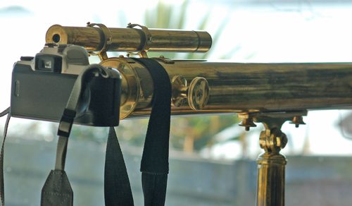

tonyowen
Nov 21, 2015
157
Anglesey, UK
image show setup and a 'capture of 4-5 miles away.
Checked 'oil marks' - best description is blue star surround by 'damaged' yellow square, surrounded by area of fuzz
