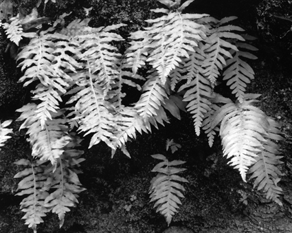

Why doesn't the green filter lighten green foliage?
It doesn't? See attached photo. I could have sworn that the ferns were green when I took the photo. Dark green filter, under a forest canopy, indirect light from the open canopy above a river to the side.
