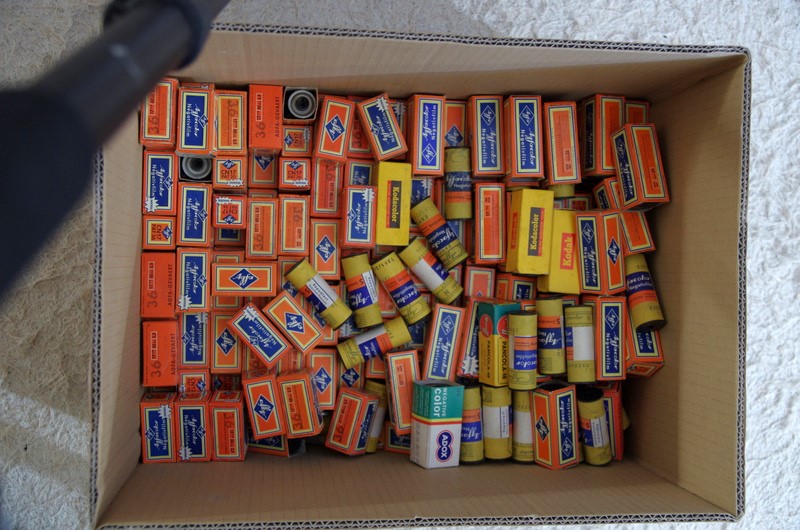

Long story short: hunt for old emulsions got me by half-accident almost 300 rolls of colour negative film from mid-sixties. At once. All exposed, yet not developed. And what a film!
Recap from the flickr 'fossilised film' group http://www.flickr.com/groups/fossilised_film/discuss/72157632280252220/ :
So there was an expired film lot on the 'bay. From the sixties. So, whynot to try out. On the pictures there were some exposed and not developed rolls visible. Whynot again, no problem to develop them.
The package arrived today, all good.
Then came the first shock: it appears that all the films are shot and not developed. So now I have 9kg worth of undeveloped 120 and 135 Agfacolor CN17 from the mid-sixties. Ca 250+ rolls, some not dated, some dated and with location remarks. Lovely.

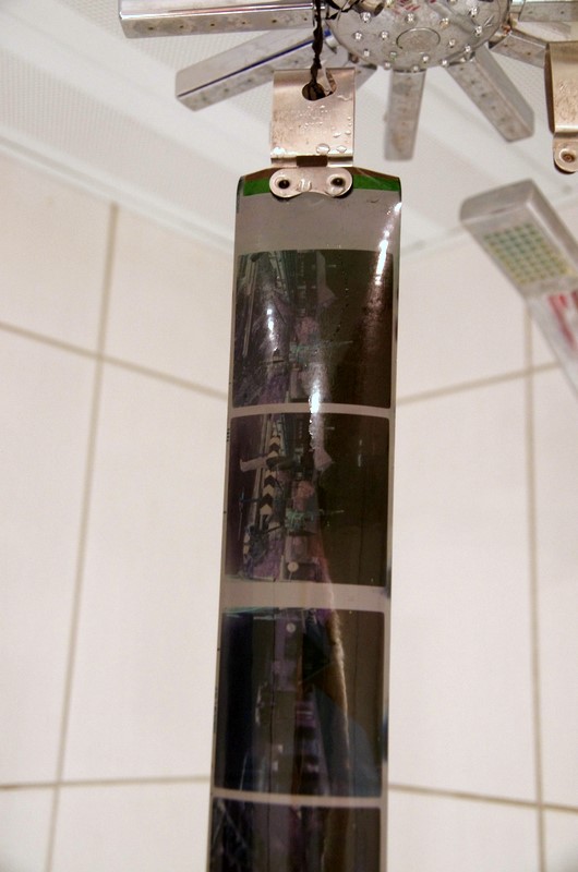

Decided to give a quick 20C/20min C41 shot on some random 120 roll, without the date specified. The backing paper was quite stuck to the film base, not emulsion side. Whew, after some hassle got it onto reel.

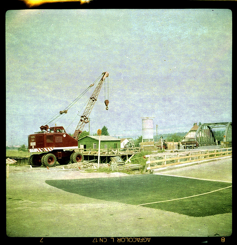

The usual dev/blx/fix routine and opening the can after first washing water to check the result. Then the second shock arrived. The film looks like this (well, after removing the remains of the backing paper) :
And the result scanned:

Added some more pictures to the set, from 135 as well. To me those look clearly like amateur shots, not newspaper or something else that would be paid for. Just everyday life and events around Tiengen-Waldshut in south Germany, just near Swiss border. According to themes of so far developed pictures I would bet on some young man having the camera with him. Who is probably identifiable by his car, from the German DOT equivalent office.

Standard C41 at 38C will probably destroy the film, as the original process was run at 20C and almost twice higher temperature could harm the emulsion.
Agfacolor uses the same process as Orwo 5166 colour did, well the latter copied from the former of course. And as I have developed Orwo NC in 20C C41, I figured it could not go that wrong. 20min time is from various sources, notably PE comments on photo.net 10 years ago or so. Then again, some days ago I got carried away and forgot about the film running on Jobo and developed it for 37 minutes. Luckily without any ill effects, just a bit overdeveloped.
I use Tetenal 3-bath minilab chemistry with replenishing.
As long as you are scanning the film, crossprocessing looks fine to me. Trying to wet print could be tricky, have not tried it yet.
What kind of 'image loss' do you mean?

I mean latent image fading, like it looks good now then fades away for some incompatible chemistry reason.
While I'm at it, know if E-6 would work on fomachrome/ORWO chromes? Hehe
Well, latent image is not that latent at all after treatment in the chemistry. It probably will fade for sure, as all films do. But nothing has changed within couple of weeks yet :smile:
You will get a bit wicked negative from Orwo UT in the same 20/20 C41.
