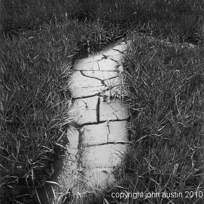

Scanning or enlarging?
If you take the noble path, try working with a diffusion enlarger and see if that gives you the tonail quality you are striving for
Another way of lifting shadow contrast is with very careful wiping with dilute Pot' ferricyanide reducer, or the modified version which is the bleach part of sepia toner - This is what gives the highlights to the muddy grass at Severn Beach and Steart Flats in thse late 1970s images
In my experience older lenses do have more flare which fills in the shadows a but, but also softens them, so if you modify your processing too much the shadows may become muddy - However only testing in your environment will give you true answers
