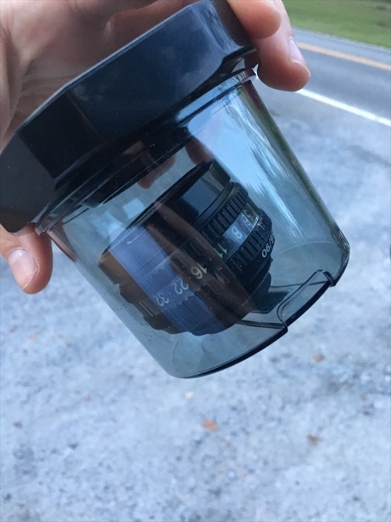

Got a fujinon 90mm EX in the post today. Advertised as in excellent condition and it looks it too BUT it was packaged loose inside its enlarger lens holder (the plastic bubble type). So while the holder was surrounded very securely with bubble wrap the lens itself bounced around inside for the long journey from Japan.
1. I'm going to print an identical photo to one I've done with my older 90mm. What's the best way to compare them to judge if this new 90 became a dog?
or
2. Should I just return it? It still looks great but I need a really good 90.

if the lens surfaces look exellent there is no reason why the lens shouldnt be as well.
no need to worry too much.

My guess is that the seller probably screwed the lens on to the thread in the bubble, but did nothing to make sure that it didn't unscrew itself in transit.
Unless, of course, the customs people inspected it and didn't return it to the threads.
I would check for alignment issues and see if there are any signs of loosened elements.
You can check alignment by setting the enlarger up to do a big enlargement using your old 90mm lens, and then compare the sharpness at the corners with the new lens.
Also check that the aperture mechanism seems to be functioning correctly, including the detents.

Let the seller know what happened and tell him you will make some tests !

It is a simple lens that can withstand a lot. If all looks o.k., it will perform as expected too.In these packages, with rough handling the plastic top is what goes down first. Lucky you got it like this.

I'd definitely test it, and return it if you have any doubts. You say yourself that you wanted a good lens, and (if you're anything like me!) you'll not enjoy using it if you're not entirely happy with it, or feel doubtful that you're getting the best possible results.

Thanks guys I ended up discovering some faint fungus behind the front element so I asked to return it (untested). Bought a second one. First seller refunded me and told me to keep it so I'll have two to compare I guess!
