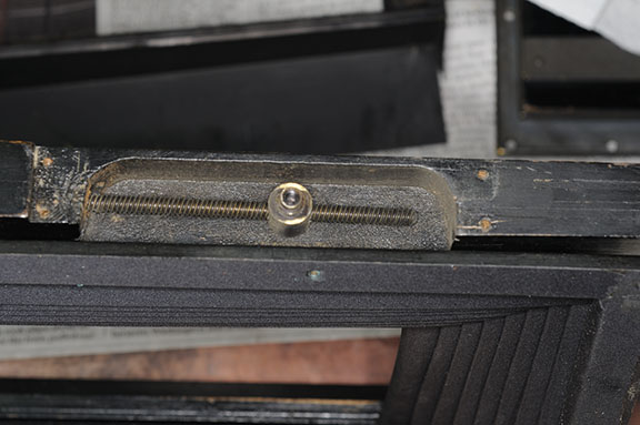

Yesterday I removed the rise/fall helicals from a Home Portrait Graflex, cleaned them, then applied the TriFlow synthetic grease refenced in post #5 in a bead about 1/2 the diameter of a round wooden toothpick along the thread length then wiped it around the helical with my finger. Running the nut the full length of the helical resulted in only a trace of the grease on the side of the nut. If its too stiff on your lens helical perhaps you are using too much.
The helical before cleaning.
