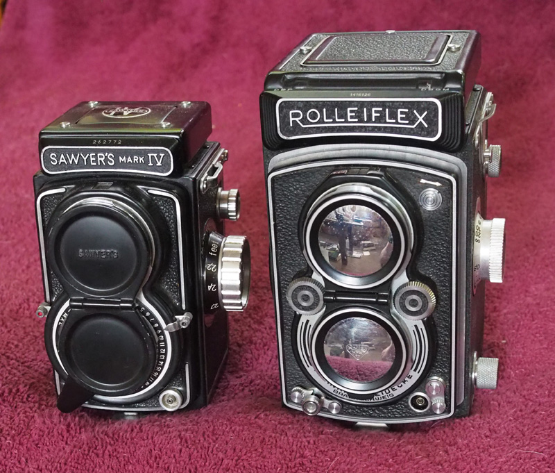

If you like chromes, 4x4 will still mount in a 2x2 (inch) slide frame and fit a standard projector instead of needing a "super slide" setup. Also, for quality TLRs, the camera weighs less than half what a good 6x6 TLR does. If you like oddball cameras, there are a few that were made in 127 only (Foth Derby, for instance).

Never handled a 635, and the only 44 TLR I have is a cheap one, very limited shutter and red window advance -- but give it's 1/3 smaller in all dimensions, if it's built the same way, it'll weigh less than half.

As to why I go to the trouble? I guess for me keeping a dead format alive is cool, like how many people shoot 127 now? I love shooting square and most 120 6X6 cameras with accurate focusing are much larger/heavier. Compared to a Rolleiflex/Xenar, (I consider these equiv in quality/features/optics) the rollei is 2.5lbs, the sawyers is 1.4lbs. The negs print well and it's basically like shooting 6X6 vs 6X4.5 (compared to shooting 35mm), you can crop how you want in the darkroom.

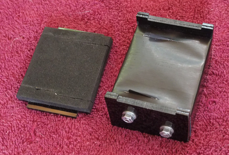

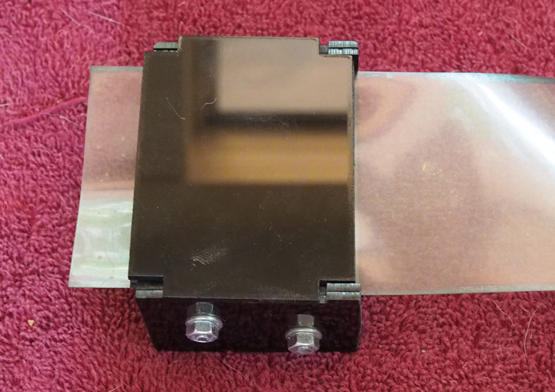

The width? I use a tool that looks like this I bought on etsy. It has 2 razor blades, you put the 120 film in, hold the lid down and pull it through. Then I cut it to length and am ready to roll!

Not really. You just pull the 120 film off the roll, place it between the side guides, put the top on the cutter thing and pull it through. Then again I've done a lot of work in the darkroom like this, processing color prints etc so maybe it's harder than I think, for someone who hasn't done a lot of work in total darkness. The main thing is lay everything out before you start and stay organized.
