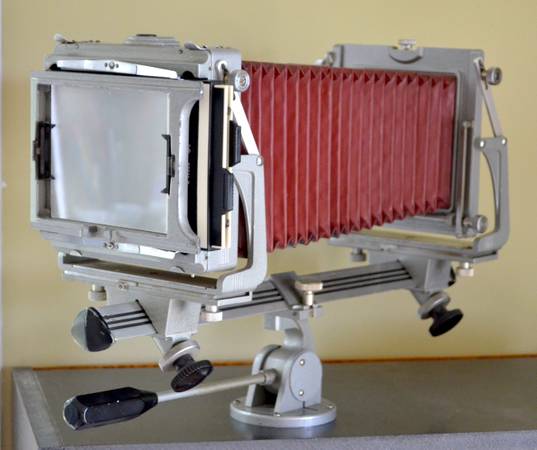

I received the Graphic View (original) today and it is not as nice as I had hoped:sad:. Looks to me like the bellows and ground glass need replaced. The lens (7 1/2" f4.5 paragon anastigmat)looks real clean, but the shutter (Ilex No.3 Acme) sounds like it only has a few speeds. Anything below 1/50 sounds the same or doesn't work. B and T aren't too swift either.
Is there any way to clean/lubricate the shutter mechanism? The only screws I see are the ones on the front of the lens that appear to hold the nameplate in place.
Also, where is the best place to get a new bellows? The one on the camera has several patched spots and just looks like a mess.
Probably going to wish I bought the much cleaner model that I saw in Amish Country a couple of weeks ago...
Thanks in advance for any info.

Ilex Acme shutters use hard rubber shutter blades. Solvents such as Naphtha (lighter fluid) and Lacquer Thinner will destroy the shutter. I can do a CLA for $70 + shipping if you are interested. A functional View I or II should go for around $250 without lens. The Paragon is not a real popular lens and should go for around $175 in a working shutter.
The Acme is not a complicated shutter. Your #3 will be similar to http://pheugo.com/cameras/index.php?page=acme2 but may be a steep learning curve if you haven't serviced a shutter before. Take a picture before and after removing each part. Little thin brass spacers stick to the part or case only to fall off later.

You should be able to pick up a lens for $100 or less but any of them may be in the same shape as the Paragon. The sticking B&T and no slow speeds is indicative of old lubricants and a CLA will cure it. As Shutterfinger mentioned, about $70 to fix it.

You'll find the service manual, http://www.southbristolviews.com/pics/Graphic/manual-pdf/GraphicView2Service.pdf , useful.
I have repaired questionable bellows by bonding darkroom blackout cloth to the inside of the bellows using DAP Weldwood Nonflammable Contact Cement, http://www.dap.com/product_details.aspx?BrandID=48&SubcatID=8 . Darkroom blackout cloth may not be available but player piano bellows cloth is, rubberized .008 thick cotton or nylon. Cut the cloth to be the same length of the bellows and an inch or two wider than the perimeter of the bellows. Offsetting the seam of the new lining apply the contact cement to about half of one side of the bellows, apply the cloth cloth side to the cement, press out any air bubbles and repeat for the adjoining area until the bellows is completed. Allow to dry. The dried contact cement rubs off easily. Refold the bellows one pleat at a time. Very durable.
