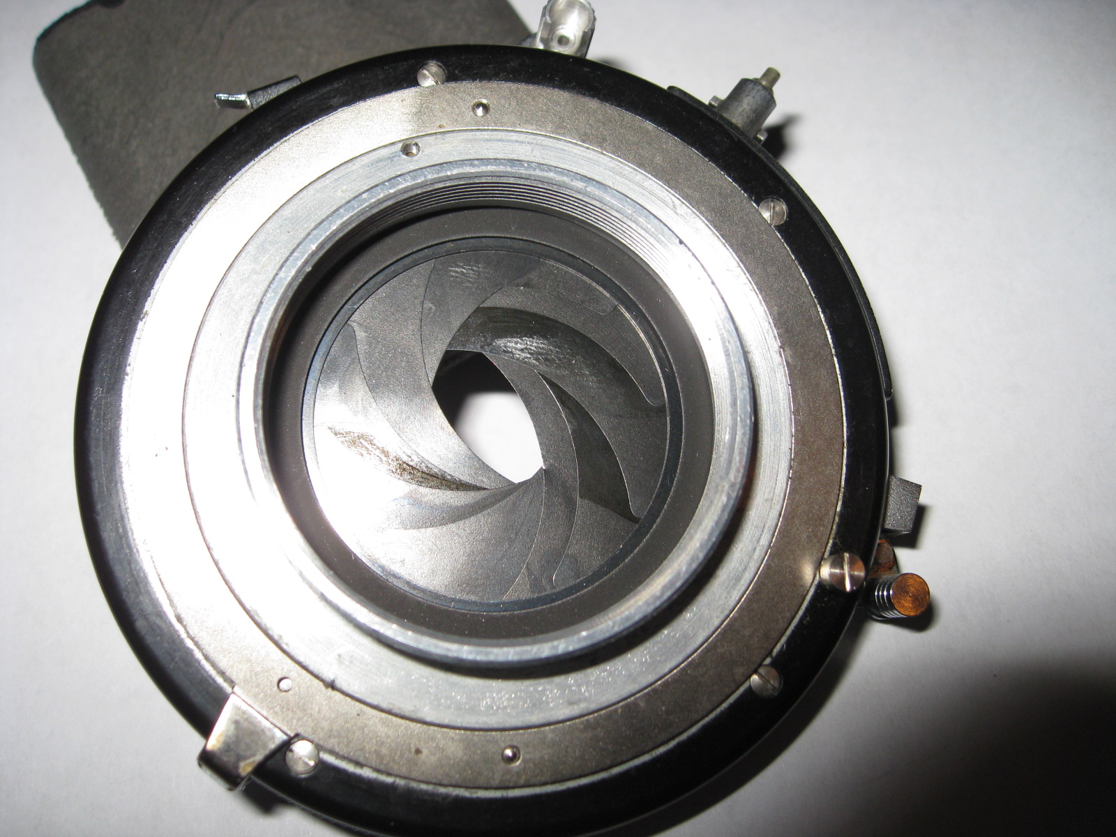

This shutter is in great shape overall with very good Ektar 127mm elements and a fully working shutter...However, the iris is jammed somehow and only partially opens or closes.
I'm pretty good with fixing things and feel like if I knew how to disassemble this, I could realign the iris.
Is this feasible Or "Don't Even Think About It". I figure paying to have it repaired would not be cost effective.

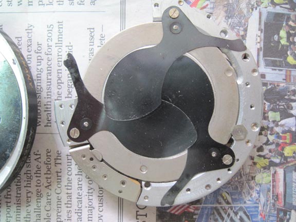

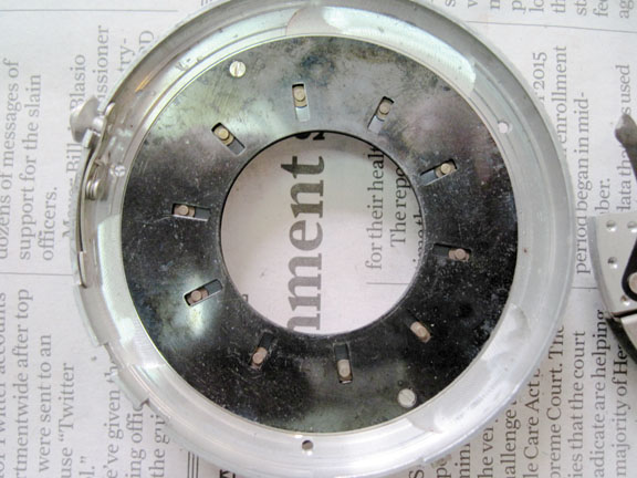

A pivot pin is broken off 1 blade and it being out of position is causing another blade to buckle. The aperture might open without any further damage. Your only positive here is the blades are made of thin metal, not paper. The pin may be the stamped pin hole edges folded up/down 90° or the pin may be a short piece of brass making it repairable.
The shutter is likely a CN-1307-000, Synchro-Compur 1-MX or one of its many variations. Take pictures as you remove the parts to make reassembly easier.

Broken pin. Send it to Carol http://www.flutotscamerarepair.com/ Her prices are low but there maybe a well worth it wait.
