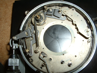

Supermatic X shutter opened

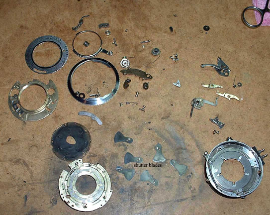

Flash Supermatic shutter has only a few more parts than a Supermatic X, Flash Supermatic fully disassembled
