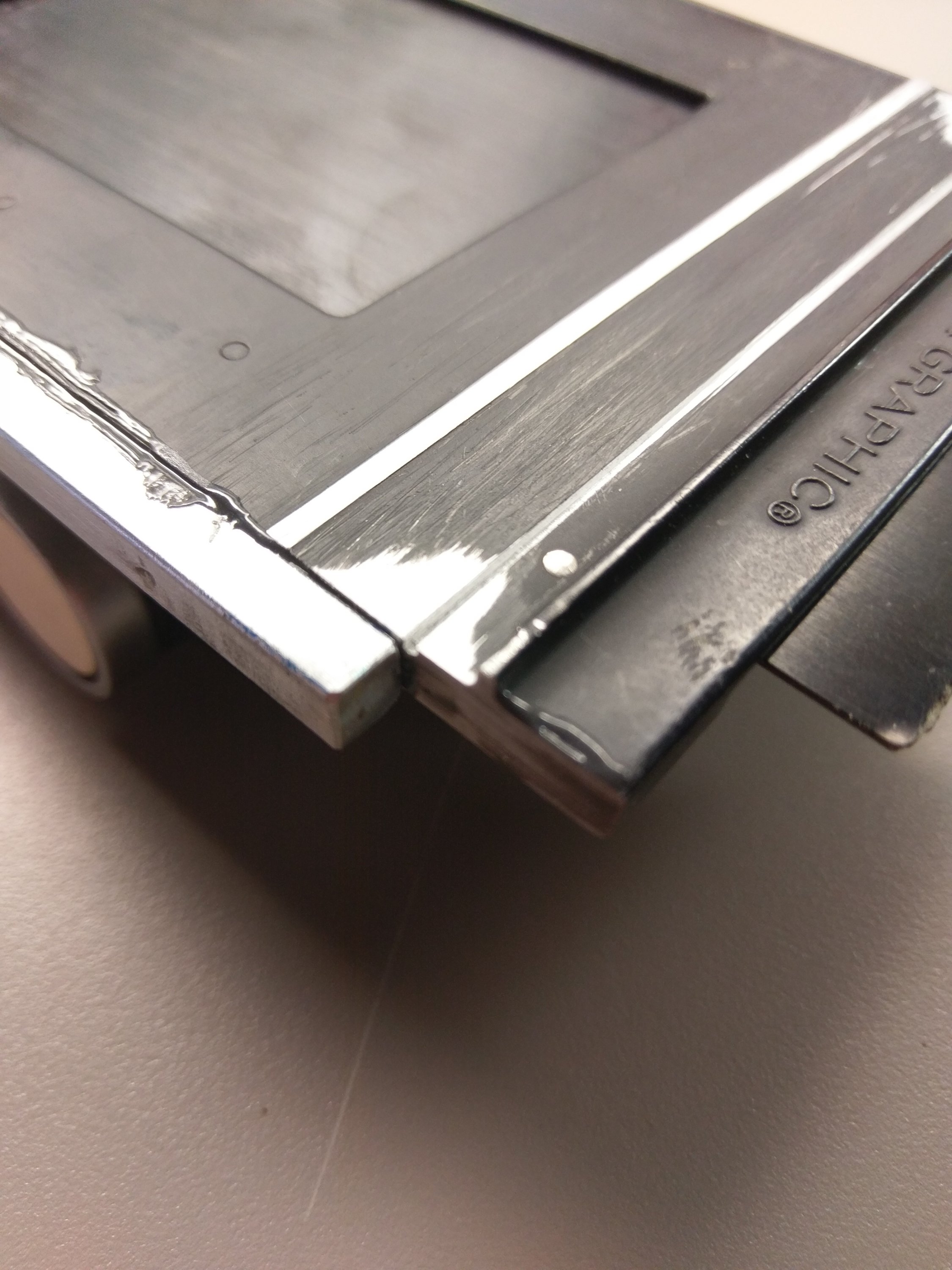

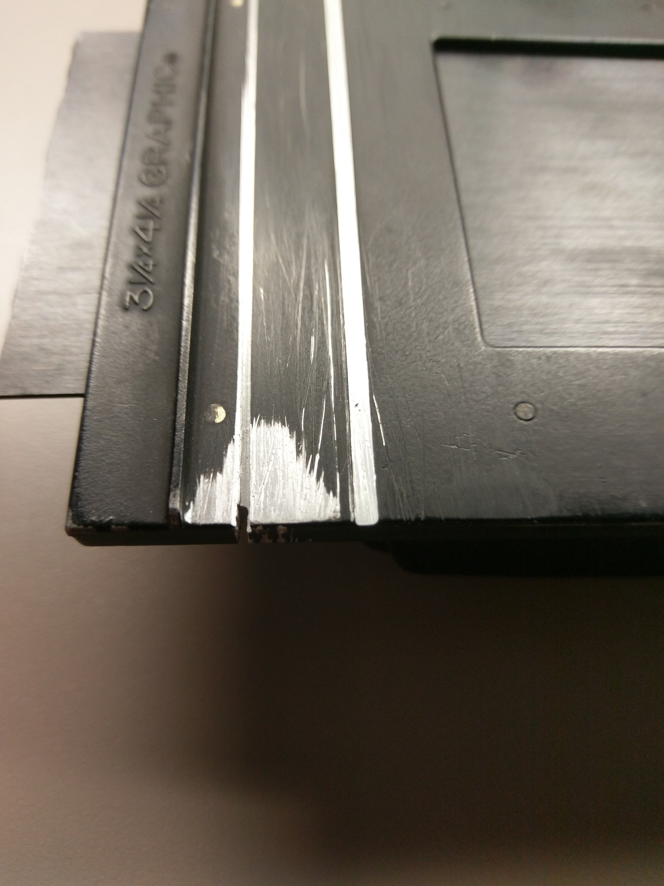

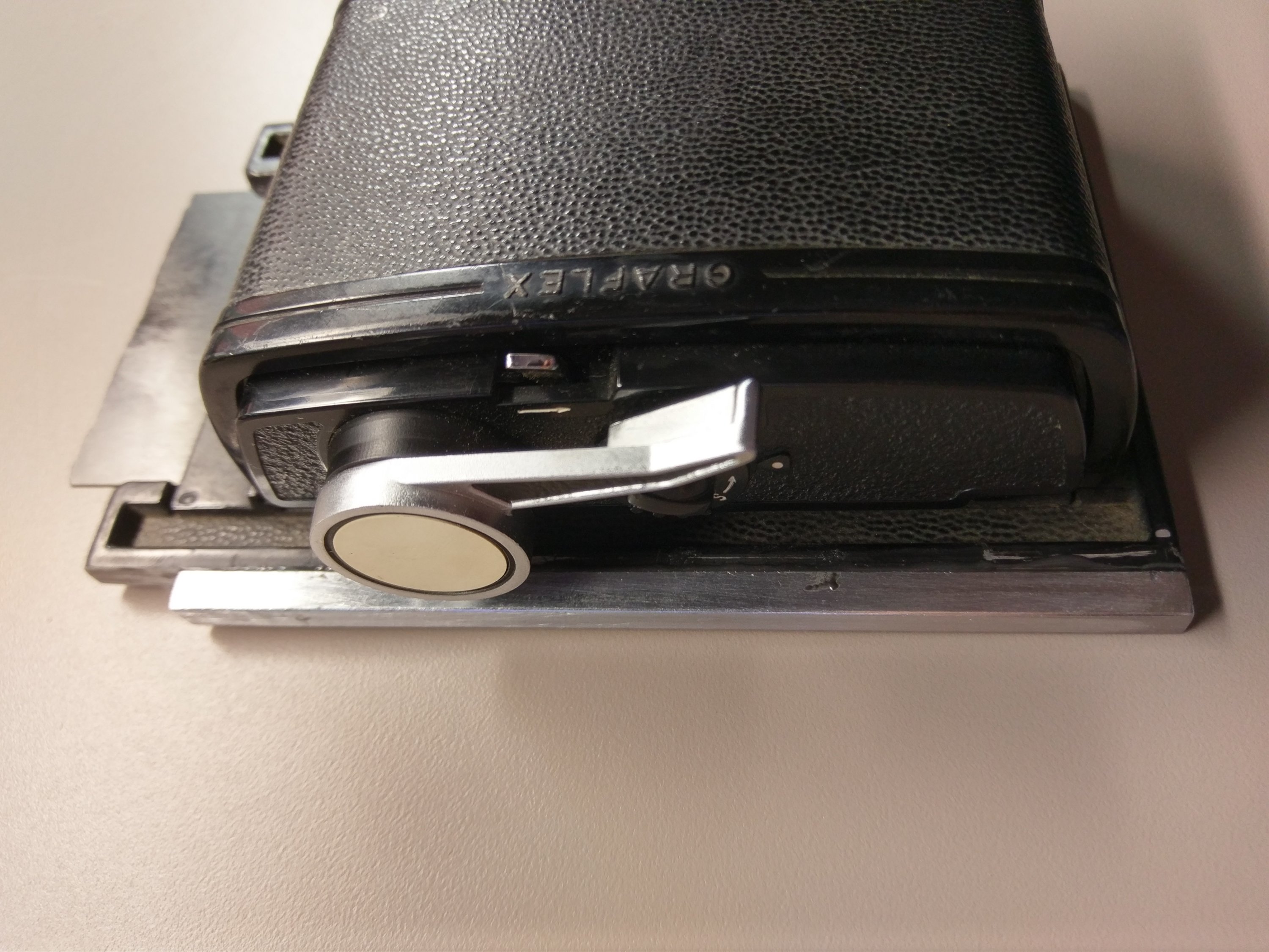

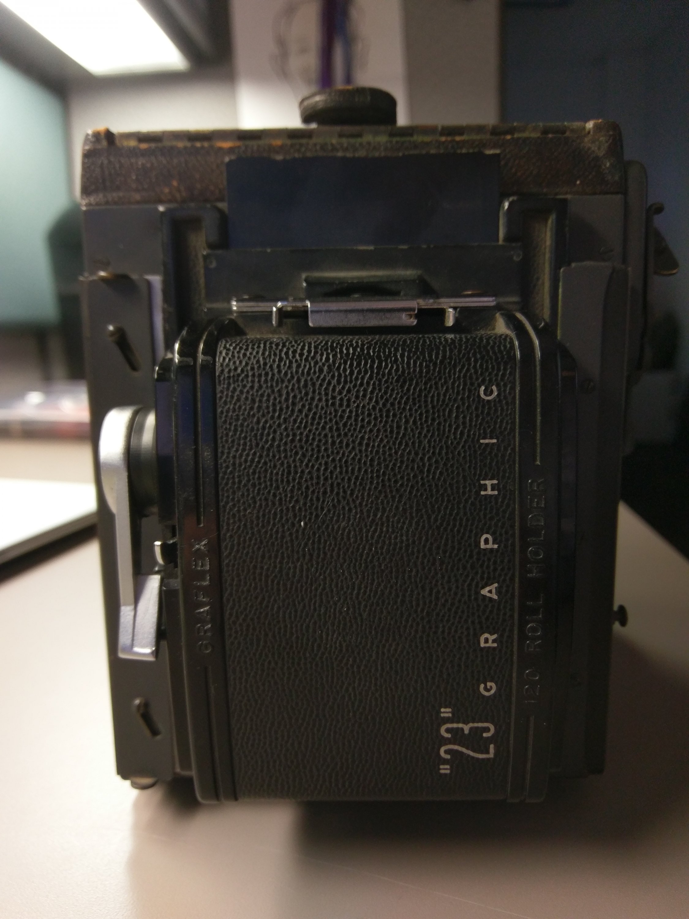

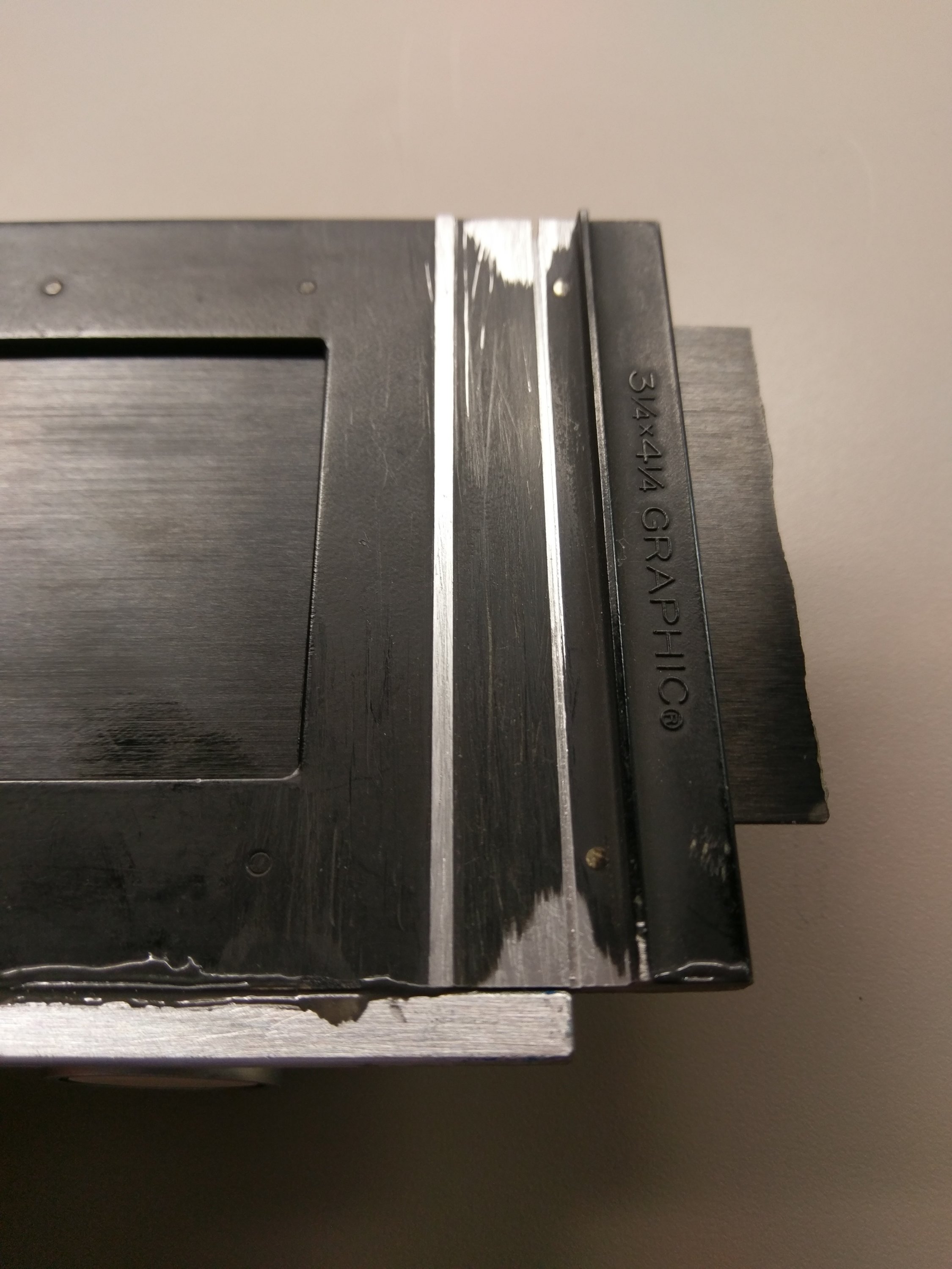

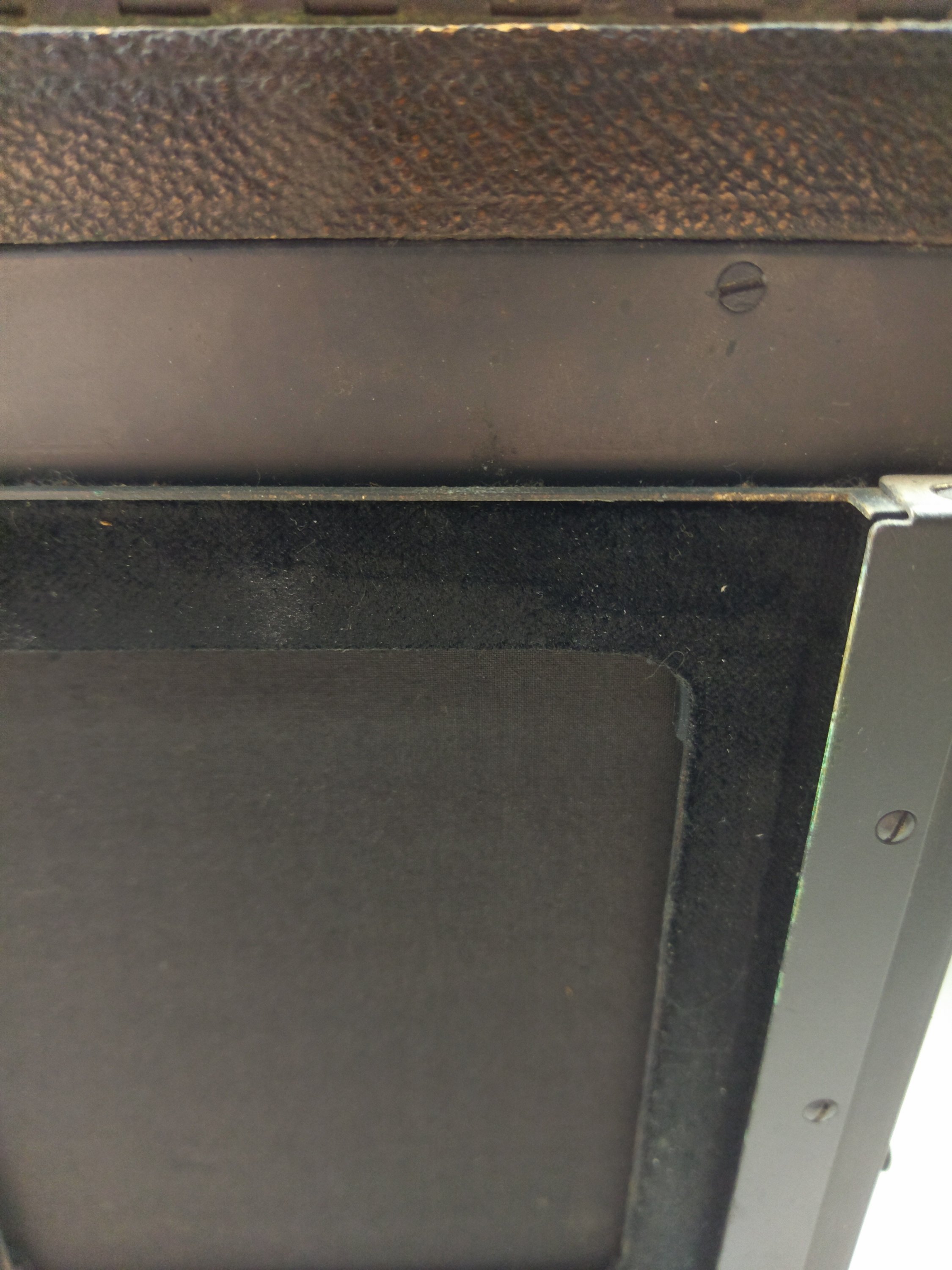

I picked up a Graflex RB series B not to long ago and it came with the cut film magazine which was, unfortunately, incomplete. Everything else was in good working order, though. I had a 2x3 back that I wasn't using and I thought "I bet I could make this work". So I proceeded to find a Graflex 3x4 shell to go with my 2x3 insert. A bit of hand machining and fairy dust and I now have a roll film back for the RB! So far, everything seems to be in order - a little sharpie on the ground glass helps with framing and I believe focus is OK. The 6-3/8" lens comes in just a bit longer than normal so I'm hoping it will make a fine portrait camera. A few photos of the conversion follow.
The back needed a notch cut on one side and a channel across the face to fit. I also filed down one of the ridges on the face so it would sit flat. A piece of 1/4" steel bar was the perfect thickness to allow it to be held by the slide. JB weld worked it's magic here. In order to make the width fit, I had to grind down the side where the steel is attached. Everything is light tight so I'm not sure if I'll smooth out the jb weld and paint it or not.

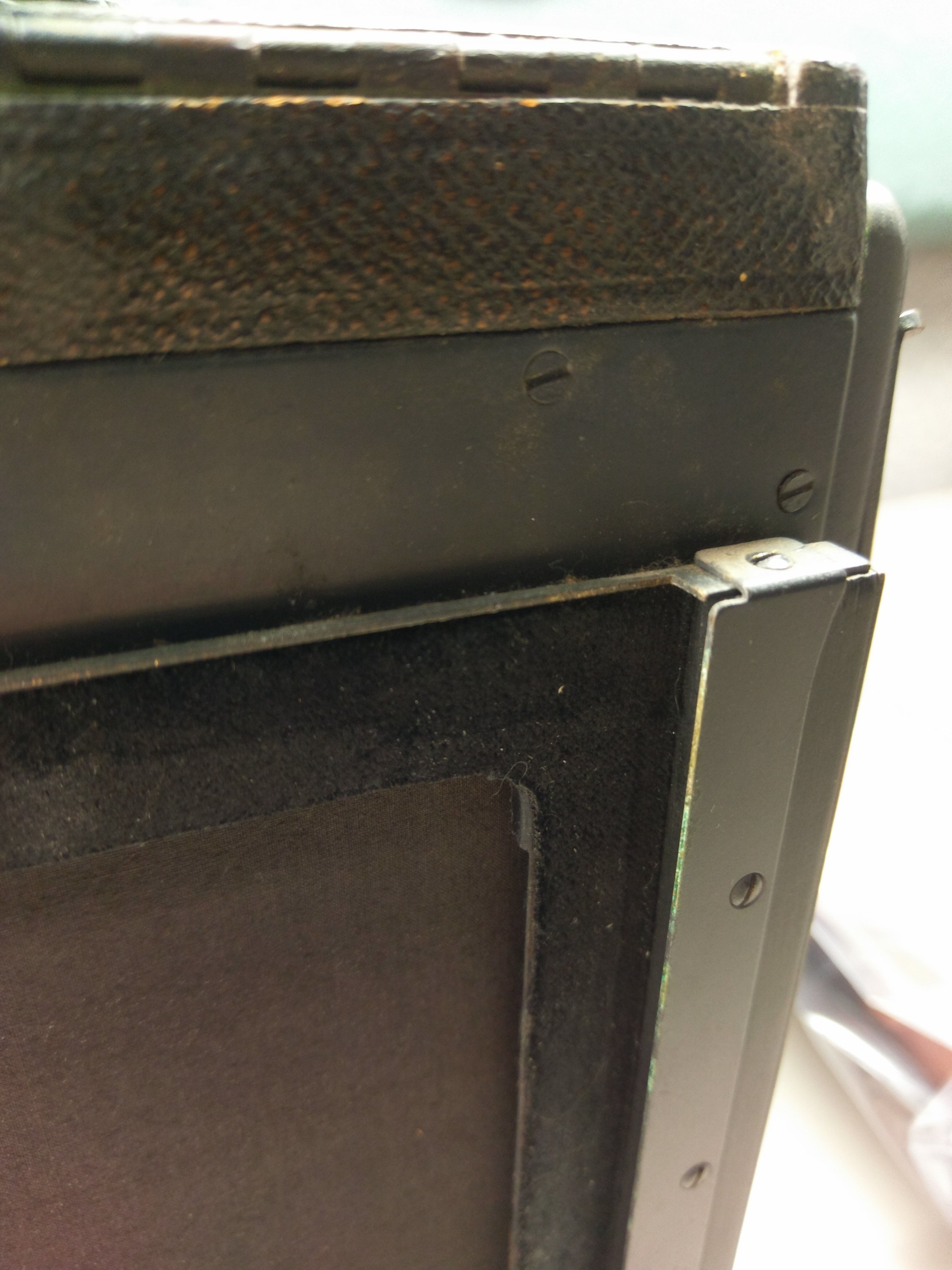

Visit http://www.graflex.org/
With the back removed from the body there are 2 screws along the outer half edge and 2 screws accessible when outer section is rotated 45° (hard to see as they're under the felt) that hold the wood frame block to the back frame.
New wood blocks can be made to reduce the holder frame opening for the smaller format or for modified standard 2 sided film holders.
Oh my gosh - I completely missed the button for the rotating back! I though I had a non-rotating version so I checked for the button and sure enough, it was right where it was supposed to be. I may do something like this in the future so the back is centered. It looks easy enough to modify.
