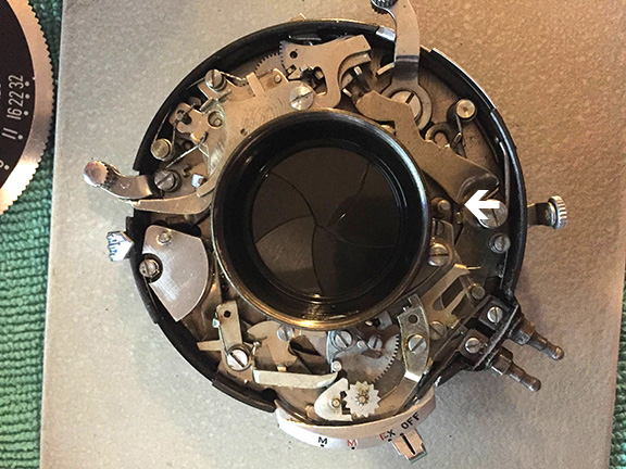

Now that I have more time on my hands
The booster spring goes on the post close to the center core with the long end down and seated in the slot of the main cocking lever (white arrow).
Thank you! This was very helpful to me. I just received a 4x5 Crown Graphic with the same lens and shutter. It was stuck so I decided to look inside but also had this spring pop out and had no idea where it went. One question (if you're still around) - the spring settles nicely on the post, long arm side down - does the spring's arm go under the cocking lever or over - or some other place? And what is its purpose? For now, the arm on my spring is under the lever. My shutter seems good after a little exercising. Having it open allowed me see where it needed a little push (from my flat head screwdriver) - once that was done I could see I wouldn't hurt it by cocking the lever, which became easier and easier with each sequence. It seems the bulb setting didn't work until the dial retaining ring was reinstalled.
