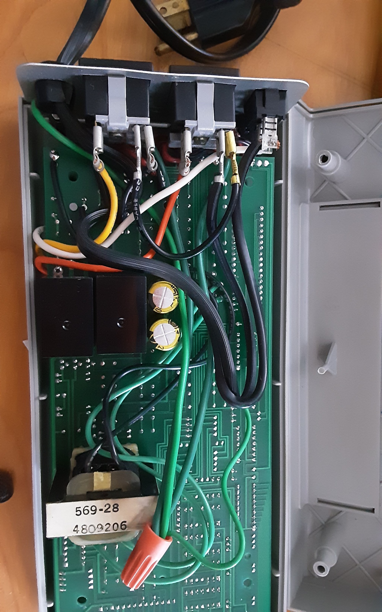

I opened the Gralab - it smells of polymerised toast although it looks surprisingly non toast. The circuit board looks unmarked ...is it possible maybe the blown parts along the circuit spike surge not have destroyed it beyond repair..
I would keep exploring. There's a good chance you find it repairable.
That's says very little; if there's damage to it, which doesn't have to be, it would be on the top side.
Start by measuring the primary winding of the power transformer; if it's more than a few hundred Ohms you'll need a replacement. When that's settled, power up the unit and start measuring the various supply voltages to see if they make sense. It would help to either find a schematic on Google or otherwise trace it yourself.
If you don't know what the above means, try and find someone with electronics troubleshooting experience and bribe them with a case of their favorite beer.
There is no visible damage. You need to find which component made the loud bang you heard.

The top side doesn't look any different from this side. Doesn't look like burnt toast!
