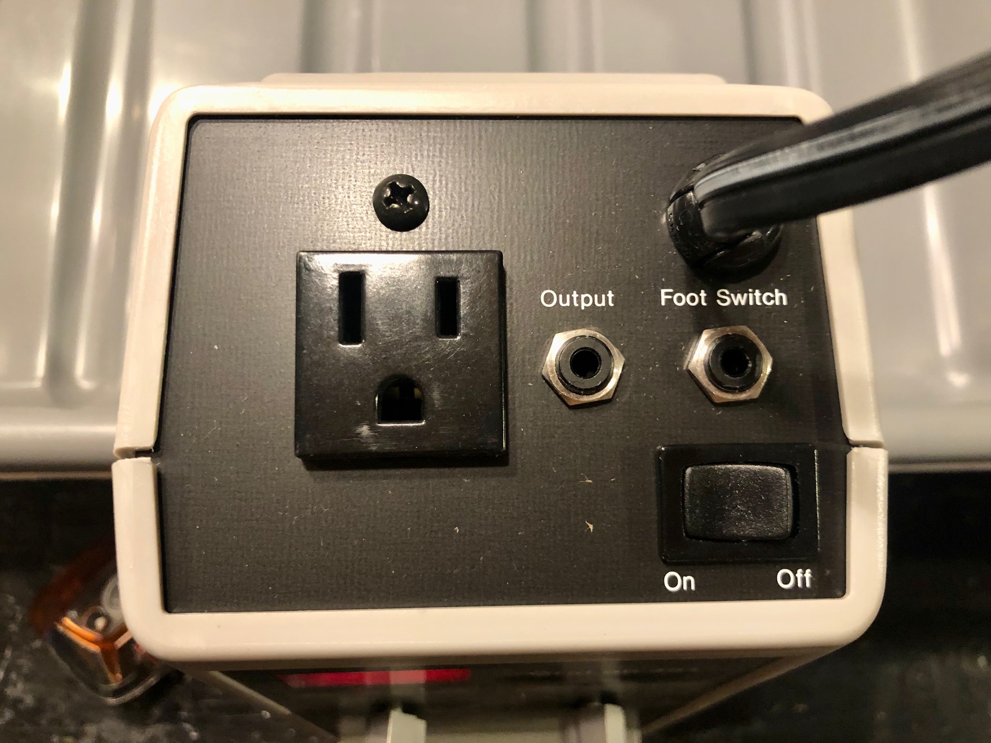

Hi, all.
I have a new Gralab 451 timer, setting it up right now.
To my dismay, it doesn't have a dedicated safelight control output.
According to the very very brief instruction sheet, it does have a "logic level output jack":
"A logic level compatible signal is accessible through the output jack. An optically coupled transistor provides the signal.
Its on/off state parallels that of the AC outlet and provides a maximum voltage of 30VDC with 30mA of current."
Those are all new concepts to me and I have been searching around for answers.
Apparently few people do darkroom work these days....
What do I buy to set myself up?
Thanks!
Jimskelton
Jan 16, 2023
48
Alberta, Canada
I looked this up at Gralab's website and they don't say it's specifically for darkroom use, but for "factory, lab, or studio." None of the accessories for it offer a normally on switch for a safelight. the output jack isn't meant for a 110v device, though may be able to be connected to a relay that control a high voltage lightbulb. The only way I can see making this work automatically with a safelight is to connect the output to a relay that has both sets of contacts for normally on/off, connecting the safelight to the former. It's not really a trivial project.
But, you could still use this just fine and manually switch off the safelight when enlarging if you like.

Perhaps the easiest solution is to use the enlarger-output to control both a relay and the enlarger. The relay would be normally-on, and would turn off the safelight when the enlarger is on.
Such relays are common and cheap. Here's an example: https://www.digikey.com/en/products/detail/picker-components/PC113-2C-C1-120A-X/12318174
This solution is trivial for somebody comfortable with mains electrical work. For somebody else, it's probably not trivial.
Mark
That is exactly what I did, but I got an industrial relay with a ver fast, prompt, switching reaction, thus with a minimal 'death' time.
The death time is the time needed to switch beween contact A and contact B. Also it has a strong induction magnet coil driving the reinforced switch contacts.
It can be used on any enlarger timer.
It works on 230 Volt and switches 16 Ampère 50Hz, and it lasts for more than 30 years now.
