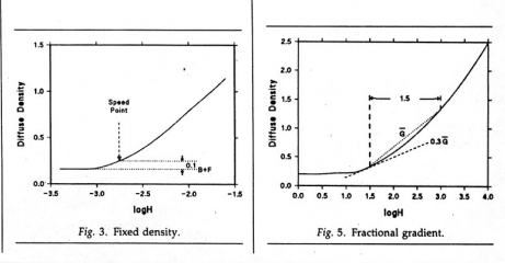

As for cutting development time equating to losing speed... there are a couple ways people determine speed. One common way is to call the speed point at where the curve crossses 0.10 above base+fog (Left). Another way is to call the speed point as where the curve turns to 0.3 times its average gradient (Right).
When you develop less, as the curve gets flatter, you can still get details in the print from where the 0.10 point used to be... even if shadows fall a little under 0.10 with less development. You can still get detail there. So my philosophy is: Unless you are deliberately pushing for speed, just pick one favorite film speed setting for a particular film, regardless of how you develop it. Really push (develop longer) and use a higher film speed rating when you need it for a particular picture, like available light handheld where you need the f/stop and shutter speed.
