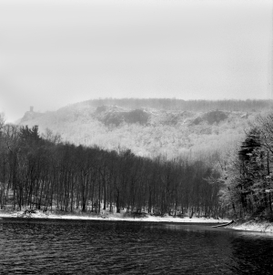

Hi all,
I have a question regarding this pic and wondered why it looks grainy in the lighter areas. I went today and took a few shots at a reservoir in a overcast day. This particular shot seemed a little fuzzy and grainy in the sky just above the tree line when zooming in. Could this be reticulation?
The higher in the sky, the less grainy look. It looks foggy, but it really wasn't that bad. the sun it behind the heavy cloud cover in the upper left.
FP4, adonal, 1:25 9min
Exposure was lightened in PS.
I will say my rinse water was probably about 8 degrees cooler.
Thanks - Rich

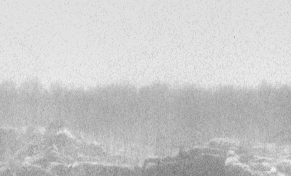

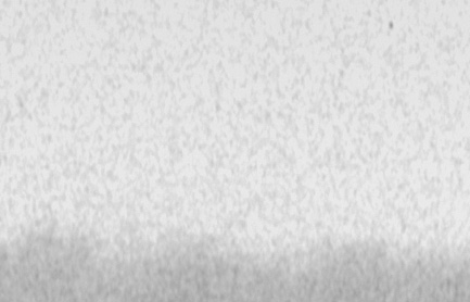

Here's what the fuzziness looks like up close.
Just wondered if this looked like typical grain or reticulation possibly.

Can you see this in the negative with a loupe or in an enlarger?
It might be evidence of scanning artifacts.
Gerald C Koch
Jul 12, 2010
8,131
Southern USA
Reticulation has a very distinctive appearance sort of like looking at a pan or worms. The pattern is full of twists and turns. Your sample does not fit the expected pattern. Then too reticulation is very hard to induce with modern pre-hardened emulsions.
Excessive grain is a micro phenomena, in others words you need some magnification to see it. Reticulation on the other hand is a macro phenomena, it is usually visible to the unaided eye. Reticulation is caused by two layers of an emulsion expanding or contracting a different rates. You can see portions of the emulsion buckled in relation to other portions of the emulsion quite clearly when viewed with a glancing light source.

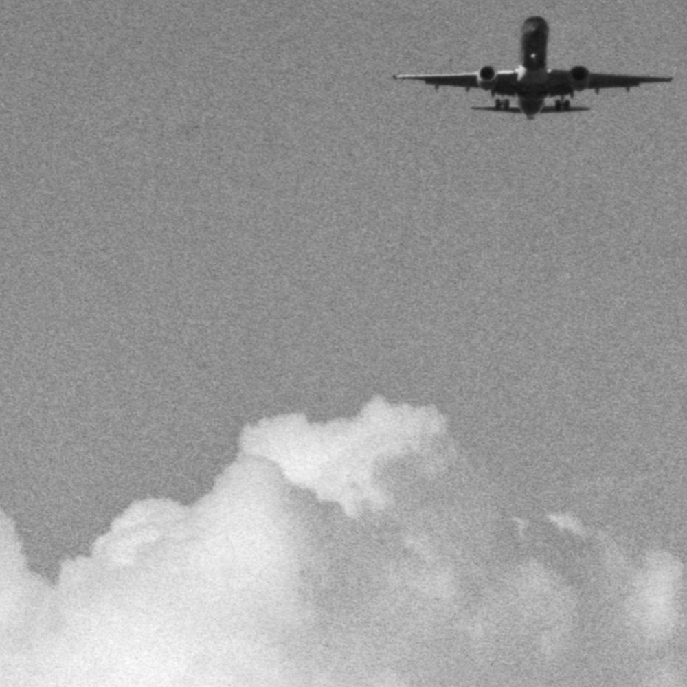

yeah, it does just look like a bit of grain to me. For a comparison, here's one that I did, FP4+ in Rodinal. I can't remember the dev but probably 1+100 1-hour {semi-}stand.
Fairly typical of the rest on the roll, and others too.
attachment.php
It's a 1000-pixel crop of a 3200dpi scan, so the area you can see is only about 9mm square from a 6x7 neg, ie it's only really noticeable at huge enlargements or pixel-peeping. I've got some 4x5 sheets that also look the same this close up, but when you look at the whole thing it's imperceptible.
You'd probably see it making >8x10 from a 135 neg though (but I've never shot this film/dev combo that small).

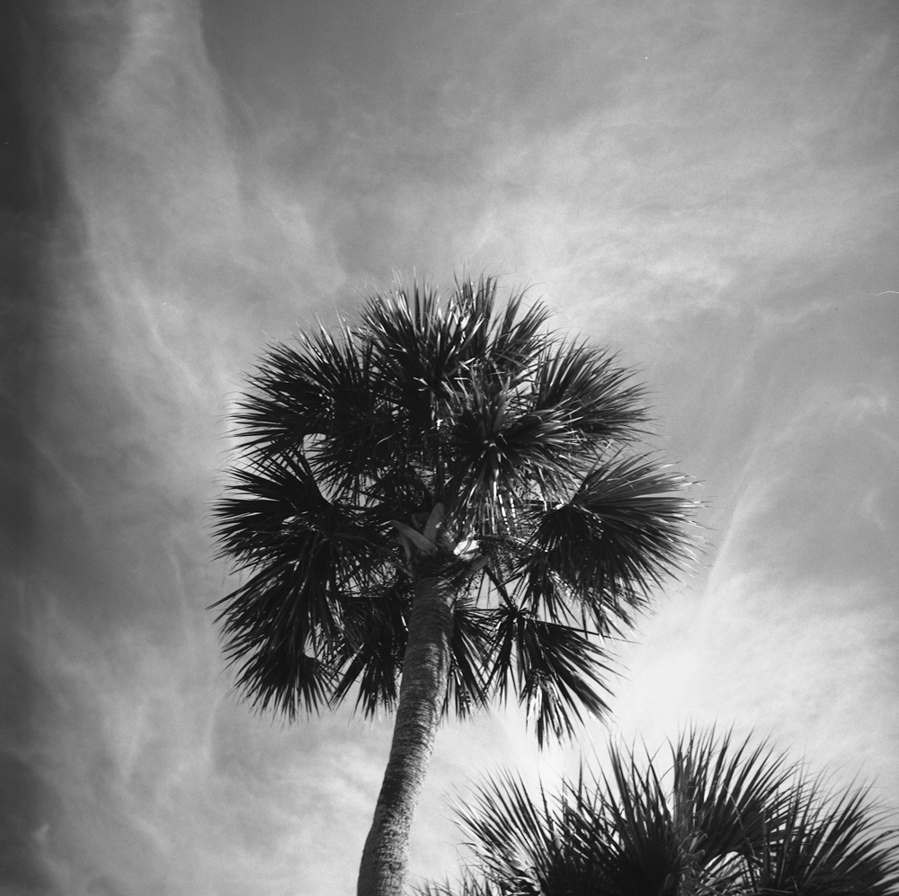

I submit it's an exposure and/or development/agitation issue. See pic below (neg scan) of a negative that was developed at 1:25 in Rodinal. This is what I expect from this developer....no apparent grain, unless you make it so. I also expect to see that light leak on the side unless I tape the back of the camera :}
This is from a 6x6 film, but even w/ 135mm the grain can be controlled quite nicely, depending on the film choice.
