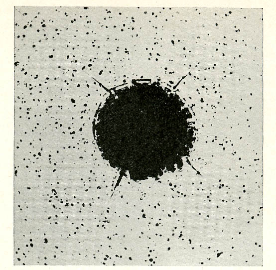

Photo #1, looking down at a small circular exposure showing what appear to be clumps around the edges (see comments above)

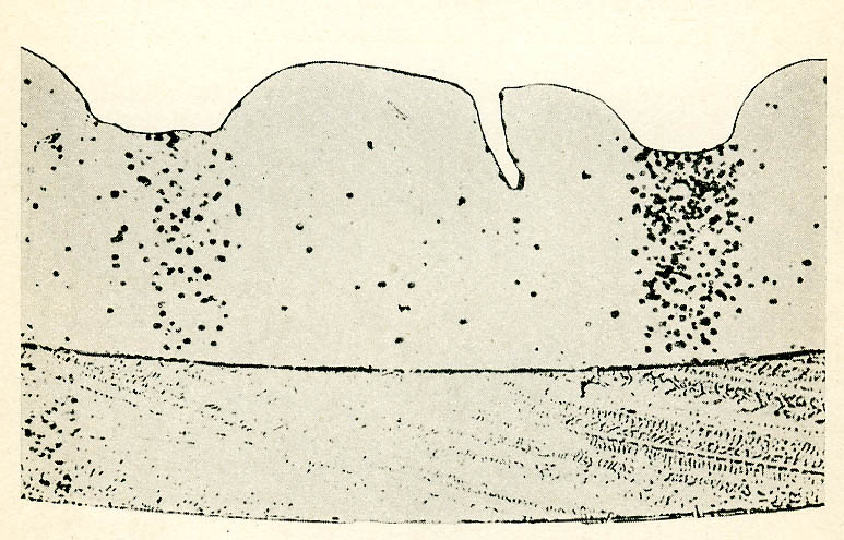

Photo #2, cross section of the same exposure using a tanning developer and showing the tanning effect in lower gelatin layer thickness.

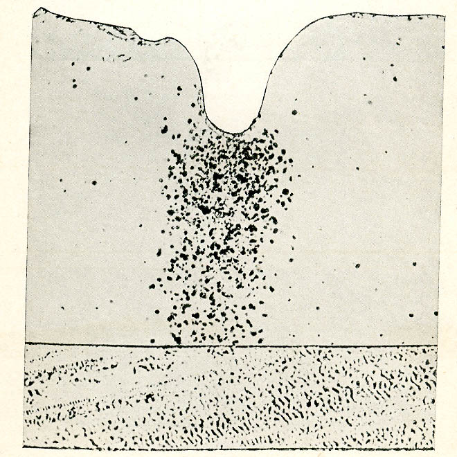

Photo #3, cross section of the same exposure using a non-tanning developer. The gelatin has expanded in this case.

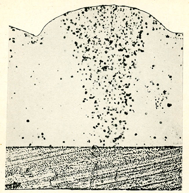

Photo #4, cross section showing two identical exposures processed in a tanning developer

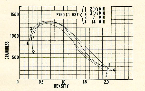

Bruce;
You have it correct! In fact, you lead into the next phase of this.
RMS = Root Mean Square and is usually said RMSG where G = Granularity.
Grain varies with type of development (high solvent, low solvent) and other factors such as pH as I mentioned above. Haist shows micrographs of several types of grain. I have yet to see an authoritative post on grain clumping or micro reticulation.
So, here is a plot of Grain vs Density. Note how grain varies with development time! This is how our eye fools us into thinking something has happened and the explanation is not correct. Grain even varies with development time at equivalent density.
It was mandatory to study the image structure on every coating I made. This included photo micrographs and electron micrographs, RMSG, etc.. I coated 10 coatings every other week, so in one year that was about 250 variants on a given film product. I've processed from 68F to 120F as well during these studies. I believe that the Ross paper expresses the true situation.
I have seen no definitive or authoritative references to the contrary. This is particularly true when as you say, and as Mark Antony says, it is a 3D effect. You need cross sections to prove the point.
PE
