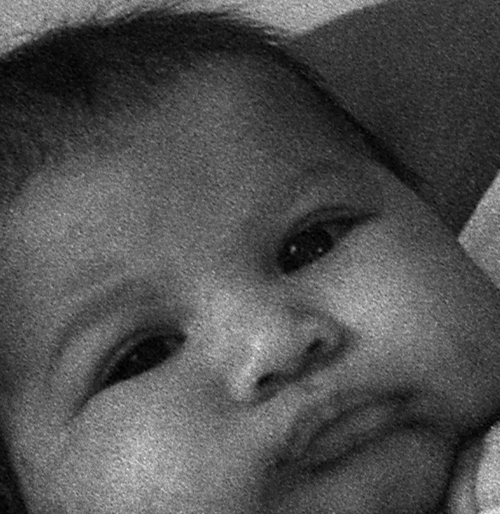

I bought Delta 3200 in 35mm, as the store was out of TMax3200, which I've used before. I thought they'd be pretty similar. I developed in Rodinal 1:50. The negs are grainier than my TMax3200 in Tmax developer ones. (I'm out of the TMax developer).
Is there a better developer? I know they'll be grainy, but a bit less would be nice.
Attached is a 1/5th and about 1/20th crop from a Delta 3200 neg.
Thanks everybody

There are many less grainy developers. Just about all of them, lol. XTOL would be a good fine-grain developer.

I can vouch for Delta 3200 in Xtol, even at 6400EI the results were good to my eye. Still grainy (35mm), but good. I haven't used Rodinal with anything faster than APX400, personally.

yes, that is what Rodinal does, specially fi you scan the negatives.... pop-corn-grain.
You'll see a lot less grain in real printing.
D76, Tmax, Xtol and DDX are way better. I settled with DDX and D3200, great results.

You are used to T-Max 3200 in T-Max developer, if I understood your post correctly. Rodinal is a more grainy developer, as you have discovered. Your pix will appear sharper at first glance and from a distance, but when you get close, you can see that the sharpness comes from the graininess.
At any rate, while Delta 3200 may be a little more grainy than T-Max 3200, I would say it is your change in developer that caused it, as opposed to the change in films. I have never really messed with the T-Max (just shot it once when Delta was not available), so I don't really know, but I have done tons of shooting - and testing - with Delta 3200. I have everything worked out with it in both Ilford HC and D-19. The best way to get crazy grain with it is via overexposure.
All this being said, your pix don't look that grainy to me. HP5 and Tri-X seem grainier than that in certain cases.
