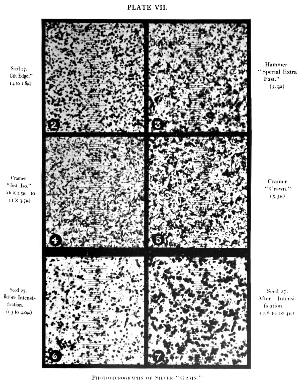

Film grain as detected by digital sensels introduces the issue about the optical detection of 'grain' vs the sensel spacing and resolution of the digital matrix.
Your EYE aided with high magnification optical inspection is a better means to evaluate 'graininess'
Abouit grain...
...characterized by some as "typically ranging from about 0.2 to 2.0 micrometers (µm) for standard films, but can be larger (up to 10 µm or more) in high-speed films and smaller in fine-grain, high-resolution films". There are 25400 micrometers in an inch vs. only 4000 digital dots by the CollScan 8000 in that same inch! At a certain point you will only 'see' the limits of the scan device.
