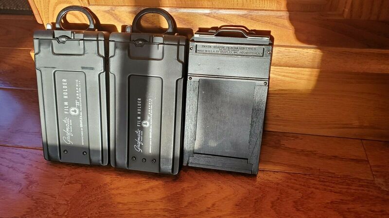

the Grafmatic 23 6 sheets holder is thicker than the regular 2 sheets holder. Can a Horseman VH/98x take it?

Yes. In addition, it can be clipped to the back of the camera like a roll film holder if desired after removing the ground glass back.

I want to buy a Horseman 980, but when taking pictures with movements, focus must be done the ground glass. Swapping focusing panel and roll film holder for each photo is a bit tedious. The rotary back seems nice but sets the focusing plane 25mm back. The Adapt-a-Roll 620 for 2x3 seem to be very uncommon. So I think the Grafmatic 23 will be a good compromise for speed and portability. I plan to cut sheets from 120 rolls.

Roll film is thinner than sheet film. I very likely will cause problems. Best is to cut sheets from 4x5 film.

anyway, I looked online, and only ebay had six listings, all fixed price around 100usd and one low starting auction, for these 2x3 Grafmatic. The 4x5 are many.
It was a while I didn't buy by auction. There were only two bids at 30 or 40 usd in that short-term auction duration. I did an ambush buy: jumped in the last 40s before ending with a 90usd bid, after 20s the 90 was outbid so I injected a 120, the other guy increased but not enough, I had a 150 ready to go, but didn't need, won at 107usd. Add 30usd for shipment and 40usd for norwegian vat, haha, so 177usd. But it is 2x Grafmatic 23 and one 2-sheets holder:
and still have not bought the camera+back+lenses combo... but at least have secured these Grafmatic 23. They will arrive after the camera anyway, as stuff from USA seem to need three to four weeks to arrive, but from Japan one week ...
