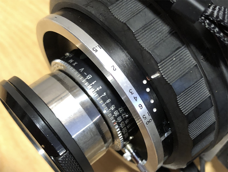

HI all,
I have a nice Graflex XL super wide with a Schneider 47mm Super Angulon f/8 lens. I recently obtained an even nicer Schneider 47mm Super Angulon f/5.6 in a much newer shutter. I am considering swapping out the f/8 with the f/5.6. After accommodating for the larger shutter opening (#00 vs. #0) and different infinity flange focus distance (47mm f/5.6 = 51.6mm, 47mm f/8 = 50.9mm), I am wondering if I can assume the focus scale will be the same. Anyone know? Here's a pic of the current focus scale.
Thanks,
Paul

Yes, a 47mm is a 47mm lens. It should be close enough although neither is exactly 47mm.

I've done exactly this, swapping in a f5.6 47mm SA in place of an f8 and it works fine. Focus is the same.

Thanks! Did you have to modify the chrome nose of the focus tube in order to mount the new lens?

Not sure about freeing the front plate - I assume you are referring to the plate with the shutter mounting hole and not the chrome nose . I noticed that there is a small set screw in the top surface of the aforementioned chrome nose, but I haven't tried to remove it.
Yes, the original 47mm f/8 which is currently mounted to the XLSW lens tube is in a Copal #00 and the "new" 47mm f/5.6 is in a Copal #0.

Thanks! It's encouraging that your mod was a simple drop in replacement. I will re-measure mine, it seemed to me the aperture and speed controls would hit the ID of the chrome part of the tube.

I don't have experience with the XLSW in particular. In general, the focus scale should be accurate enough for two lenses of the same nominal focal length - that is, two different 47mm lenses have the same extension past infinity. However, each example of a lens may have a slightly different focal length, so you should be prepared to test the infinity focus setting and shim the lens mount to set infinity focus at infinity on the scale, if necessary. That is, although the two lenses are spec'ed to have 0.7mm offset in flange to focal plane distance, you might find that offset to be slightly different in practice.

Sounds, good, Red - thank you. While the stated difference in flange focal distances for the two lenses is only .7mm, I assume a small shim will be necessary to lock in the infinity focus.
