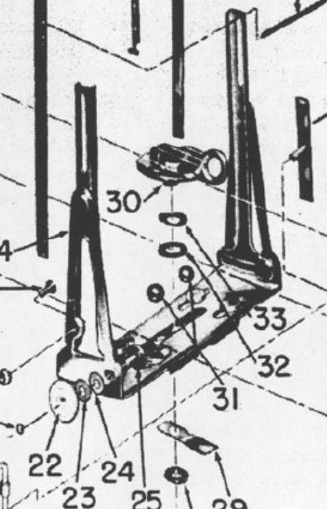

or download the full manual http://www.southbristolviews.com/pics/Graphic/manual-pdf/servicemanual.pdf

Thanks for the above.
I need to better understand the tightening operation (step 2). my mistake is working from the underside, and may be not seeing a screwhead on the lever, but working with the screwdriver slot on underside.
Need to revisit in daylight and fresh mind.
And also think about a small dab of Loctite blue(?) on there.
The copy of the manual I have is nowhere near as clear as the one linked above, great!

Use the screwdriver slot in the lever from the bottom of the standard, hold the screw via the slot when tightening the nut. The width of the slot turn will make the difference between the standard locking or not. Tightening the nut securely is usually sufficient to prevent the nut from coming loose.
