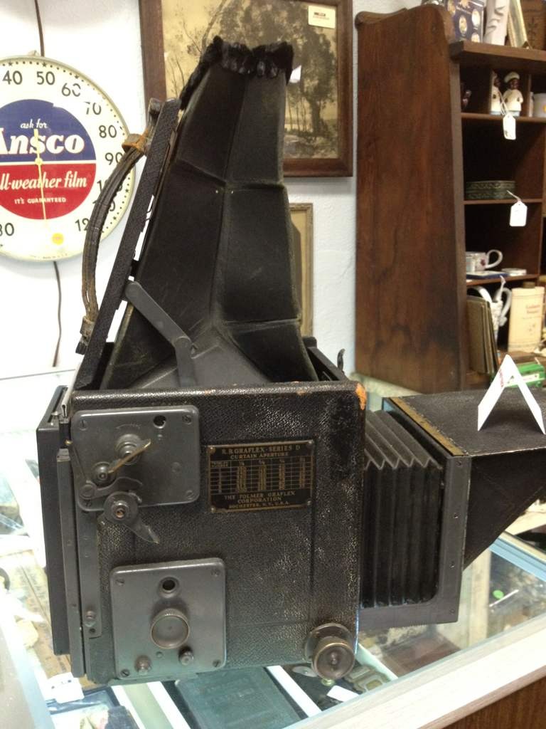

I went to a local antique shop, and they had this on the shelves. Apparently it was bought along with a hundred or so other cameras from a collectors estate. It has NOT been tested for working conditions. However I thought it looked like it was in fairly good condition.
It's priced at $350. I haven't bought it but I'm contemplating it.
I'm going to go do some research on it now, but I wanted to get some input from those of you who may have one or currently use one.

From the photos it appears that the lamb's wool on the viewfinder is intact. This camera was well cared for. I would bet most of the functions work.
Check to see what size film it takes. Series D was made in at least 4 different sizes.

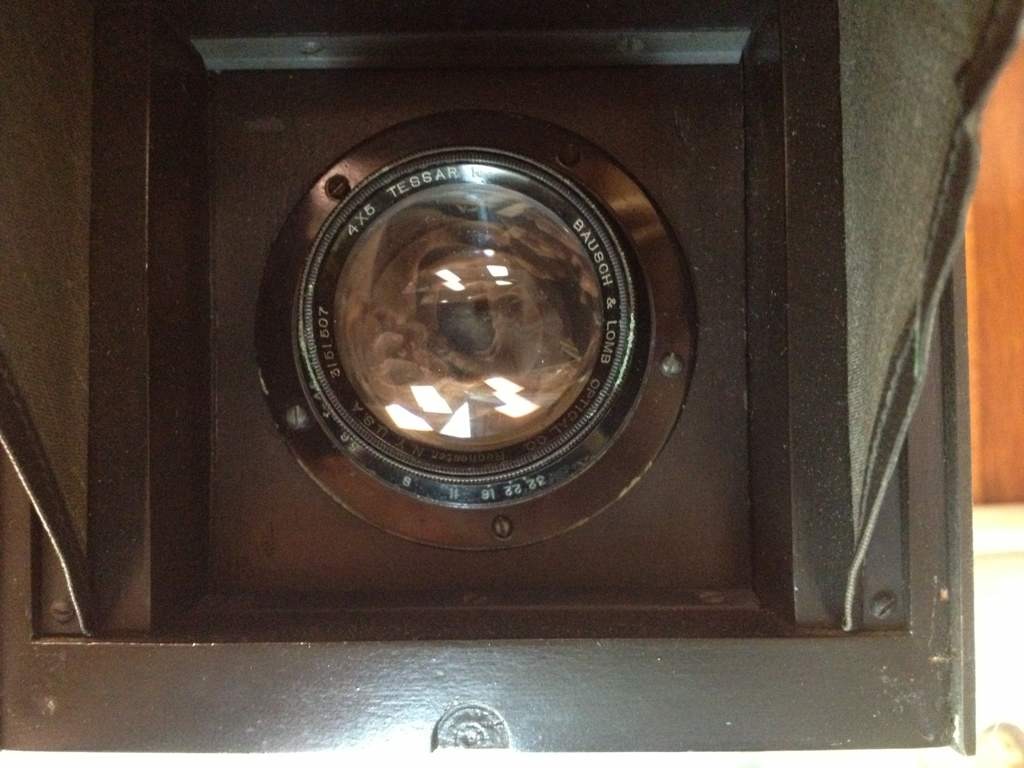

It's a 4x5 I think. The lens is a Tessar 4x5, or at least that's what it states...
How would I test the shutter? Should I test the shutter? I'm not a big fan of the you break you buy policy.
Are the expensive to repair?

That's an RB, (rotating back) series D Graflex. I had one, and they're a ball to use. The shutter curtain may be good, may not. It's about the only weak point. Better go to the Gaflex site for particulars, mine is long gone and I'll leave out some important step on setting the shutter speeds. Looks like the 3 1/4x4 1/4 version.

I shoot with these. I would just take a look at the shutter curtain, I wouldn't wind anything unless I was prepared to buy. Take the film pack holder off and look at the cloth. It is a rubberized material, if it seems smooth and flat and still flexible (as best as you can tell) then the camera probably can be made operational fairly easily. If the curtain seems dry and cracked, then I would walk away unless you want more of a project.

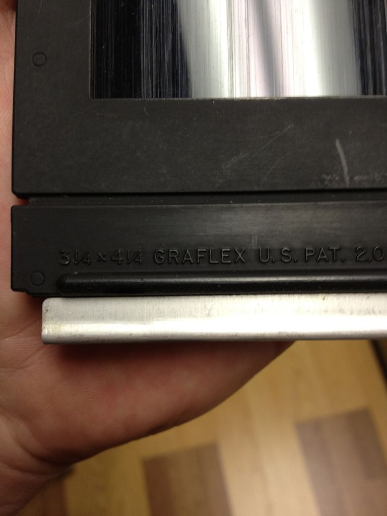

The lens says its a 4x5, what makes y'all believe this is a 3x4? Not that I don't trust you, I'm just curious so that I'll know for futures sake.
it could just be a larger lens the owner put on the camera
it wouldn't be hard to figure out what format it is, measure the opening
of the film pack ... or the back of the camera.
film holders for that type of graflex are bigger than "modern"
film holders, they are slotted. there are grafmatic backs, and bag magazines
that are made for that camera as well as adapt a roll roll film holders ...
if it is a 3x4 sometimes the film holders &c are difficult to find, 4x5, not so hard ...

It's hard to tell in a picture. Lenses get swapped around a lot on these, although it was common to have a slightly longer than normal lens mounted, I have a 4x5 that came with a "5x7" tessar on it, but that lens was a good bit older than the body. If you are familiar with both size cameras you can tell just by picking it up but the best way to tell is to measure the back or a holder. 3x4 is a nice size for hand holding, very easy to manage.

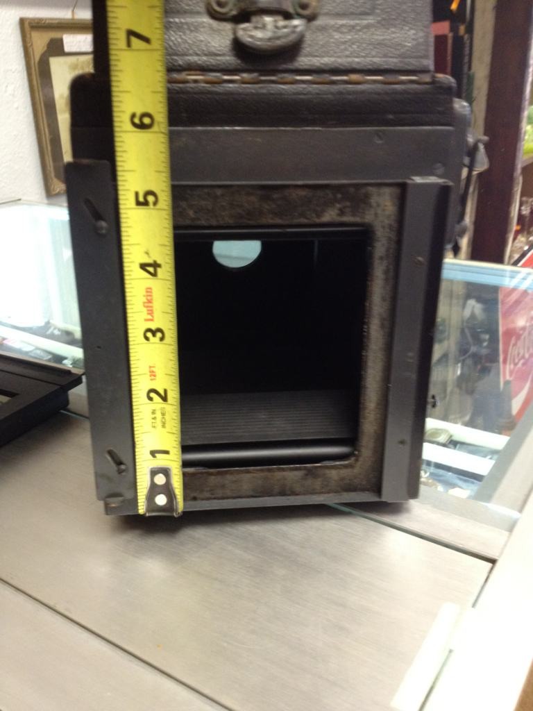

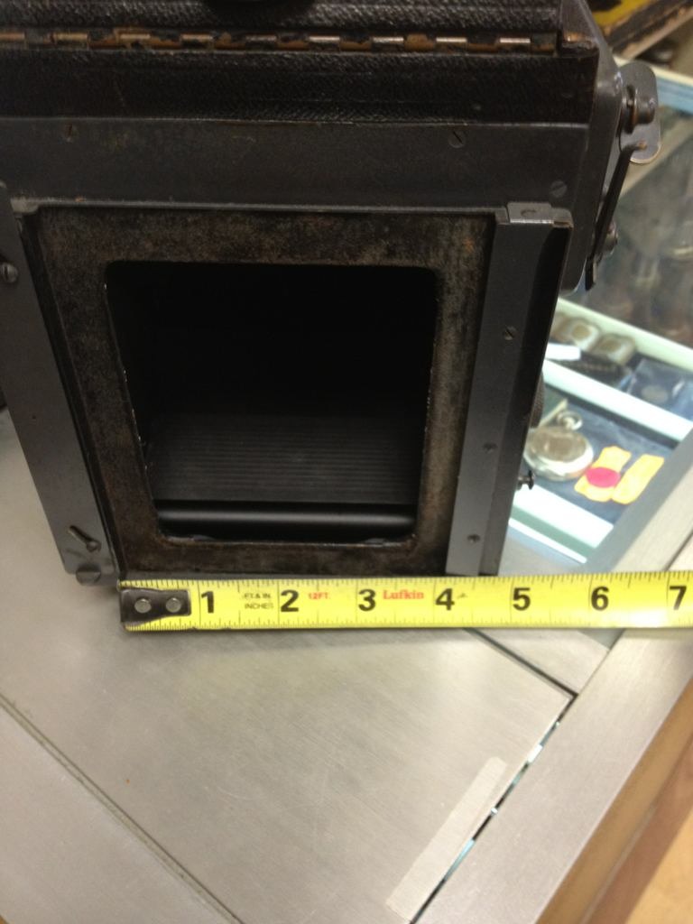

I'm back at the store. Sign on the door says "back in 10 minutes". I'm going to ask to take the back off and look at the curtain and also measure the opening.

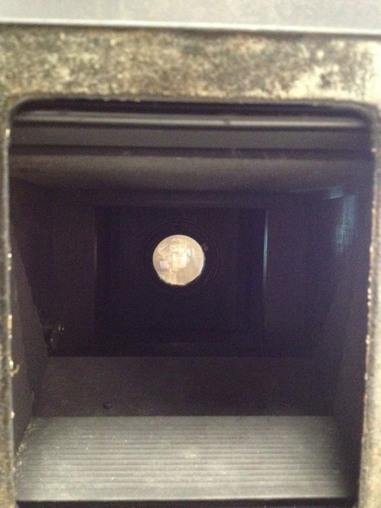

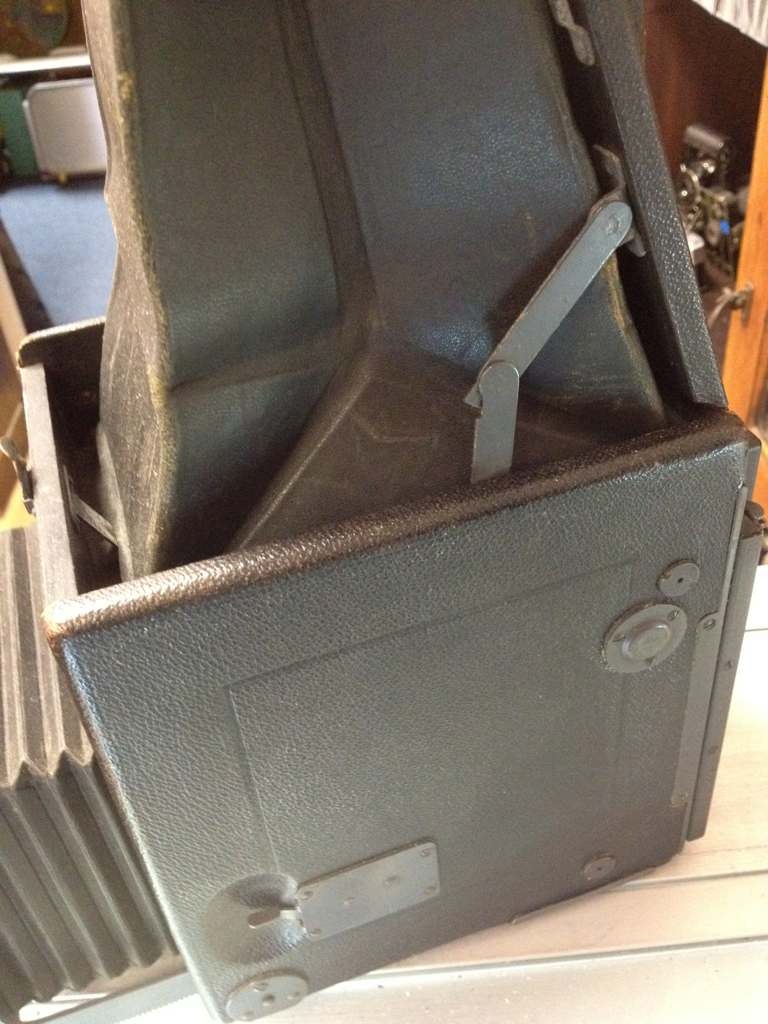

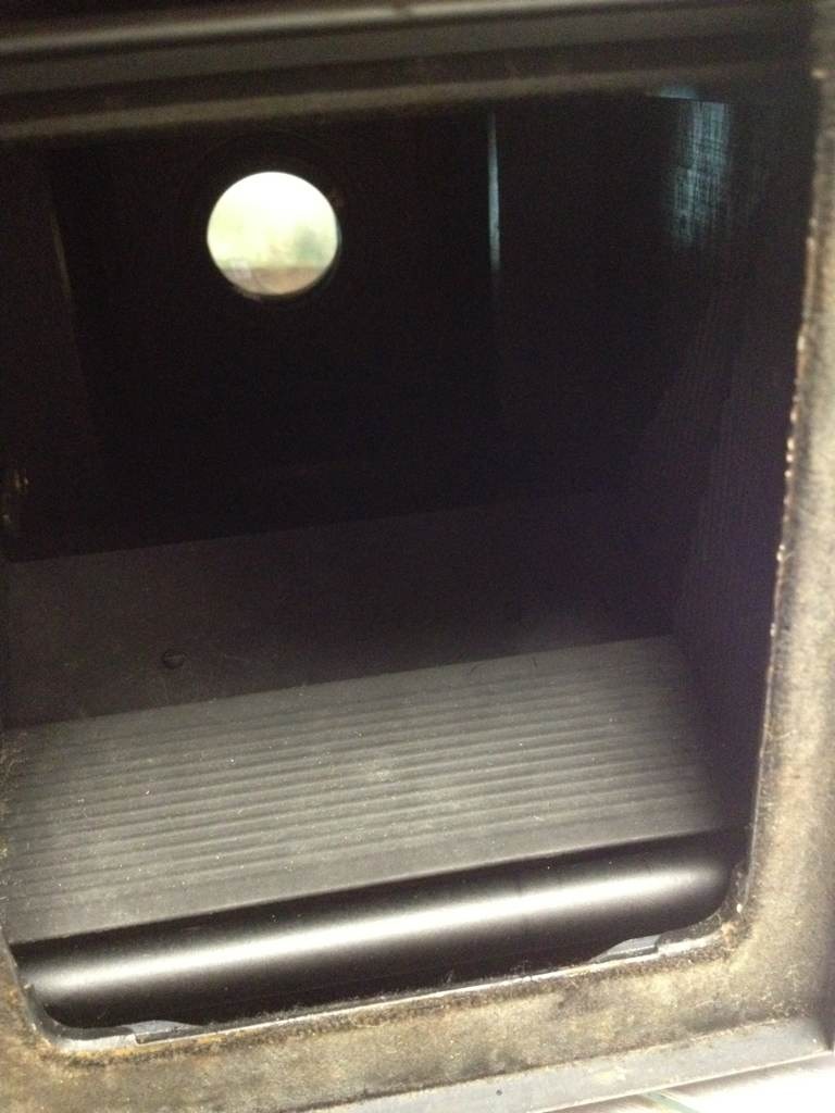

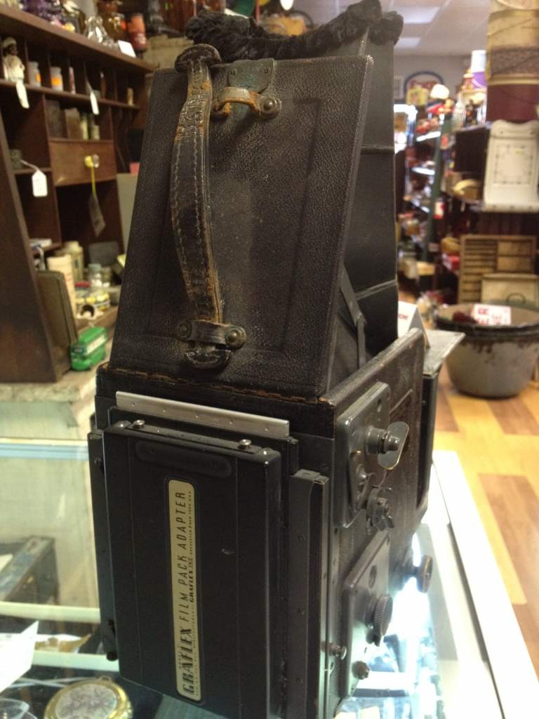

Ok, it's a 3x4. I took the back off and looked at it. He said I was welcome to "click" it, but I chose not to. Here are some more photos. It looks like it was stored with the mirror up.

I pass on 3x4's. If I knew that it was easy to adapt/obtain a roll film back for one I'd give them more serious consideration.

I was just going to say that it looks like Efke is the only one producing 3.25x4.25 film according to Freestyles website.
I know you have already figured it out but...
I have a 3x4 RB Series B and it's lens says 4x5.
I have also seen plenty of 4x5 Graflex SLRs that have a 5x7 lens.
Maybe it was common practice to put a lens one size up on these cameras.
