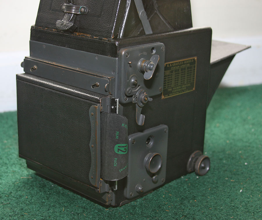

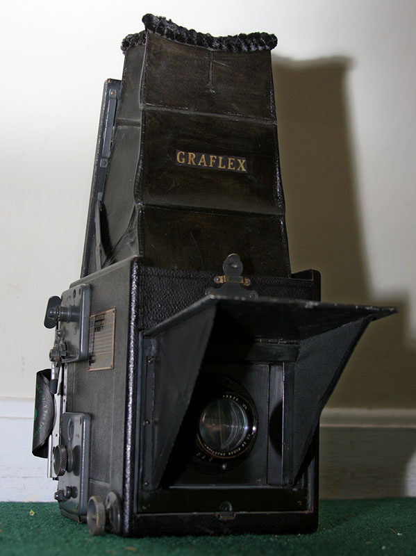

I just got this RB Series D yesterday. It's a 3x4 with rotating back. The clamping mechanism has one fixed bar and one that slides - looks sort of like the lensboard arrangement on a 4x5 Anniversary Speed Graphic. As can be seen, the camera came with a film pack adapter (obsolete I'm sure) with a few shots of Tri-X left in it.
First question - what are my options for using this camera? Will a roll film back such as would fit under a Graflok back work here?
Second question - any thoughts as to exposing the remaining shots and then processing the pack? I have D-76 or Tmax developer available and Ilford Fixer.

Just get some slotted film holders and cut down some 4x5 film. It's relatively easy to do. Forget the rollfilm backs if you can even find a model that fit's the camera. Even newer backs had film flatness issues. I own the Auto model, non RB and it takes time to get a hold of film holders but it can be done.
I personally wouldn't waste my time exposing the remaining film. I think old 400 speed film will fog badly. Btw, I use the pack adapter as a cover.

The rollfilm backs that are mounted to a 3x4 sized plate are quite rare, and command a premium unless you find someone who doesn't know what they're selling. You can adapt the packfilm holders to act as single-sided film holders, and since packfilm is for all intents and purposes extinct, you can pick up the packfilm holders on the cheap - cheaper than the double-sided film holders with the grooves. The last alternative is to find yourself a 12-shot bag mag with septums in good shape.

I suppose it should have been obvious to me that if a holder to fit a spring back wouldn't work in a Graflex back, neither would a roll film holder. Issue of whether the film plane is even in the right place aside, the holder is too long (although I'm not sure if that matters) but also too short in height - I would need to see if I could rig something up to extend it so it will run under the slides (or if I can build some kind of clamp to come out and grab the edges where they are). I'm going to think about it for a day or two and then maybe just use it with sheet holders and efke film from freestyle.
