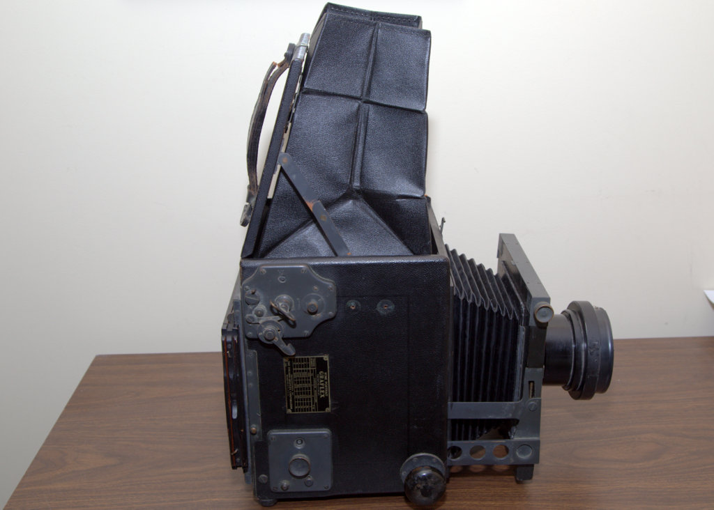

these are the2 cameras from your friend's grandfather ?
does the home portrait have a film magazine or film holders ?
look at graflex.org to see what the bag magazines and film holders look like
the magazines are big, and have a leather top to them,
inside there should be 8 or 12 metal septums that hold the film
the film holders have slots on the sides. the tele is a nice camera,
it has a huge bellows draw compared to a regular old series d, so you could
use longer lenses on it, probably some of the same FL you would use on the 5x7 model
i mention these things because if you have the chance to rummage through the camera stuff
you might find them ... if you have to buy them off of ebay or the classifides section of a website like
this, or largeformat photo.info, good luck they are never sold ( almost never ) without the camera.
david goldfarb, one of the moderators here has and uses a home portrait, maybe if he sees this thread
he can chime in on how nice it is to use. the regular 4x5 series D is a dream to use, perfectly weighted.
the good folks at graflex knew what they were doing !

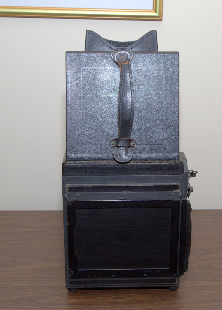

The Home Portrait is a cool camera, but you will have a very hard time finding one, and it's huge. A 4x5 Series D is actually a hand camera of sorts, and it's much easier to find both the camera and the bits for it, and film, as well. Developing won't be a problem, but printing will be. Contact 5x7s are almost viable; 4x5 contacts are a bit small for most people. If you really want to get into this, you should wander over to http://www.largeformatphotography.info/ and cruise around there, including the forum. Another site you need to read everything on is http://graflex.org
Many of us who are using large cameras are shooting xray film. It's dirt cheap-- about 40 cents per 8x10-- and you can cut it down and develop it under a red safe light. I shoot all sizes, 4x5, 5x7, and 8x10 on xray film, then scan for printing. If you really want to do the darkroom route, huge enlargers are often given away if you happen to hang with the right crowd--there's no demand at all for them these days. Once you get into the LF world, you'll find we're all over the place, but you don't see us. There might be someone living right next to you, but you'll never find out because you haven't completed your profile to tell us where you live. :-(
"Curtain aperture" is not a model--it's written on the shutter speed chart to indicate a shutter parameter, but ignorant Ebay sellers fix on that line because it's the only thing written on the camera. It's like calling a car "E" because that's what it says on the fuel gauge.

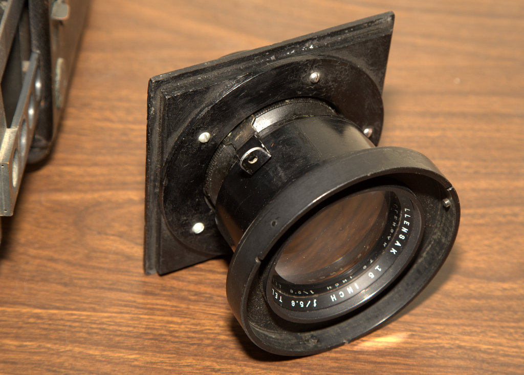

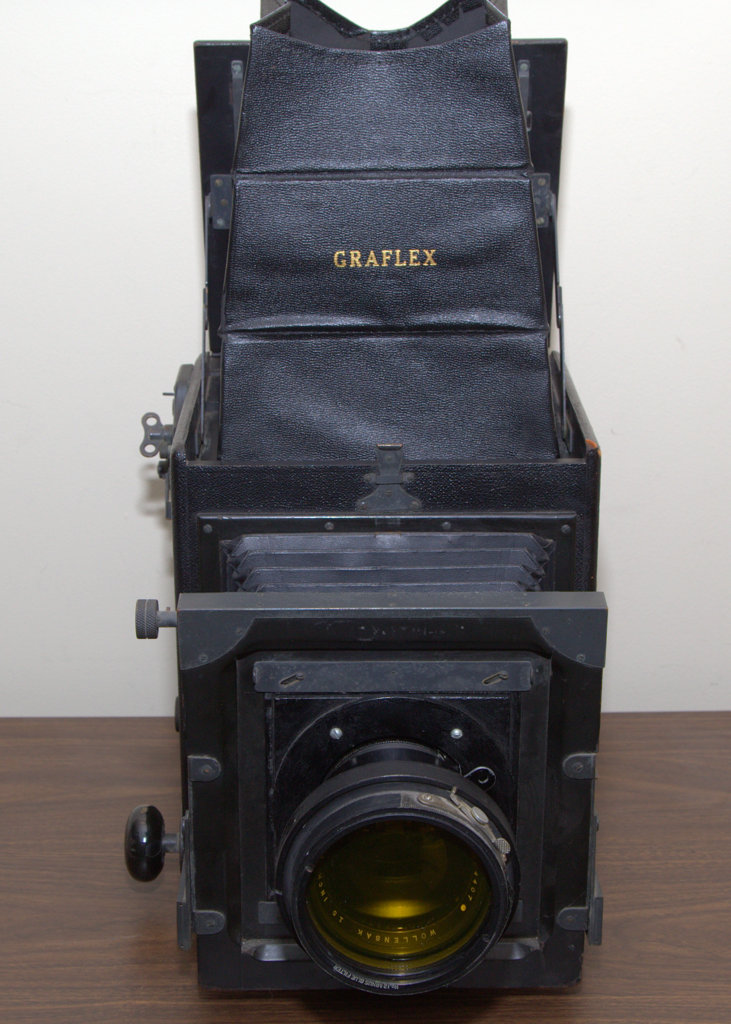

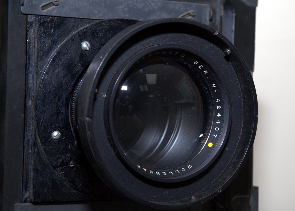

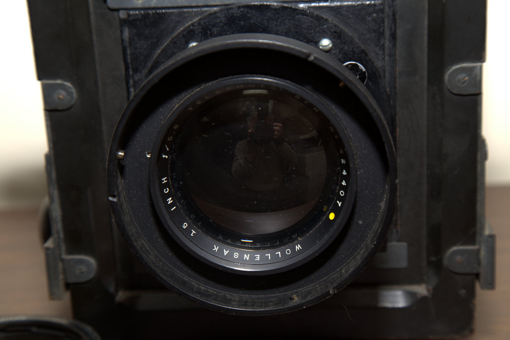

Here is the 5X7 camera and it comes with I think 3 or 4 holders.

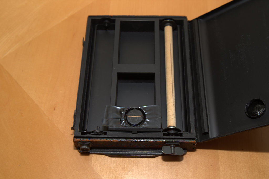

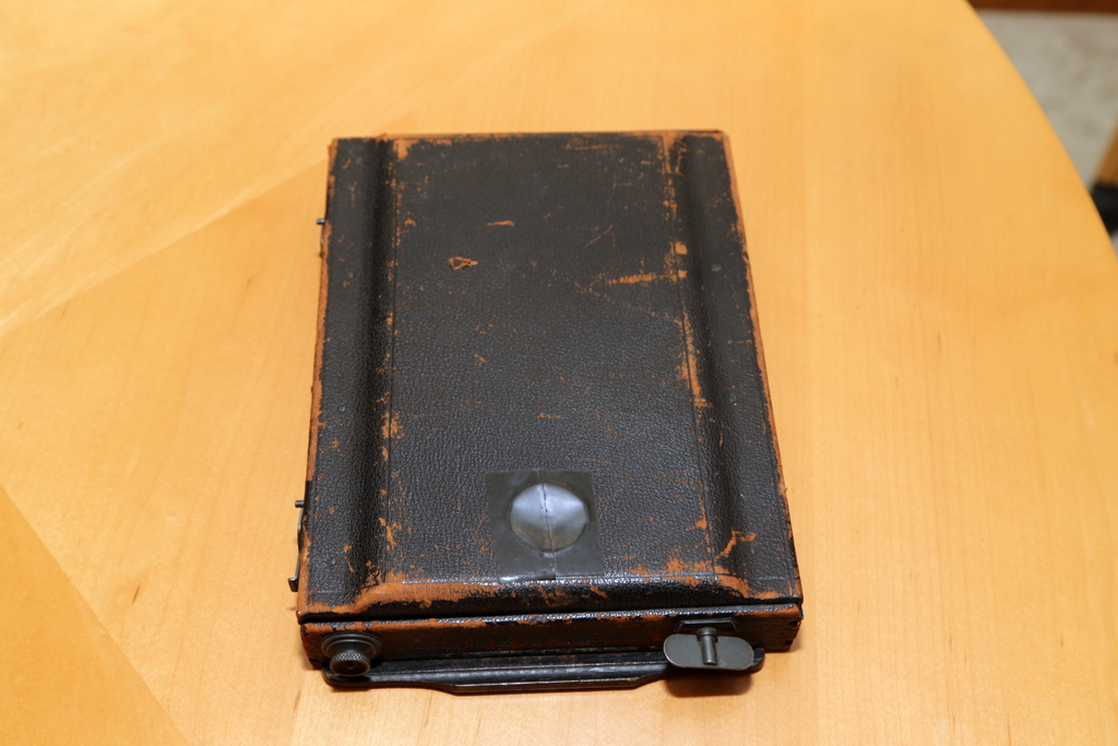

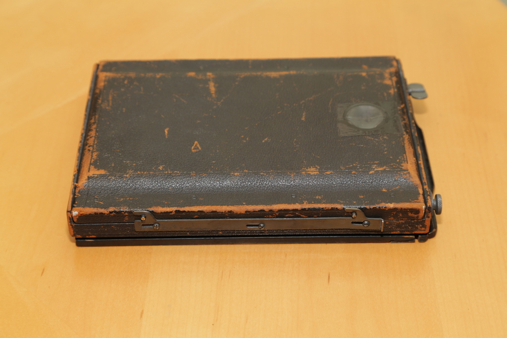

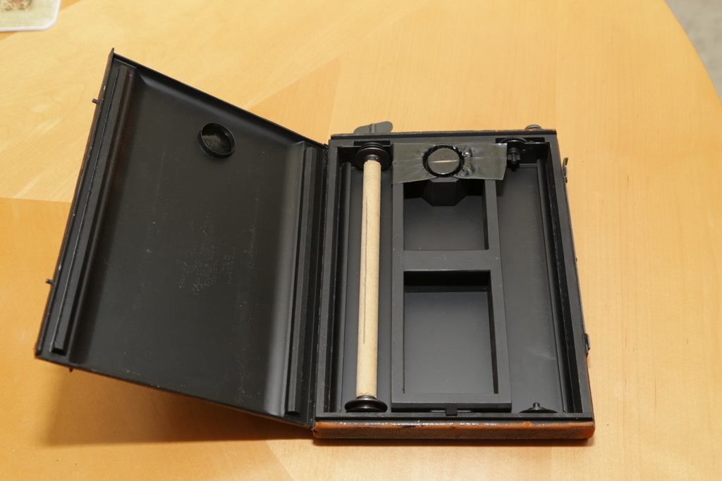

Here are some pictures of the 5x7 roll film holder. Is this a rare item?

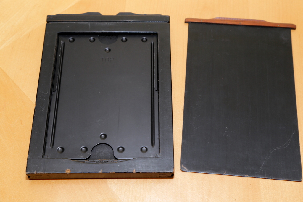

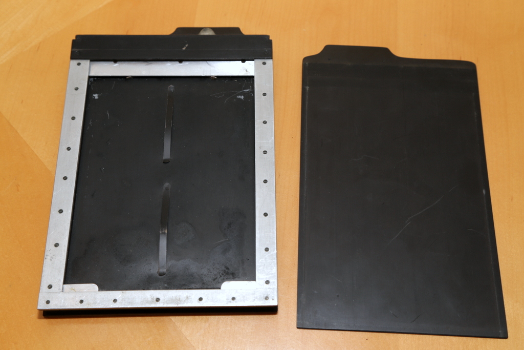

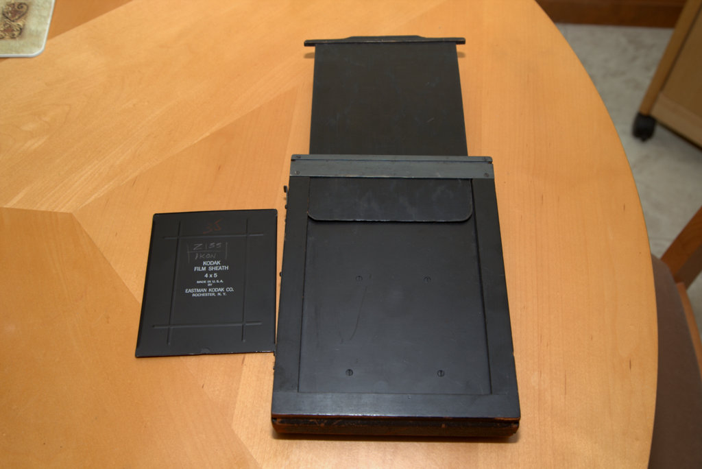

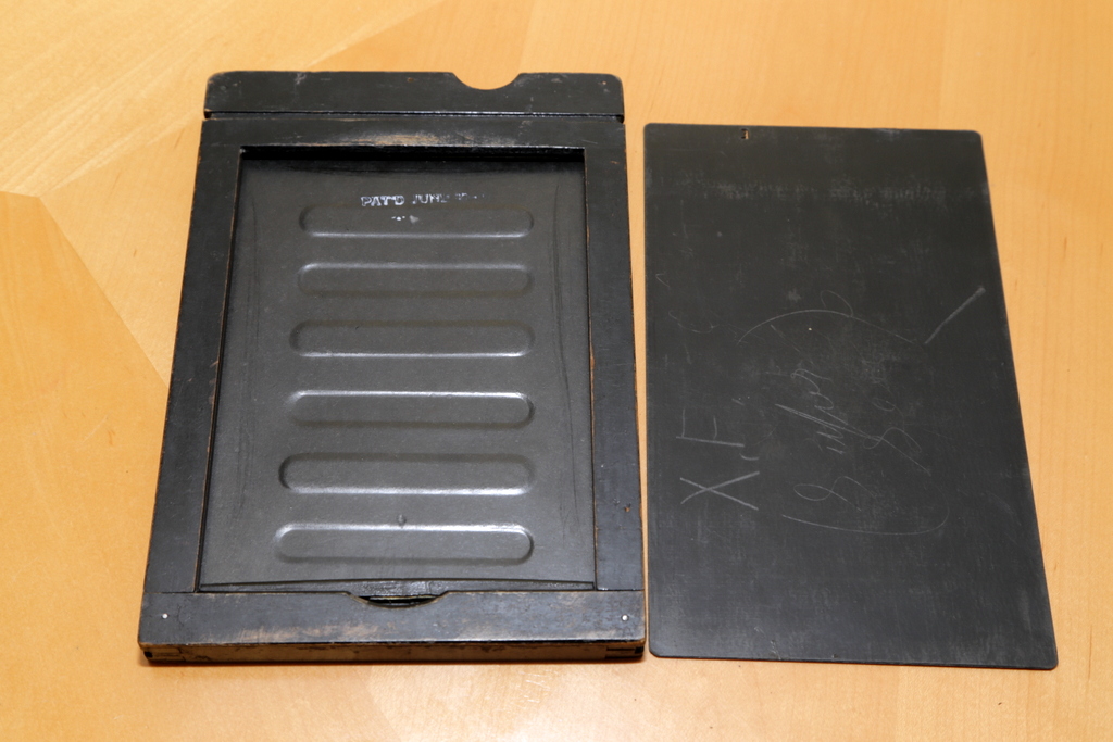

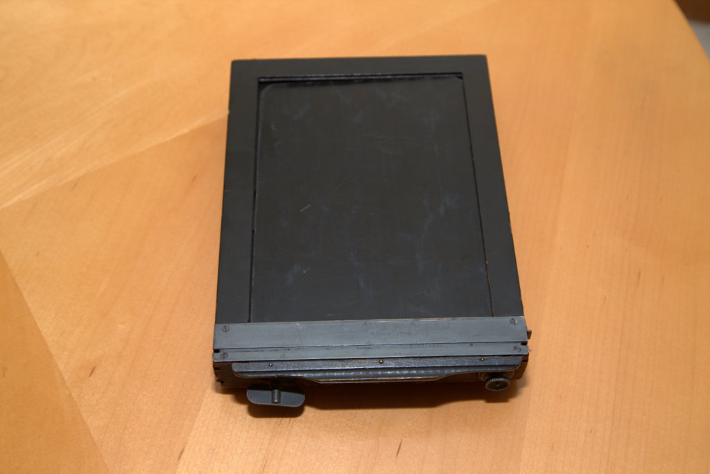

Here are some pictures of the 5x7 holders. Are these for plates and not film?

Post #20- 112 roll film holder. The Wiki link in post #18 shows 112 roll film was discontinued in 1924. It can be modified to take 120 film or its a nice collectors item.
Post #21- images 2270 and 2271 are plate holder(s) with film sheaths, image 2272 is a plate holder without a film sheath.

So I can put film in 2270 and 2271? Are there any special instructions I need to know?
