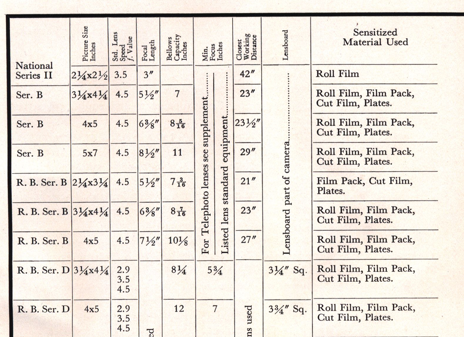

According to Graphic Graflex Photography, 8th edition, the focal length of the standard issue lens for the 3x4 RB Ser. B is 6 3/8" (162 mm). This is probably the shortest focal length that can be used at infinity with the camera; a shorter lens will require less extension than a 162 and its rear cell with interfere with the mirror. Longer lenses, up to at least 12" (305 mm) telephotos, can be used on the camera.

Because of the mirror box, you cannot use any lens shorter than 150mm. The bellows draw are limited, so any lenses longer than 210mm might not work in portrait mode (but infinity should be ok). 180mm is actually pretty sweet on this camera.

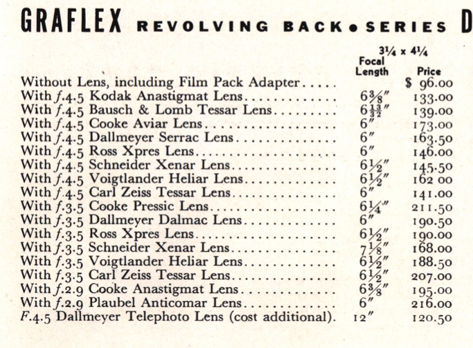

Series D 3x4 uses a Graflex "A" interchangeable lens board 3 1/4" square.
The 180mm Xenar was an original factory option for this camera (7 1/8" f/3.5) and was one of the premium options over the stock 6 3/8" Kodak Anastigmat. So I definitely wouldn't say it's too long for the format. FWIW, it's the approximate equivalent of a 62mm lens on 35mm.

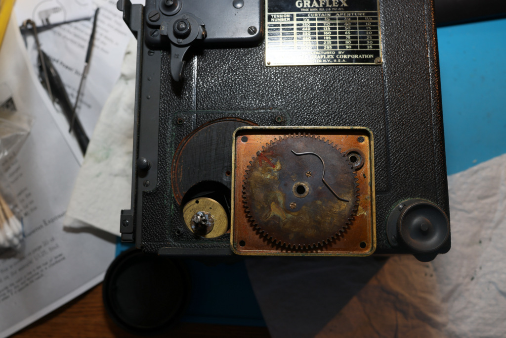

I received the camera and cosmetically it looks really nice, but I committed the number one sin in repairing and jumped right in instead of doing more searching. I was having a problem of not being able to change the tension knob past 1 so I took the plate off after seeing a video that already had the plate off and got the impression that the 4 screws come out and you lift it off. When I did that I think the gear and shaft on the other end may have pulled out and is not sitting in properly on the other side. I also noticed that on the tip of one of the gear has broken off. Where do I go from here? Do I need a new gear?

It's a bit difficult to tell from the picture, but if you're referring to the larger gear on the mechanism plate, it's supposed to have two of the gear teeth that are bent together and then crimped or soldered. This is what creates the stop that prevents the gear from turning a full 360 and allowing you to wind past the heaviest (6) tension or unwind the shutter all the way past the lowest (1) tension.
With the plate removed, you do now need to reset the shutter tension though. This isn't too difficult, there's only one adjustment to make, you need to increase the tension on that gear until the shutter just closes on the lowest tension and curtain aperture (from "O" to blank on the upper dial).
Here's a video on it:

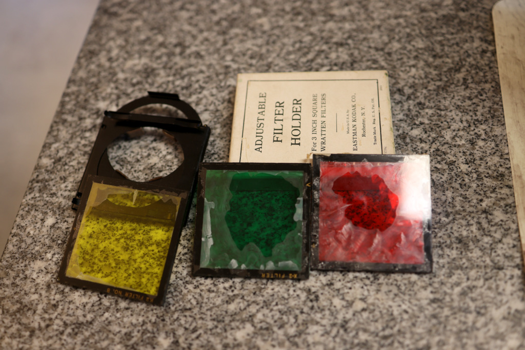

It also came with this filter holder and filters. Do these filters have separation and can they be fixed?

Looks like the yellow and maybe the green will work with a small diameter lens. The red looks dead. All of them will be prone to flaring due to the deterioration. In other words, try them but they're probably no good.
Old filters are generally pretty bad.
