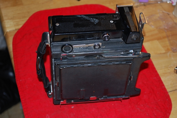

I was perusing the local Craig's List and ran across a listing for "An old camera $10.00". I looked at the photo and it was a Graflex 4x5" press camera though I couldn't tell what model from the photo. I called the guy and went over and bought it. It appears to be a Crown Graphic I think because it does not have the focal plane shutter but does have the rangefinder and a Graf-lok back. Someone closed the camera before the lens and rails were in the right position and now the rear rails are slightly higher than the front rails and the focus won't work. There is a little rod that sticks out on the bottom lower left of the body near the lens that appears to be bent.
My questions:
1. How do you remove the graf-lok back? I have slid both rails on the back to the unlock position but nothing seems to come loose.
2. Is this a Crown Graphic? I thought those did not come with the Graf-lok back. At least my other Graflex which was sold to me as a Crown model did not have it.
This camera did not come with a lens but I have a 135 mm for it with the other camera. This body is in much better shape and I would like to get this one back into working order.
Any suggestions would be appreciated.

Moving the slide locks on the back should let you remove the ground glass focusing plane and the viewing hood, not the Graflok back. There are two screws; one top center and one bottom center. Removing these two screws will allow you to remove the Graflok back, which is basically a frame with quick releases to allow easy swapping of sheet film back and roll film adapters.
If there is no focal plane shutter it is almost certainly a Crown, unless it is a Super Seed Graphic. You have a top mounted rangefinder so that's a possibility. The top slide lock for the lens board should say Crown Graphic or Speed Graphic. Try this link for a pretty good explanation of the different backs. http://www.xs4all.nl/~lommen9/holders/index.html
Good luck with the rails. Tuscon should have a camera shop that has someone familiar with press cameras.

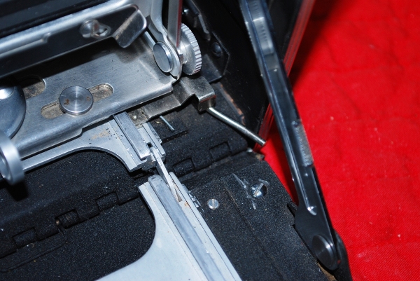

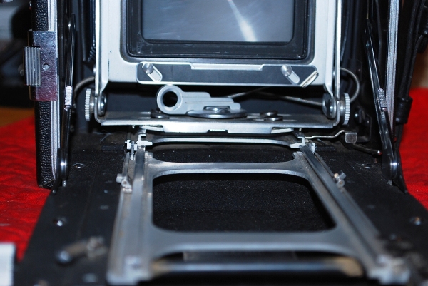

After a closer look I can see what the problem is clearly. It is as I thought. Someone tried to close the front panel when the focus rail was not in the "close" position. This bent the rear left in body rail and to some degree the right one up about a 1/16th of and inch. The front moving rails are connected to the rear by a link on each side and with the rear rails pushed up as they are this freezes the front moving rail. I think what I am going to do is use the focus rail system from my other Crown Graphic on this body which is in much better shape. The push rod for the rangefinder system is also bent. If I can successfully straighten it then I think the rangefinder will works as well. Considering it's age this camera body is in very good shape.

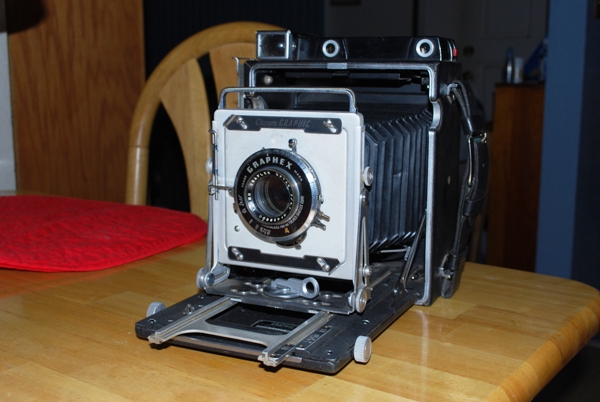

Well it's done. I swapped the focus rails from my other Crown Graphic (which was in horrible shape and was much older than this one) and it now racks out and focuses as it should. The rangefinder actuator was too bent to slide back into its metal sleeve so I'll have to use the infinity stop and ground glass for focus. No matter. This one is in much better shape than the other and has the original covering on it. My other had been stripped by a previous owner to attempt a "Natural Wood finish" with so so results. This one looks like a press camera should. I'll test it out this week.
Thanks for all the suggestions.

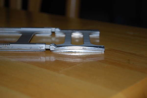

I took a picture of the focus rail I removed from the body. As you can see it got severely strained when the camera was closed improperly.
Thankfully the removal and replacement of the rail system was pretty straight forward and I finished it last night. I hope to do some shooting this week to see how it does.
Thanks for all the suggestions and links.
Did the rear guide blocks survive the abuse? If so, I think I have an extra set of rails. PM or e-mail me if you want them.
No the rear guide blocks were pretty well thrashed. I used the rails and rear blocks off my other Crown Graphic which was a perfect use for it. Now I've got a fairly new bellows and front lens mount and some other body parts that I really don't need. What I would like to get is the rangefinder link that looks like a tube that snakes around from the bottom of the right side facing the camera and links up with the rangefinder assembly on top. The plunger on the one in the camera has been bent almost to a right angle. I tried last night but I don't think that one is coming back. Or if the plunger and cable assembly can be replaced inside the tube then that. I would love to get the rangefinder working again.

I don't think you can see it clearly in the photo's but the thin upper side of the "slot" which the lens frame base slides into normally has been ripped away cleanly from the rear rail section when the rail was bent in the original "event". Even if the rear rail section was bent back into shape it's still missing the upper side of what keeps it in alignment and in position.
Correction: It's not the rear rail which was stripped but the mounting plate the rear rail rides in. There is an upper lip under which the rail is supposed to slide. When the camera was forced closed the rail lifted and both bent as seen in the photo and ripped the thin upper lip clean off both rail mounts. I could probably bend the rail section pretty close to straight but pretty close won't work in the assembly. It's got to be straight or the lens mount will bind on it.
I guess the front section could be salvaged but the rear section is history.

I've never seen the rails get mangled that badly. usually it's the rear blocks that get chewed up. I have an extra set of rails from a top-RF Speed - they're fine. The tiny groove in the rear blocks was completely trashed - the top lip just peeled away. It's the inevitable result of someone trying to close a Speed/Crown without racking the rails back fully. And, it renders the camera mostly unusable (unless you're patient enough to deal with the rails coming untracked every time you open and close the camera).
