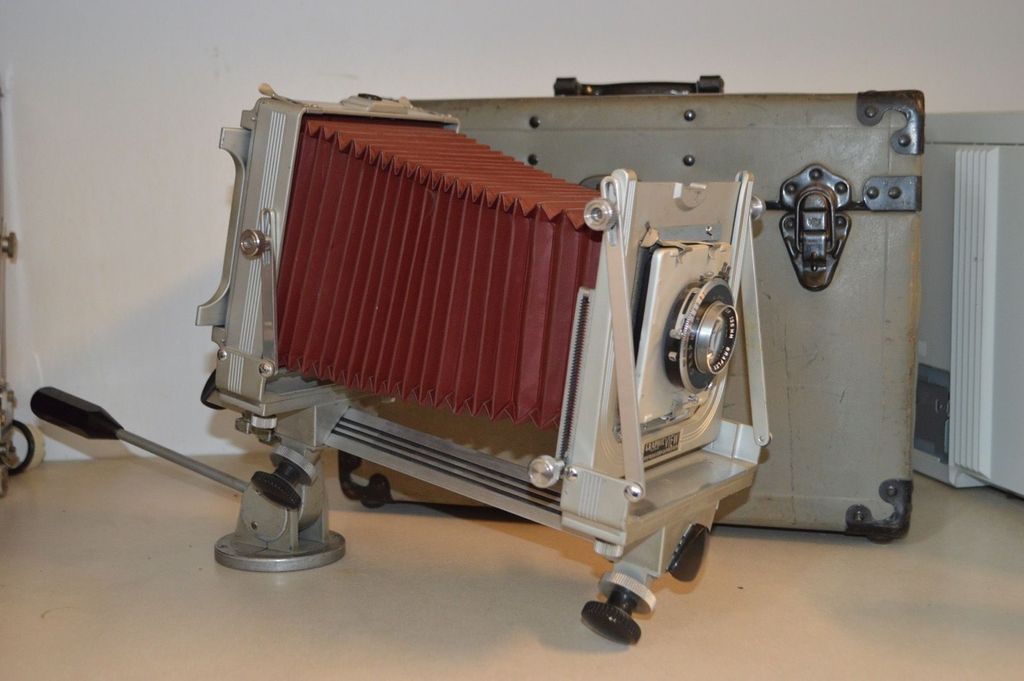

Here is the picture of the camera I got. To me it looks like it is using the Speed Graphic board, so I'm guessing the adapter is already mounted on the camera? After a few responses I may just keep my Speed Graphic. People have mentioned carrying around the View Graphic with a tripod can be cumbersome. I do have the case with this.
That lens board adapter looks really cobbled together. I can't believe it came from Graflex!
yes ! that adapter is what you want. speed graphic boards have a nice small profile. that adapter makes it easy if you keep both cameras ( as long as your speed is the same vintage )
the camera looks like it is missing the knerled knob for the compendium hood, no big deal ... do the other photographs of the camera show if it had the tripod mount/bracket ? some had a tilting head, some didn't and some brackets go missing altogether. its great you got the case with it, they are extremely handy.

Your Graphic View http://www.graflex.org/articles/graphic-view/ has a Factory lens board adapter on it. The adapter is not fully closed at the top.
http://www.southbristolviews.com/pics/Graphic/manual-pdf/GVII-Instruct2.pdf
http://www.southbristolviews.com/pics/Graphic/manual-pdf/GraphicView2Service.pdf
http://www.cameraeccentric.com/html/info/kodak_4.html
The Ektar 127 was designed for 3x4 and just covers 4x5 with soft corners and no movements. How sharp a vintage lens is today depends on how close to nominal it was when manufactured and how it has been treated since.

I've shot the 127 on a 4x5 Graphic View I, it will cover at f16 with sharp corners but very little movements.

The missing screw is only needed if you use the compendium hood. No big deal
It's an american thread so if you want something later wander down the the local Ace hardware
& look for a thumbscrew.
The case is OK for storage & maybe using in the car to keep the camera from bouncing around other than that it's close to ten pounds

Yeah I saw it was missing the focussing hood. I have one on my Speed Graphic and I was debating to swap it on, but I think I'll just look for a used parts sale. I can use a dark towel in the mean time. Is it easy to screw on the stock hood? It doesn't look like it would be easy to do that. This camera does come with the tripod mount, so I'm good there. I wouldn't be able to use the camera otherwise.
