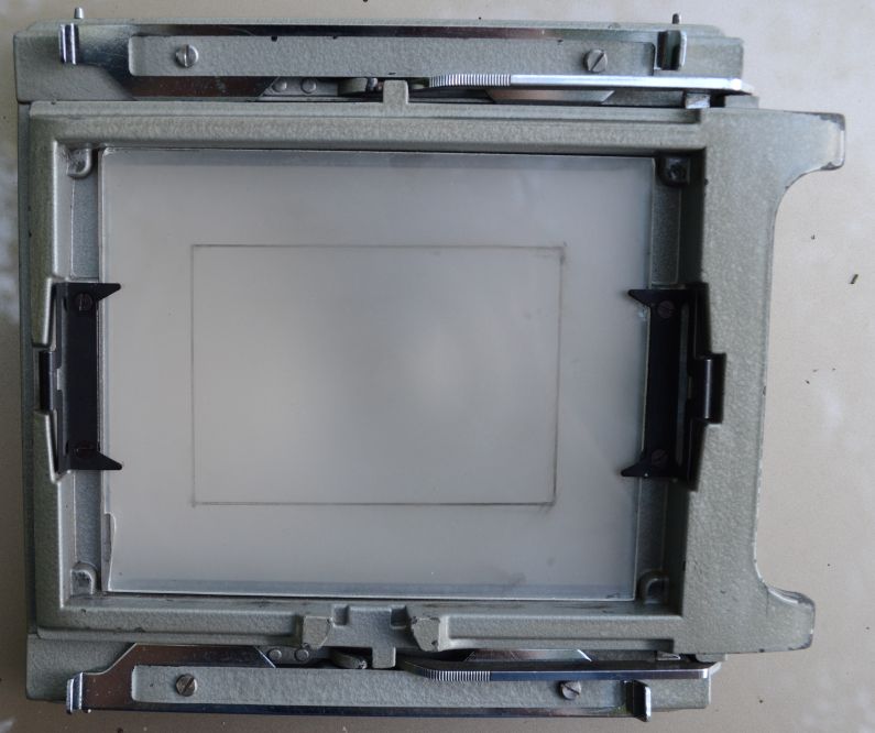

Hello,
I would like to replace the GG on the Graflex graphic view I just bought.
As you can see on the picture I think the ground glass on it is not original and it is
Not held by screws. Could I see some pictures of graphic view owners
Of your graphic view cameras back to see how it is supposed to be ?
Thank you !
Henk

If you go on ebay and do a search you can find some pictures. The ground glass is held in place with a metal frame that has a door and hood attached. Your ground glass looks too small. As you may know it is important that the ground glass plane be positioned correctly (equal to the film holder film position) so that photos will be in focus.

Go ask at www.graflex.org. I could be mistaken, but I don't think the focusing panel is original issue for a Graflok back made by Graflex. I take it you have a GV II.

Jon describes the Graphic back typically supplied with the first model of the Graphic View. Yours appears to be the Graflok back that was common on the Graphic View II camera. The two backs are interchangeable. The two clips that originally held the ground glass (and perhaps a fresnel lens) have been replaced on your camera with something else. These clips also retained the snap-off hood. If the ground glass frame was built for the fresnel lens, a proper fresnel lens must be mounted in front of the ground glass for correct focusing. If the frame was built for no fresnel lens, no fresnel lens should be used for the same reason. In this instance, the front surface of the ground glass should be about .190 inches from the surface of its frame that rides against the film holder. On my camera, the fresnel is about .150 inches from the surface of the frame.

My Pacemaker Speed and Graphic View II (w/spring back) both have the same clips Jim shows above.
It looks like someone made those on the OP's camera...but you knew that.

Thanks for the answers !
I am new to 4x5 hence my following question(s) :
In comparison to Jim's picture I see that my gg is positioned OK.
For the focussing, since the gg is in a graflok back, the position
is automatically OK right ? Or does the thickness off the gg must be correct as well ?
Could I replace the gg with a gg of a different vendor that has graflok backs,
say for example shen-hao, chamonix... or has it to be customed made ?
As for lenses are lensboards for this camera still used (easely available ?).
(If I wanted to buy another lens)
By the way I bought the camera for 150$, with a graflex 135 f4.7 on it.
The only thing in not so good shape is the gg, the rest seems very ok.
Thanks again,
Henk

The film holder slips under the GG back and the film will be where the GG was so focusing shouldn't be a problem.
The Graflok back takes a slightly smaller GG than most backs so it is important to get one that fits properly. Specify that you have a Graflok on a Graphic View.
Lens boards are a standard size, I believe 4"x4", and are readily available or one can be made quite cheaply.

Henk, the thickness of the ground glass is unimportant. Only the position of the surface towards the lens is critical, and that is determined by the frame and by the existance or absence of a fresnel lens. Accurately measuring the diminsion given earlier will show if a fresnel was originally used. If a fresnel was used, the ground glass can still be used without a fresnel by shimming it back about .040". Not all fresnels have the same thickness. Casually interchanging them may result in focusing errors.
Lens boards for this camera are the fairly standard 4" square boards used on many other cameras of that day. They can be built up from 1/8" plywood, MDF, or other material with basic woodworking tools and skills. They also can be milled down from the same material 1/4" thick on a table saw or router.
