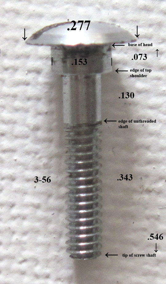

IPB figure1 item 18 part number 32388P1 - screw, machine special:
#3-56 .546 long, threaded section .343, unthreaded section .130, shoulder .073 x .153, head .277. All measurements in inch. 1 inch = 25.4mm.

Brilliant thanks again! I looked at item 18 on the service and parts catalog and thought well I can measure the broken one but what is the thread and depth - now I know I can have one machined :D
Hi,
Just so you know when I was checking the thread on my broken screw I found it to be in fact 3-48 UNC as measured against that tap, the 3-56 was much finer, maybe Graflex used different screws on early and late models of the Grafmatic, I don't know, but for anyone who may have the same problem as I did, it is worth checking to make certain to avoid problems.
