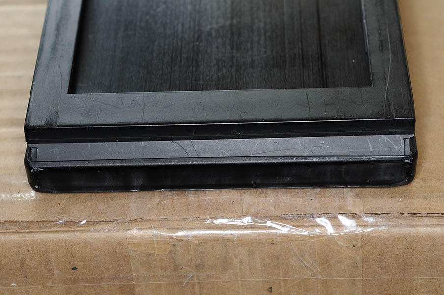

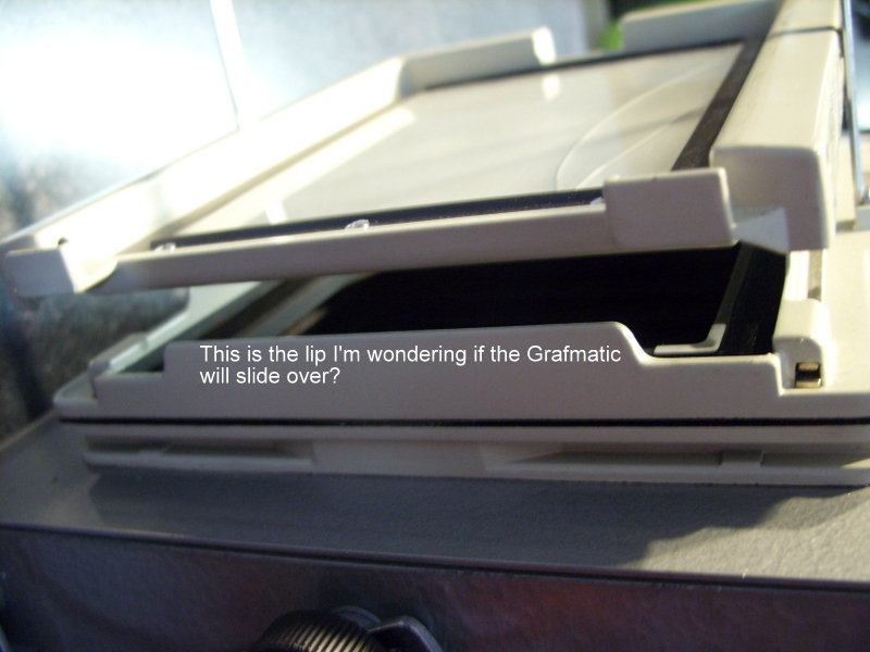

My spring-back has just 1 inch clearance STP80587.JPG , but the lip is what I worry about most since I see the Grafmatic has a step-up, which forms a higher longer lip STP80588-001.JPG on top.

I'm not to worried about the thickness part, but I am worried that the Grafmatic might not slide in far enough due to the raised lip on my spring-back and the slightly longer length of the top of the Grafmatic. See the second thumbnail picture where I have typed on the lip. Click it to enlarge.

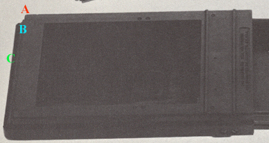

The service manual cover photo
A- 90° step down from film plane edge .19 inch/4.83mm
B- 45° bevel outward from film plane .2 inch/5mm wide, bottom edge of 45° bevel .08 inch/2mm from 90° step.
C- outside edge to 45° bevel top edge .068 inch/1.74mm.
Does this help?

John, from your photos it appears the "lip" you mention is what the back of a (normal) film holder hits when you slide it in? If true, the Grafmatic behaves exactly the same. I doubt you will have issues with the back fitting. Persaonlly I have no issues sliding them below the ground glass (Arca Swiss F line).

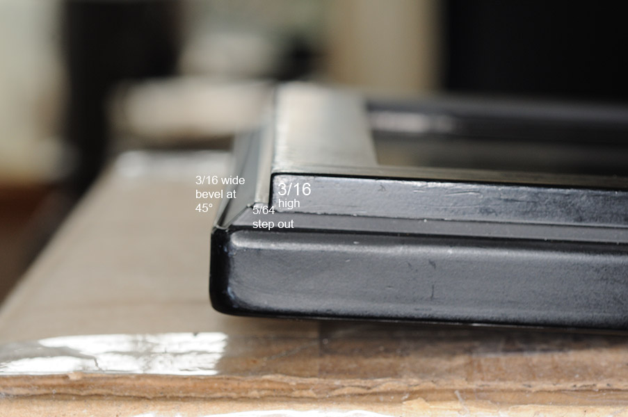

Thanks for those pix. According to what I see here I'm beginning to think it won't work in the Toyo spring-back. The 3/16" high section of your image will not make it all the way to the stop in my film back due to the longer edge and 45 degree bevel running into the 1/2" high lip shown in my No.2 thumbnail. If my lip edge/butt edge of my spring-back were 3/16" high or less then it would allow the Grafmatic to clear the lip on the back.

Click on my second thumbnail above and you'll see the high ridge or lip that we're talking about. I'm pretty sure it won't let the Grafmatic go in far enough. Look at your Speed Graphic and you won't see the high edge or lip. Of course I could be wrong? At least my wife says I am most of the time.

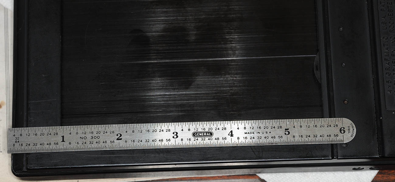

The big question everyone is missing is how far is it from the tall wall at the end of the spring back to the light trap valley?
The ruler laying flat on this 1268 Grafmatic was squared to the end of the grafmatic with a perpendicular straight edge.

Shutterfinger,
That's the photo that solves the mystery. It looks like your rule say 5" 27/32. I used my rule and my measurement show 5" 16/32. So it's definitely not going to work in my spring-back unless I grind that lip down like was suggested. I think I'll just use my regular film holders for now and see how I get along before I do any grinding. Thanks for all the help guys and especially you shutterfinger.
