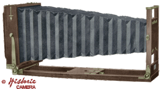

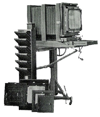

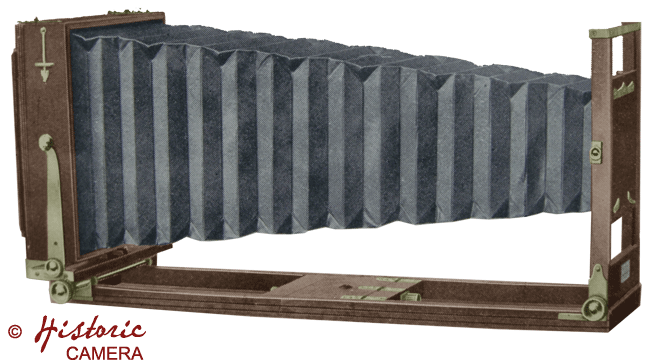

post #4 has a catalog with the cameras that were being offered at the time by the same
company. my poor uneducated guess is seeing it is bigger than 8x10 it might fit
a century 11x14 camera, ( the ones listed in the catalog ) ...
maybe it fits one of these
they are both from the same time period
and i believe both made by the same maker.

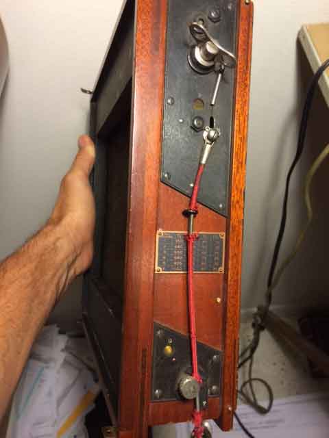

attachment.php
There is no serial number but here is a photo. The shutter release is interesting, it pulls the trigger instead of pushing it. It pulls against a wire tied just above the trigger.
By the way the repair you describe above is very clever! I will remember that one...

Fairly early design. Rotate the FPS 90° so that the controls are on your right. Common serial number locations are lower left corner or front side opposite it, stamped into the wood or on the bottom side of the top. It will be a 4 or 5 digit number.
The spring tip was borrowed from a spring making tutorial post in the Camera Building, Repairs and Modifications section of this site a while back.
