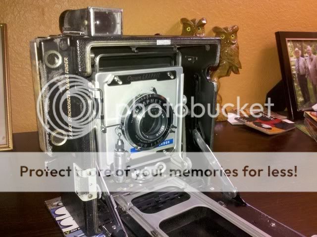

Hello fellow APUGer's I have a camera that belongs to my dad and it needs a little work. I was wondering if you fine folks here could give me a ballpark figure on cost, or point me in a direction of DIY.

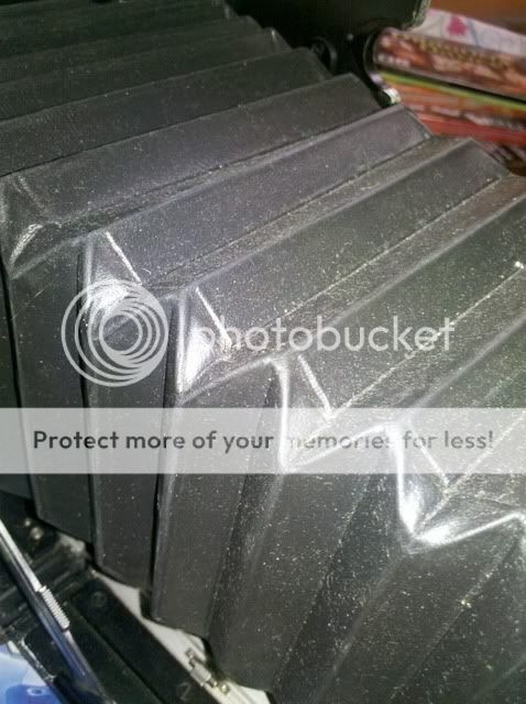

The bellows appear to be in pretty good shape, so I don't think I will need to replace them. What is worrying me is the corrosion on the body of the camera. If I believe the guide at graflex.org then the camera is from 1948 according to the lens. Which makes this a Pacemaker model right?

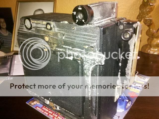

I've restored 2 Speed/Crown Graphics that were in far worse condition, this one shouldn't be too difficult at all. You need to reove the back, view finder and range -finder, all very easy and take them to pieces. It should just be the cover on the range-finder that needs restoration.
The corroded metal parts need all their paint stripped off them then cleaning with a wire brush to remove all the corrosion, with the aluminium parts that must be thorough. Then paint with a spray primer (automotive paint) and rub down with #600 grit wet & dry paper, do this until any pits are filled and the parts look good, then spray paint with satin black paint. Then reassemble.
The black leatherette polish with black boot polish.

By rangefinder you mean the thing with 2 windows on it on the right side of the body right? What about the shutter lever that's on the body?

Yes that's the range-finder. The body shutter release will depend which part is corroded, if it's the plated surround you may need to get a replacement, the bit you push should clean with a wire brush.

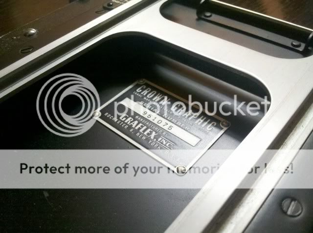

s/n 951075 was in a batch of serial numbers assigned 4/5/62. The next batch was assigned 9/17/62. Your father's camera was probably made between those two dates. The lens is, as you determined correctly, older.
I'm a little surprised by a 1962 Crown Graphic with Kalart rangefinder and spring (Graphic) back. In '62 Graflex' own top RF and Graflok backs were standard. Could be that parts were swapped after the camera was sold, although new front door on old body is pretty well unheard of. Where is the "bump" for releasing the front door when the camera is closed? If on the side, pre-1950. If on top, later.

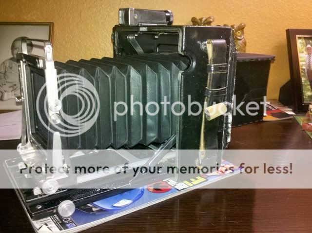

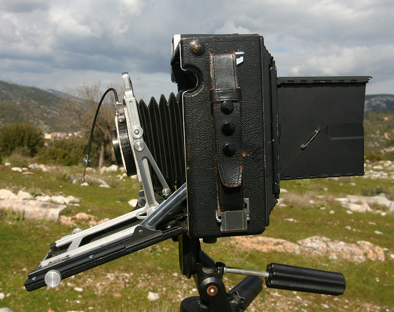

Dan, the S/N of my Crown Graphic dates it to 1963 and it's the same as the one here, spring back & side mounted range-finder.
Also the door release is on the side (see attached) the same as my mid 50's Speed Graphic, as is the catch on the OP's camera (5th photo).
Ian

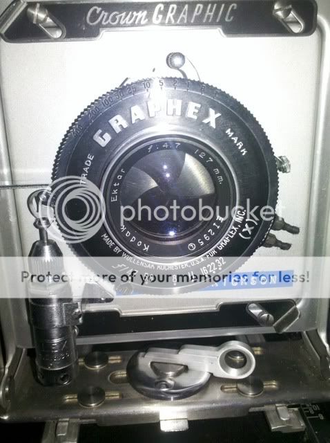

Dan, as Ian has pointed out the release button is on the side near the top. If you go here the second picture down shows it with the kalart on the side. Thank you for the info on the date of the serial number though. The lens seems to be in ok shape except at the slower speeds. The timing seems to be off or lagging. Might have to get that CLA'd. Just going to have to figure out where to take it, or send it to, first.

It looks like it is usable as is, if you don't mind a few cosmetic warts. You can go to Graflex dot org, where they have posted instructions for calibrating the rangefinder. While you have it open, you can carefully clean the film off of the mirrors and rangefinder glass as well.
The entire back is easy enough to replace once you find a donor camera. That will take care of the corrosion on the back, and you can "upgrade" to a Graflok back while you are at it. The parts camera may also come with a usable cover for the RF, which would take care of the other main cosmetic issue. Parts cameras might be anywhere from $25 to $100. It'll probably be just as expensive if you buy those two parts alone, as opposed to an entire parts camera. Plus with the whole parts camera, you could get other potentially helpful items as well. Screws, brackets, infinity stops, etc.
You have a solenoid, which means that you can mount a flash handle in place of the hand strap, and very smoothly release the shutter from the handle electronically by running a cable from the handle to the solenoid. You don't have the right-hand flash brackets, though, which go over the RF on the top end. You might prefer that, especially if focusing with your right hand feels awkward. The drawback of releasing the shutter this way is the added weight of the D-cell batteries. I think I have a spare cable and flash handle if you decide to track one down, and I am in L.A.

You don't need a Graflok back, just refurb as John says I've given you my suggestions, it's two or three nights work because apints need time to dry, but it's very easy.

As it is your camera's worth very little at the moment and looks bad, a new back will be $70 or more as they are sought after to make reducing backs for larger camera's, you'd also need a new range-finder.
You've nothing to lose taking the existing back off (6 screws from memory) and then taking apart and cleaning up, use a wire brush for an electric drill and just see what appears.
