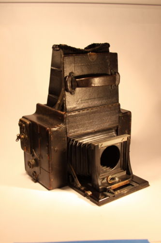

I won a Graflex 3-A on ebay and now I'm wondering what I should do with it. It takes postcard size photos on 122 film. I was thinking of building adapters/spacers so I could put 120 into it and take 2 1/4 x 5 1/2 size photos (4 to a roll). I figured on using my Nikkor 90mm SW on it but it won't fit on the lens board and even if it did, the camera needs a 6 1/2" minimum focal length lens (I guess to clear the mirror). Doesn't seem like much fun taking a panoramic photo with a "normal" lens. Any suggestions on what to do with it (other than putting it on display)
Thanks,
Dan

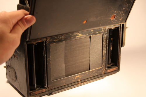

It's arriving today (finally) so I'll get to give it a close look. No lens but I have a couple of 7" Kodak Anastigmats which would work with it. I paid $10 less than it was going for back in the day - didn't seem too bad to me.
It isn't the autographic one (I have a 120 format Kodak Autographic something or other - still has a piece of the carbon paper in it) - serial number dates it to around 1915. And, it looks to have two spools with it already (I actually have a few lying around at home - one has an exposed roll of color film on it). In that picture of the curtain, does it look like someone put in a mask to take smaller photos?
Paper negs - brilliant idea - I'm definitely going to try that (and if that works, I have 8x10 ortho-lith film) using the backing paper from the exposed roll I have.
And I like the pinhole idea. I have several (too many) Ektar 127 and Optar 135s - problem is the camera needs (according to the catalog I got from camera eccentric) a 6 1/2" minimum lens. With a 5" deep body, even working around the location of the standard using a recessed lensboard, 4"-5" from film plane to lens will put the lens well inside the body where it will get hit by the mirror.
Dan

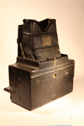

Like so many other projects, this has been sitting around. The curtain is dry but moves through most of its range - runs out of speed at the bottom - some pledge might fix that. The shutter fires using the lever on the right side, but the lever for lifting the mirror and firing the shutter does not work - it's frozen in place. So, there's work to be done on it. Or not... I bid on another one last week - seller listed it as for parts only, which seemed perfect for me. I got it for $20. It's also minus the lens but the lens board (with retaining ring) took the Anastigmat 33 I had lying around without one (and which cost me 99 cents). Here's the funny/annoying/difficult part. It works perfectly, the hood is nice, the curtain soft, the bellows light tight. The only thing wrong is the external leather is a bit rough, the handle is missing, as is the latch for the top (so a handle wouldn't be useful right now anyway). The first one is from 1915 or so (from the SN list) and non-autographic. The new one is from around 1920 and is autographic. There are some slight but noticable differences in details - the newer one is taller, the levers and such are different. My thinking right now is the older one goes on display and the newer one will get converted for 120 roll film and get put to use.
