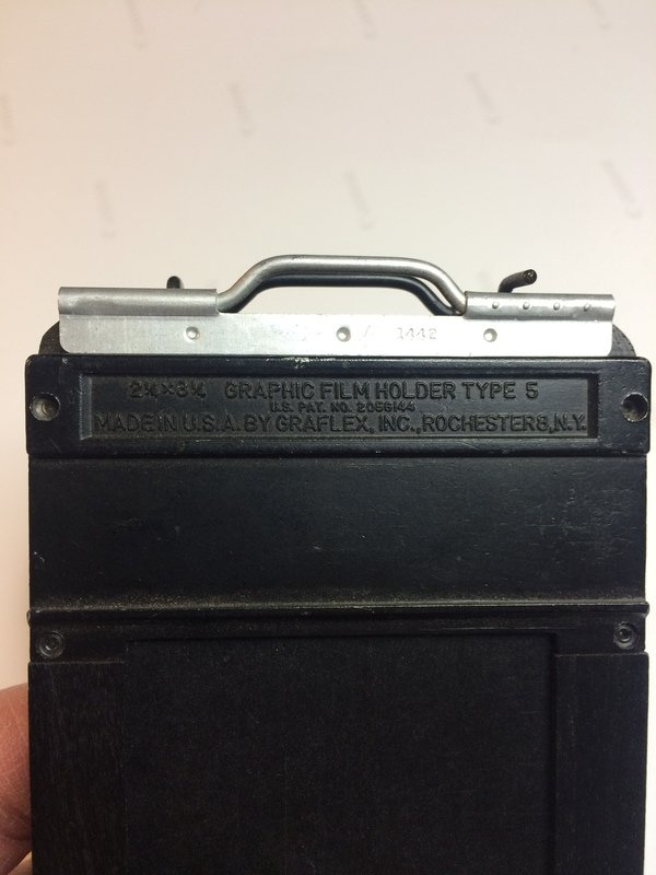

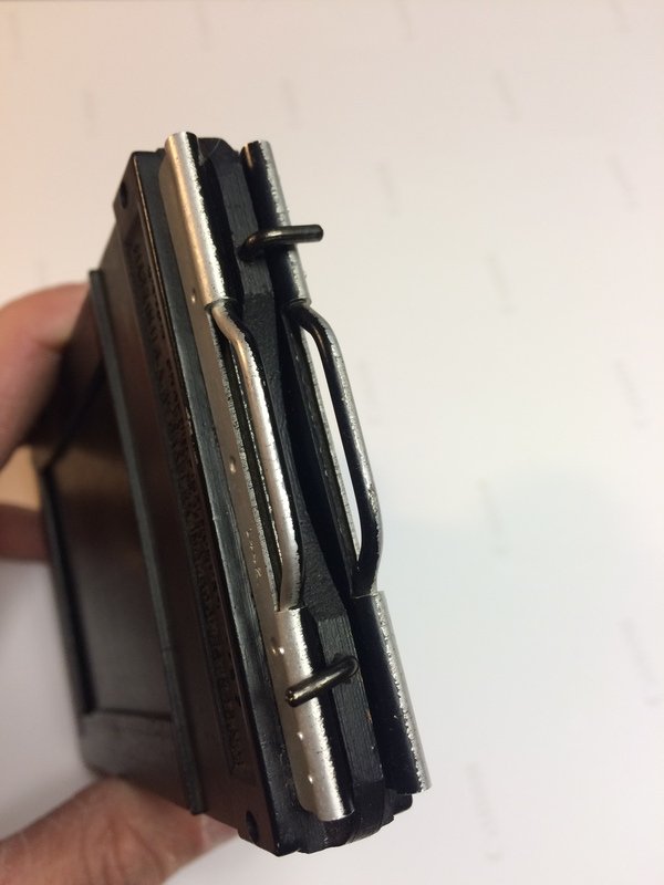

I have got this 2x3 holder type 5. Very simple device. Small hooks work as safety lock retaining the dark slides, at the other end, a band of plastic, tape-like, holds the flaps on each side, the flaps have a groove for the dark slide end.

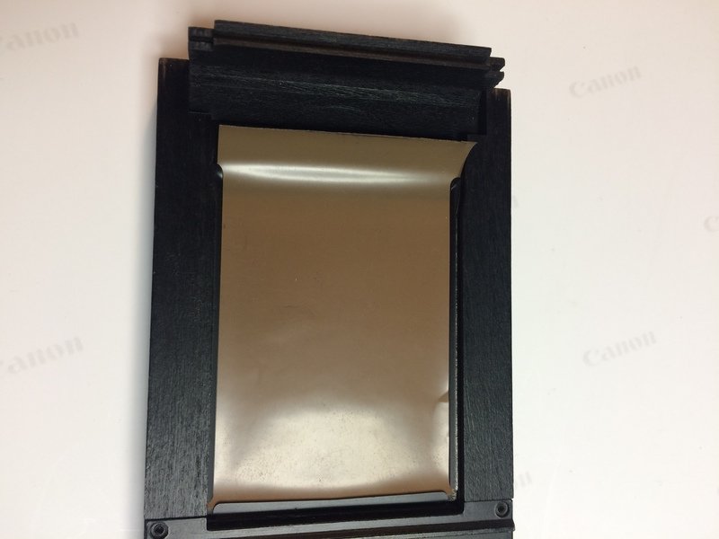

The holder came with a sheet of film on each side. Two small notches on a short edge of the sheet.

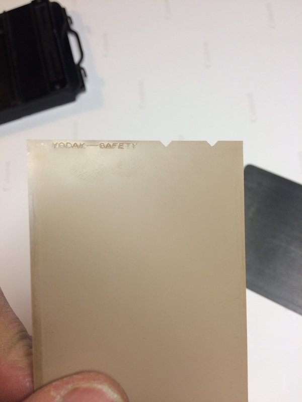

But no film model marking, instead it's engraved "kodak safety". Wondering what it is.

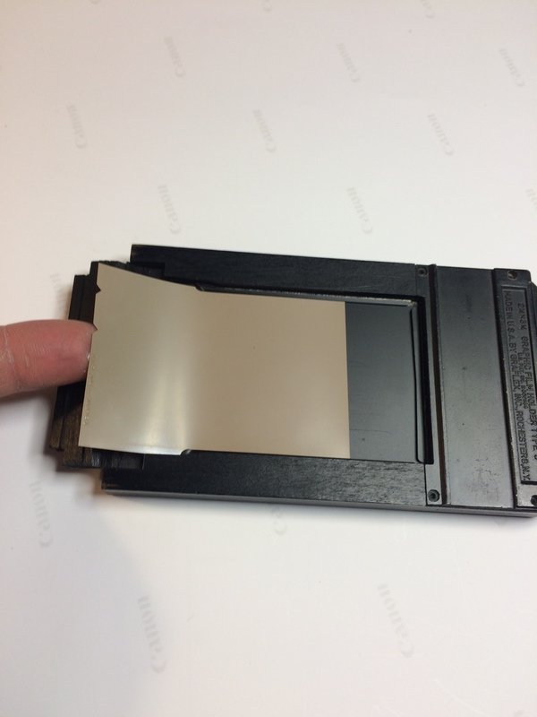

What surprises me is that the end with the flaps, to insert/remove the sheets, doesn't open level with the plane of the film holder, so I must sneak the finger tip in order to lift a bit the edge of the film and with the thumb of the other hand slide it out. I don't like to put fingers om emulsion side. It had been better if the end could be taken off completely but for sure it can't, just the flaps that can be opened.
The notches designated the type of film it is, or was. Can't seem to find a current notch code for Kodak, but here is an example from 2003 which identifies the film, on page 2, in your holder as Tmax 100
https://www.heli.city/docs/unsorted/kodak/f3.pdf
When loading the film into the film holder, the notches must be on the right as shown in your first image, and signifies that the emulsion side is up and ready to be expsoed.
"Kodak Safety Film" is just a term which Kodak applied to all of their acetate based films for a few decades after they discontinued their Nitrocellulose films. The word "Safety" meant that the film was less prone to spontaneous combustion than its predecessor. The term appeared on virtually all formats and types of Kodak films for a few decades."
Hmmm .. here's some clarity.
Make sure your hands are clean and dry. Slide the dark slide about half way out, not necessary to take the dark slide all the way out. Then with, one hand only,. is lift the edge of the film with the nail on your middle finger tip, then Grab the edge of the film sheet with your thumb and pull out.
The notched end of the film is not completely exposed as the flap holds the film flat, and there is about an 1/8" of an inch unexposed area
I find it weird to use fingers on emulsion side in order to push the sheet out.
It is weird, as you do not push it out, you pull it out. Try what we explained and here is another reference for you.

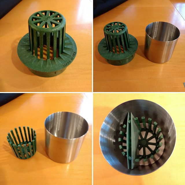

I've been developing my 2x3 sheets with a setup like this. Works well enough but no more than 4 sheets at a time.
