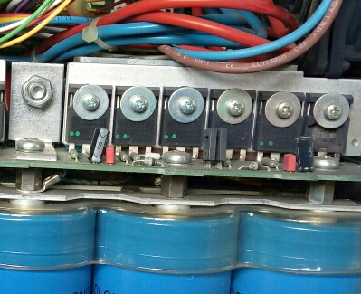

Hi,
Hope someone can help me.
I have an old Broncolor Grafit studio power pack/generator that I would like to repair myself. (Note: I have experience with flash electronics, high voltages and lethal capacitors).
The previous owner advised me that after storage the pack was tested and popping sounds were heard. I have opened the unit and discovered that one IGBT has exploded and others are damaged. Fortunately the IGBTs are a common type and are available from Mouser/Digikey.
The display and controls work OK however the caps dont charge and the display shows avail power of '0'.
Whilst I can simply replace the IGBTs I am unsure what may have caused the IGBT failures and am seeking tips from anyone who has repaired one of these units before.
I have seen another Grafit pack with similar IGBT damage so assume that this failure mode may be well known to techs.
The capacitors look physically ok however I will check the ESR of each cap during my repair. After repair I will carefully and slowly reform the caps.
(Of course I keep the caps shorted when not being tested or reformed).
As the unit isnt charging the capacitors I suspect that the charging circuits may also be damaged.
Can anyone offer service tips?
(I am a non-commercial/art photographer so cannot afford to have this unit serviced by an authorised repairer. My only hope is that I can repair this myself).
Many thanks
Emulsion.

Attached is an image showing the damaged IGBT at the top right. Several other IGBTs have small pinprick holes where they have failed also.

What is the purpose of the IGBT's? From the photograph it looks like they are there to short the capacitor bank to quench the flashtube (!) (?).
If they are across the bank then they could have failed to a short, and thus the capacitors can not be charged. It would also explain why they are a high failure rate component. I'd recommend replacing them with the highest amperage devices you can find that will fit, and make sure you have a minimum of 25% voltage margin (i.e., 400V max circuit, at least 500V IGBT).
The control circuit could have been damaged by such a catastrophic failure (or, it may be the control circuit malfunctioned to cause the failure).
If the failure is just the IGBTs then the problem is most likely one of component rating.

Since you have IGBT damage, they need to go first. Order extras just in case given they're usually cheap. Check through components with a multimeter set to continuity while everything is unplugged. You're going to want to look for stuff passing power that isn't supposed to be (resistor that's gone out of tolerance, capacitor that's gone to a short). Check resistances with it set to ohms, make sure your resistors are all in spec.
It'll be harder without the schematic or a repair guide, so try to find a service manual if you can.
To do a wild guess, IGBT and chunks of the epoxy missing sounds like too much power went through it, so you could just go for one with the same trigger rating but supporting a higher current capacity. The caps are likely fine.
Or if you like gambling, replace all the IGBTs in the pack with new equivalents (go by part number) and some spares and hope it doesn't go bang again, and if it does, it's something causing the IGBTs to explode.
Pretty much just poke with a meter, check things are in spec, replace things out of spec and damaged parts assuming it's a relatively easy enough issue to track down.

I could be a simple bad IGBT. I work on corona treater power supply which has IGBT to invert DC to AC. The IGBT at times locked up and cause short circuit. It could be the firing circuit. I think in most inverter if both IGBT are fired at the same time that would happen.

Thanks, I hope it is just the IGBTs. I will test many of the surrounding components whilst I am waiting for the replacement IGBTs to arrive.

Are the voltages from the power supply in spec? It'll probably have a few different voltages for the electronics (low voltage stuff) and for the capacitor bank.
Hi,
Many thanks for your reply.
It is difficult to know what voltages to check for as service manuals and schematics aren't available.
I seem to be limited to try and figure out parts of the circuit myself ...this makes repair more complex.

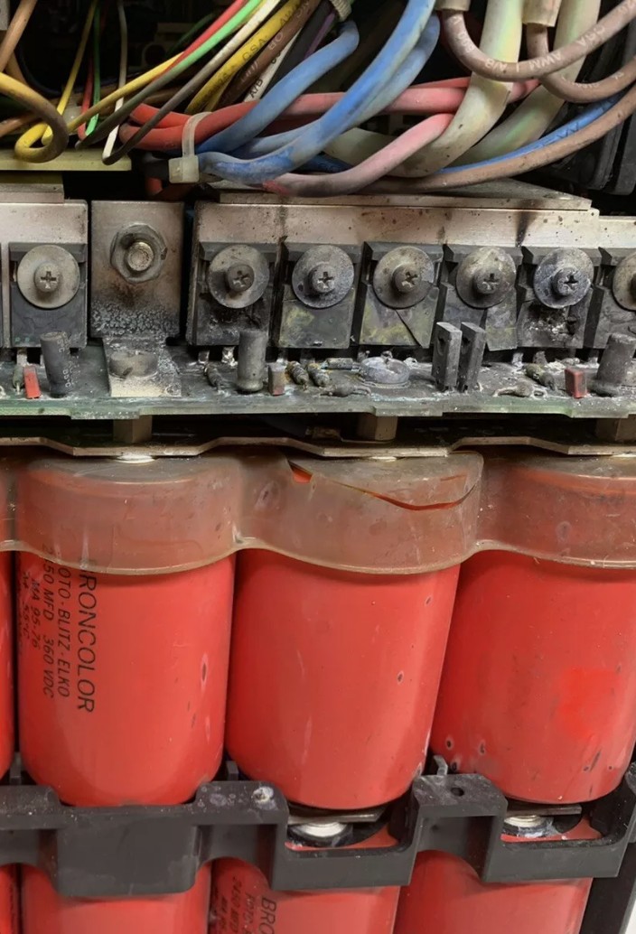

I saw another Grafit on eBay with exploded IGBTs.
Please see the attached photo.
Does anyone know what causes this fault?

This damage is impressive. I wonder what people at Bron would say about this.
I don't know how to make contact with any engineering people at Bron.
If anyone has any contact info for them please send me a DM!
