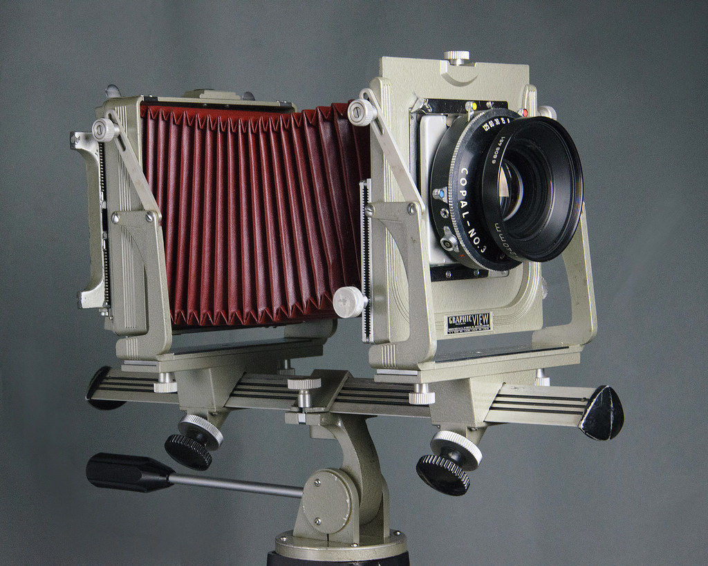

Here’s my Sironar 240mm f5.6 in a Copal 3 on an even smaller aluminum Pacemaker lens board. It’s mounted to the Graphic View II via a Pacemaker-to-Graphic View adaptor, a handy accessory if you ever consider adding a Pacemaker Crown or Speed Graphic. This lens weighs about 1 kg. You will be fine; just hold on to the front standard when loosening the front tilt knobs, as the weight may be forward, and it may want to flop forward.
I love using the Graphic View II.
Graflex Graphic View II by Howard Sandler, on Flickr
