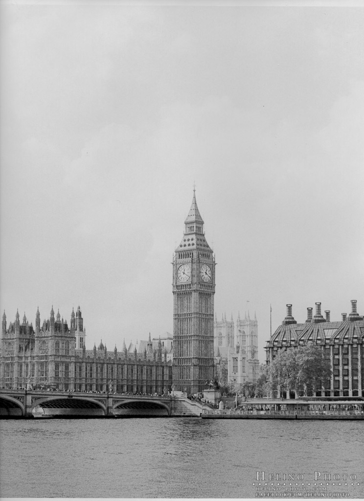

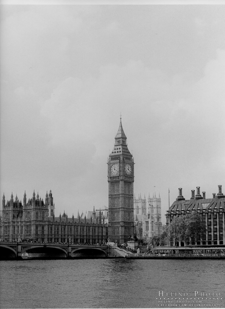

Ok, so I did two attempts to recreate the above.
These are printed at 1,5 grade (both of them), the darker one 2/3 stop darker than the brighter one.
The brigther one, has all the details under the bridge, while the darker one has details on the brightest girders below the bridge, fading into black.
The white point represent the paper as seen to the eye, if I had set it to white to match the monitor-white, it would not represent what the eye see when you look at the print, as it would be too white.
This is the best I could do, regarding the sky, even though I see that the scans of these prints somehow yields more detail actually visible to the eye (I have tried to reduce the contrast in the sky on these, but they still show more than you actually see with the eye).
Both work, but I like the brighest one the best, I find the lower contrast on the buildings work best to give the photo a nice feel (the parliament buildings are yellowish)
The darkening on the left side is the scanner, these are 24,0cm * 30,5cm prints on Adox MCP 312 RC paper.
I prefer the brighter print.
Brighter
Darker

I would take the upper one and burn in the sky with grade 0.
When the sky is grey like this, the foreground often becomes too dark when printing on one grade only. I always measure (split grade controller) only the foreground and than burn in the sky at 0.
Regards,
Frank

Well, I tried 0, but the clouds would not come out at all then (just faded to grey), at 1.5 grade filter, the sky came out, but that does indeed influence the rest of the shot.
The water is burned in at +2, very easy due to the clear line.

I tried a handful of test-strips at 0, and it simply showed that the sky went from white to dark grey, depending on time, no details, just a whole block of the same tones.
I think the reason is that the tones in the sky are so close that a 0 grade-filter just push everything down, the light contrast filter seem to be able to separate them, but one has to be careful as well, the darker shot shown, is on the verge of becoming grainy in the sky area.

Isn't the problem that with burning in the sky with a higher filter, the buildings sticking into the sky can end up with a noticeable lighter halo around them unless the burning tool is very precisely contoured and used? This looks to be a difficult picture in which to accurately burn in the sky to the extent that the OP wants without some noticeable halo effect on the sky or risking the edge of the buildings going a lot darker?
pentaxuser
Yes, this was my conclusion as well, so split-grade was my initial plan. The darkest greys in the sky, is almost the same tone as the lightest part of the buildings.
Ended on a whole exposure for 1.5 grade (with a +2 stop burn on the water) and I ended up with something very close to what I set out to do.
The negative is probably a little difficult, since it is overexposed (sun kept coming in and out, behind and to my left shoulder so it was hard to measure for snaps on my holiday).
I'm usually happy if I have any detail in such a sky. And I see outlines of clouds here which is good. For more contrast, you could perhaps experiment with some localized preflashing on the darker side of the cloud edges.
Hehe yea, I just find that a little difficult, since it fades to dull gray so fast, not sure how good I would manage to preflash (I only have my enlarger and it means taking out the negative etc and test flashing at various apertures at 1 second, which will be spotty).
Running out of paper, I settled on the lighter edition, it was a good learning-process with the various filter-effects =)
