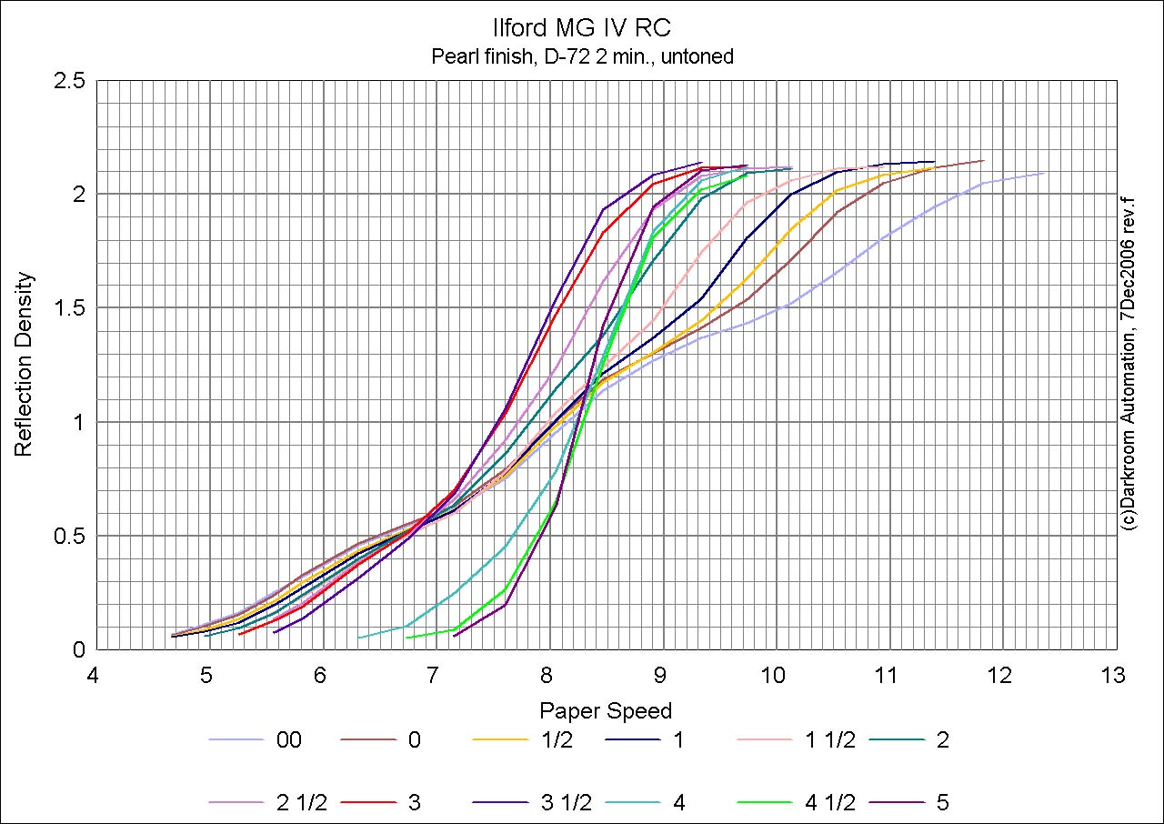

... By the way, is there any H&D curve difference between using 00 and 5 filters versus using the equivalent single exposure with an intermediate filter?
