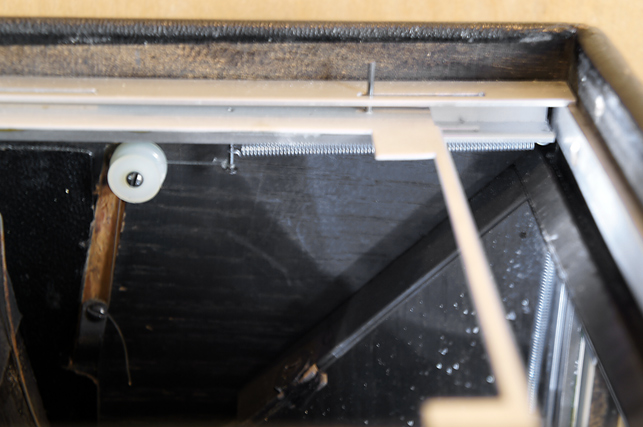

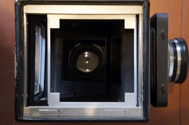

OK, with Brad's encouragement, I've delved more deeply & I may be able to do this. Looks like all I have to do is detach the spring that hooks up to the little pulley. Still not sure if GG lays atop the moving framing bit (i.e. with cross-shaped cutout), or if it's set within it. See attached pix.

PIx of camera
Pix:

BradS
Sep 28, 2004
8,120
Soulsbyville, California
I believe that the GG lays way on top between the two top strips of aluminum. That squarish plate of aluminum with the cutout cross shape is the parallax thingy...it moves with focus - right?
The focus screen is going to be rectangular and fit across the whole opening. the top of the glass is flush with those outer aluminum rails...no?

Here's the latest: I determined that the GG is set within the aluminum parallax frame (it's about 5" x 4.75") You have to epoxy one edge of the GG --on the pulley mechanism side-- to the frame, while the other side just rides on its rail. You have to be careful because the aluminum deforms easily. I used Devcon highest-strength epoxy and let it set overnight.
Unfortunately, when I field tested the camera, the taking and focusing lenses didn't jibe. Arrrgh.
