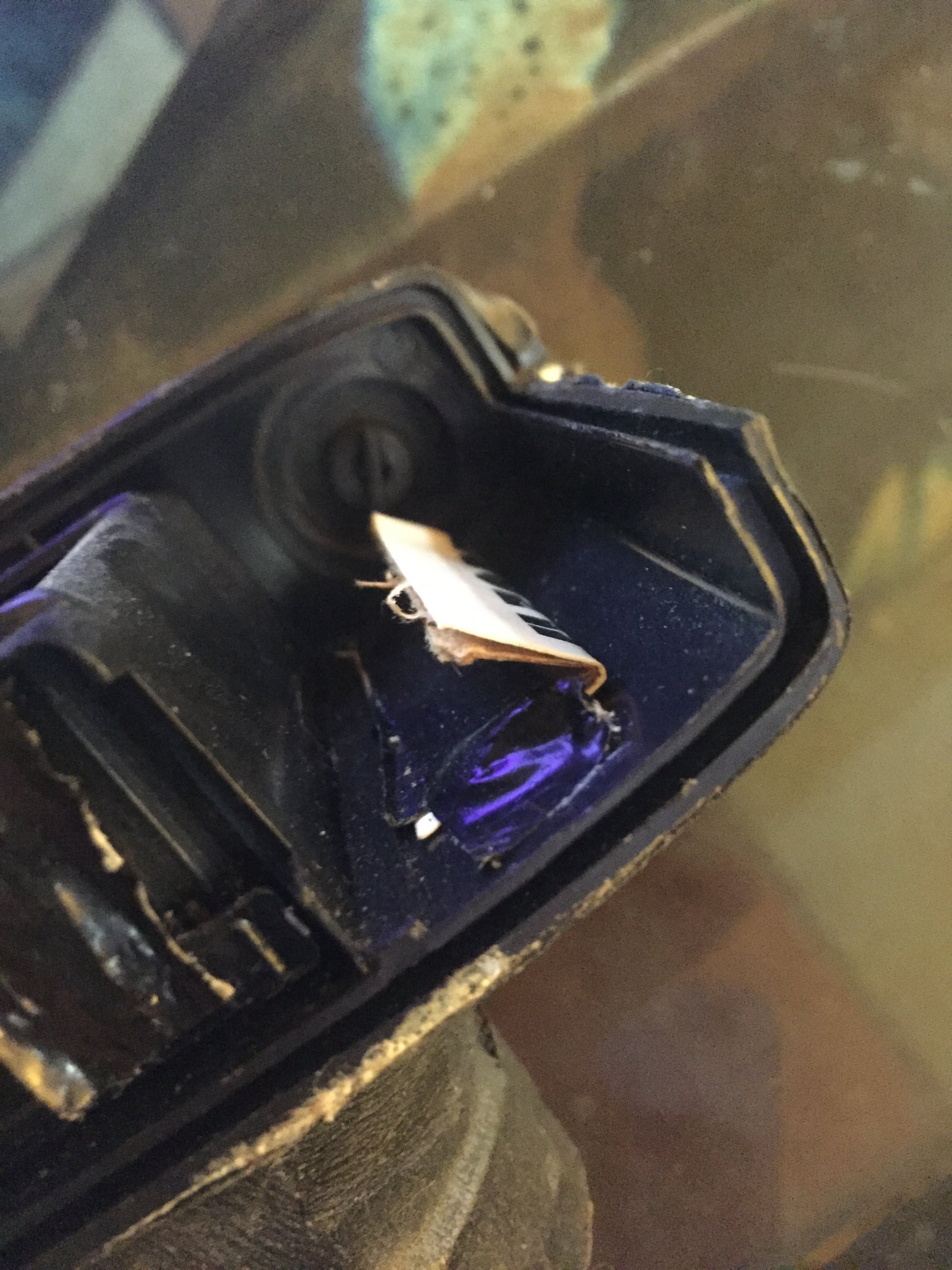

You might want to add something in the take up area to keep the film taut when you wind. Exposed rolls can be loose. You can glue in a piece of sponge, or add a folded piece of cardboard (I use a piece of a film box, taped in with electrical tape).

That's a great tip! Thanks!
