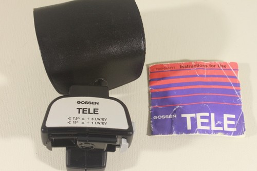

Currently looking at the "Variable Angle Attachment" (their "budget" spotmeter attachment with the angles being 7.5° & 15°) that's specifically for the SBC lightmeter, and was woundering if anybody has used it/has experiance with it? Thinking about getting one, mainly to use with some expired 120/220 slide film I have in my freezer.
To add to some confusion (for me at least), there seems to be two different versions of the attachment, a "Tele" and the other labeled "Variable Angle Attachment", with both externally looking the same/both colored in grey & black. Dont know if both are the same & just named differently (aka US name & "everywhere else" name) or if theyre completely different. Any info would be appreciated

The variable spot attachment, 7.5 and 15 degrees, is an optical attachment for the Gossen LunaPro and LunaPro SBC. (European names may differ.) It came in grey and black but both the same. The two names you cite for the same item were just different marketing terms.
I use one both meters and it does what it purports to do. Care must be exercised when transferring light value to the meter dial to ensure that the correct offset is employed with the LunaPro. Null as regular with the LunaPro SBC. The viewfinder is not very clear but sufficient for metering. It’s a very affordable solution for metering a narrower coverage than the basic meter.

Would this one be the right version of the attachment for the SBC? For the price it's not that bad, especially since I'd be getting it mainly as a way to "dip my toes in" using a spotmeter without having to spend alot more on the Multispot version or on a dedicated one.

La-la-land
Yep.

This is no the variable spotmeter attachment.
My bad mistake, I saw the white lable of what looks like an upside down spotmeter and did no recognize it for what it is.
