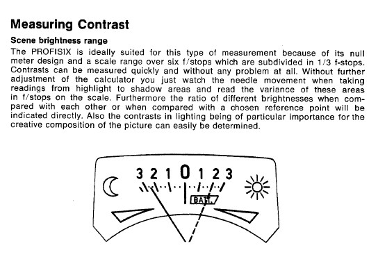

Mick's right about the 1/3rd of a stop increments and I remember using German LF lenses that had 1/3 stop click's on the aperture setting. In contrast only one of my Copal shutters (on my Gradagon 90mm) has markings for 1/3 of a stop.
Sorry Jasper but you are quite wrong the numbers either side of the 0 used for the null reading are whole stops, and clearly marked as such in the meter's handbook. See attached

Jesper, as a result of your last post I backtracked and downloaded the Profi-six manual, for which a link was provided earlier.
On page 27 there is a scene brightness range explanation, which, as the manual states, covers 6 f/stops, which are subdivided into 1/3 f/stops.
Somehow I think you either have a different or doctored scale, or your meter is a bit different to any other Profi-six meter I have seen.

Ian, brilliant!
That is page 27 of the manual, I wish I had the computer nouse to enable me to find something like that and post it.
