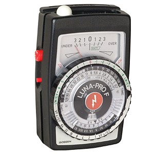

Hello all and Happy New Year!
I have just acquired a Gossen Luna Pro F meter. The battery in it was dead so I got a new one, a Duracell MN 1604, 9V.
The meter is working and giving what appear to be accurate exposure measurements. However, when i perform the Battery Check the meter's needle kicks too high, being far outside the green band that is supposed to indicate the correct voltage range. The green band is labelled BATT, just to the right of the 0 centreline, in the image shown here.
Should I be worried about this? Is this something that anyone else here has encountered?
Thanks for any advice!
Roy

My first idea was that you did not perform a battery check but a light metering.
This could be the case if the battery-check switch does not work.

Completely normal, mine does the same thing. My SBC does, however, stay in the green zone.

I can understand why you would think that, particularly because the first of the two steps in performing the battery check does in fact do the same as a normal measurement.
Here is the relevant extract from the instructions in the user manual:
"Check the battery by pushing and releasing the power switch (4) and then pushing in and holding the battery test
button (16). The meter needle should be well within the battery test zone (12)." I followed these instructions precisely. The power switch press makes a light reading and displaces the needle accordingly: the pressing of the battery test button kicks the needle abruptly clockwise i.e. to the high end of the voltage range. The final needle position depends to some extent on its position before the pressing of the battery test button.

Printed circuit board photo is of the Luna Pro.
Thanks! That is reassuring.
I suspect some internal calibration of the battery voltage circuit would be needed to ensure proper operation of the battery check as described in the user manual. At the present time I really don't want to be opening the case up and trying to make the calibration myself.
I think in the future I shall gauge battery condition by observing the accuracy of the exposure measurements made, rather than trying to perform the battery check.

The double designation by Gossen/their US importer is a mess... (the Luna Pro F without that flash metering should be a Luna Pro, but that is a complete different meter...)

Mine has always done the same thing. It lasted over 5 years with the same battery, and I only replaced it because I wasn't sure how old it REALLY was. Might have been 10 years old.
If I'm not going to use the meter for a few months or more, I take the battery out just in case it starts corroding when I'm not looking.

Thanks to all responders!
For your information:I found this APUG thread from several years ago.
It confirms, as some of you have already suggested, that my meter is behaving normally. Hurrah!

The problem is, that two manuals say the needle must be within that area, a third one however says it to be within that area or to the right of it.
We cannot exclude that calibration issues are involved too.
Another mess at Gossen...

However, in addressing my own original posting, I assume that the manufacturer, Gossen, being German, used precisely the correct logical description in the (original) German language manual. According to the dialogue in the earlier thread, the German manual uses the phrase "oder rechts davon steht", with reference to the green BATT. box. That means, it seems, "or stays to the right of it".
This fact, together with the statements of other Luna Pro F owners, has greatly reassured me.

My Luna Pro F do the same.

No not at all, there are two german manuals contradicting each other.
Also if the needle is to swing out far to the right the design of that green field in inappropriate.
Bujt to be fair. many state of battery indicators at photographic gear is ambiguos and one needs to look up things in a manual.
And such is not only limited to state of battery indicators.
