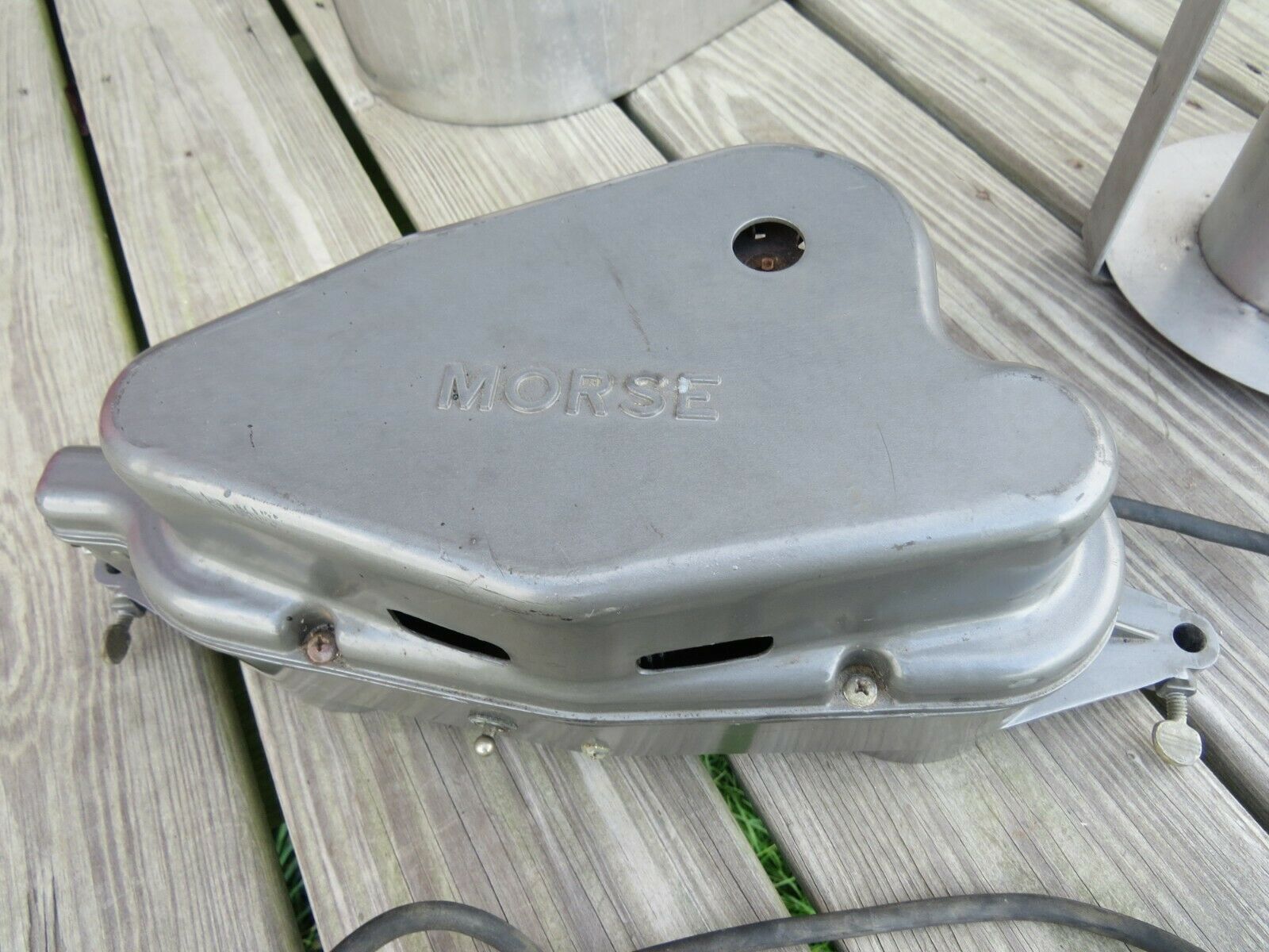

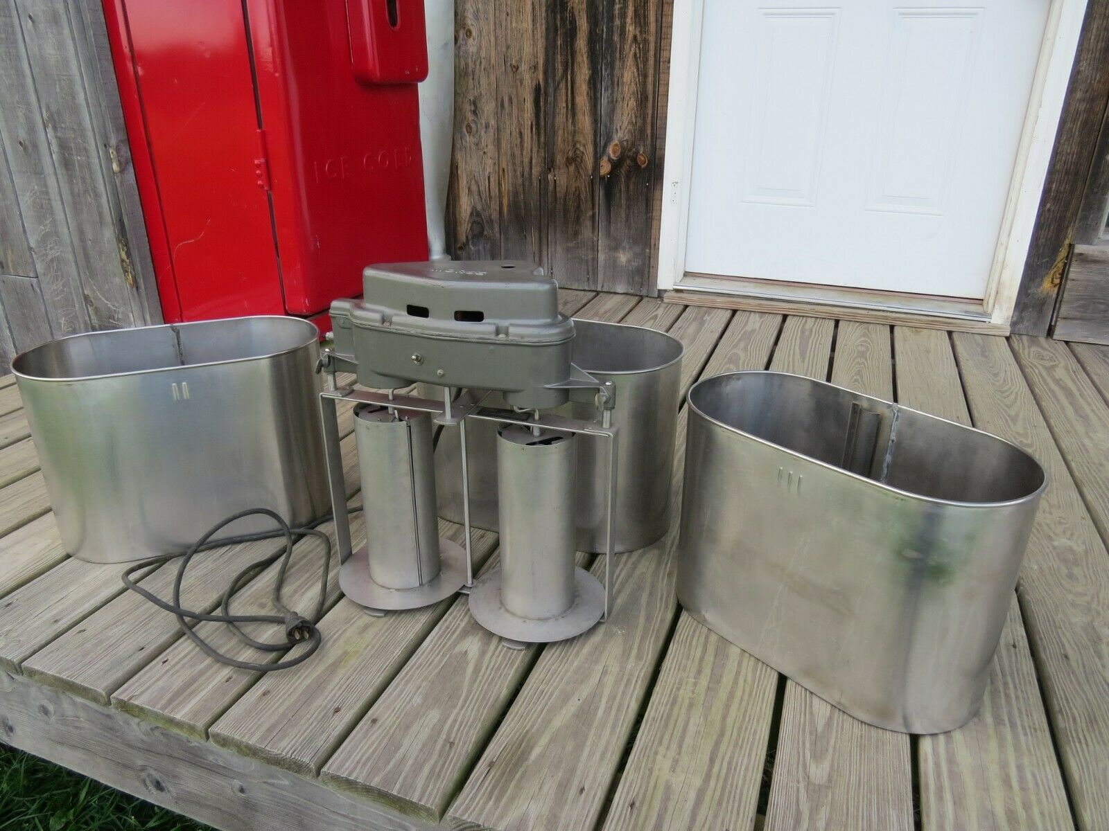

I got my hands on a Morse wind rewind processor. Has a motor drive unit. Was distributed by Gordon Enterprises. For processing film 70mm upto 9 1/2" it's cool as hell. Looking for any info, tech drawings, service manuals etc. I am going to use it to process roll color paper.

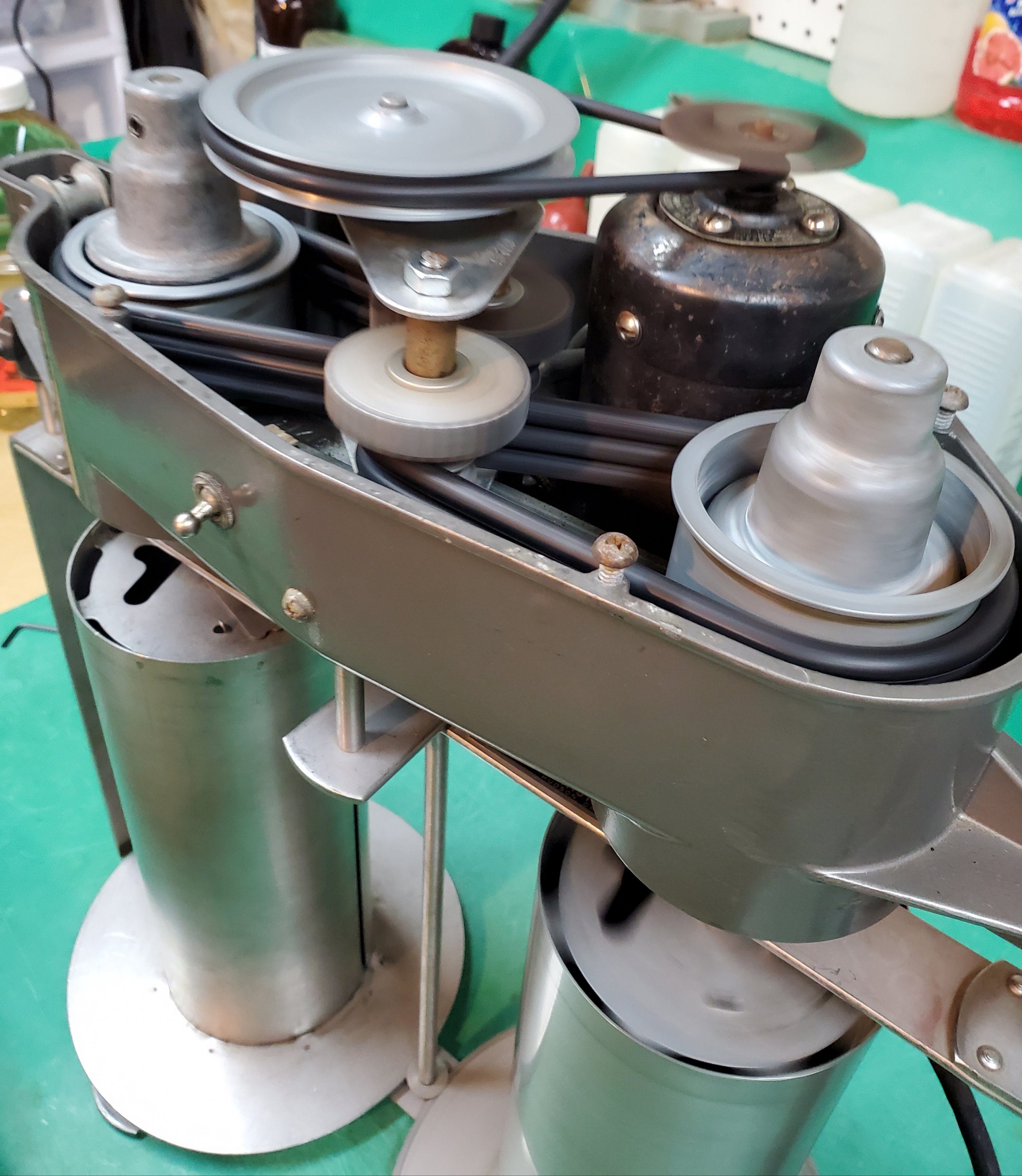

I got the power drive going. Takes 6 Hoover vacuum cleaner belts. I think this unit was made during WWII. It has a "Universal motor" 115V AC or DC. Unpolarized plug, no ribbing or any indication of which wire was the "hot wire" I figured it out working my way back from the switch. Now I can but a proper 3 wire plug.

6 belts? That thing is no garden tiller with all that torque. Thus seemingly the rotating speed reduction is achieved by staggered belt-drives and not by gears.
But what I am more interested in is the way the reversing is controlled and achieved.
Interesting what you wrote about polarity, as the AC, single-phase motors, used over here, do not care about polarity and our mains plugs are not polarized either.

Moving 250 feet of 9.5 inch wide film takes torque.

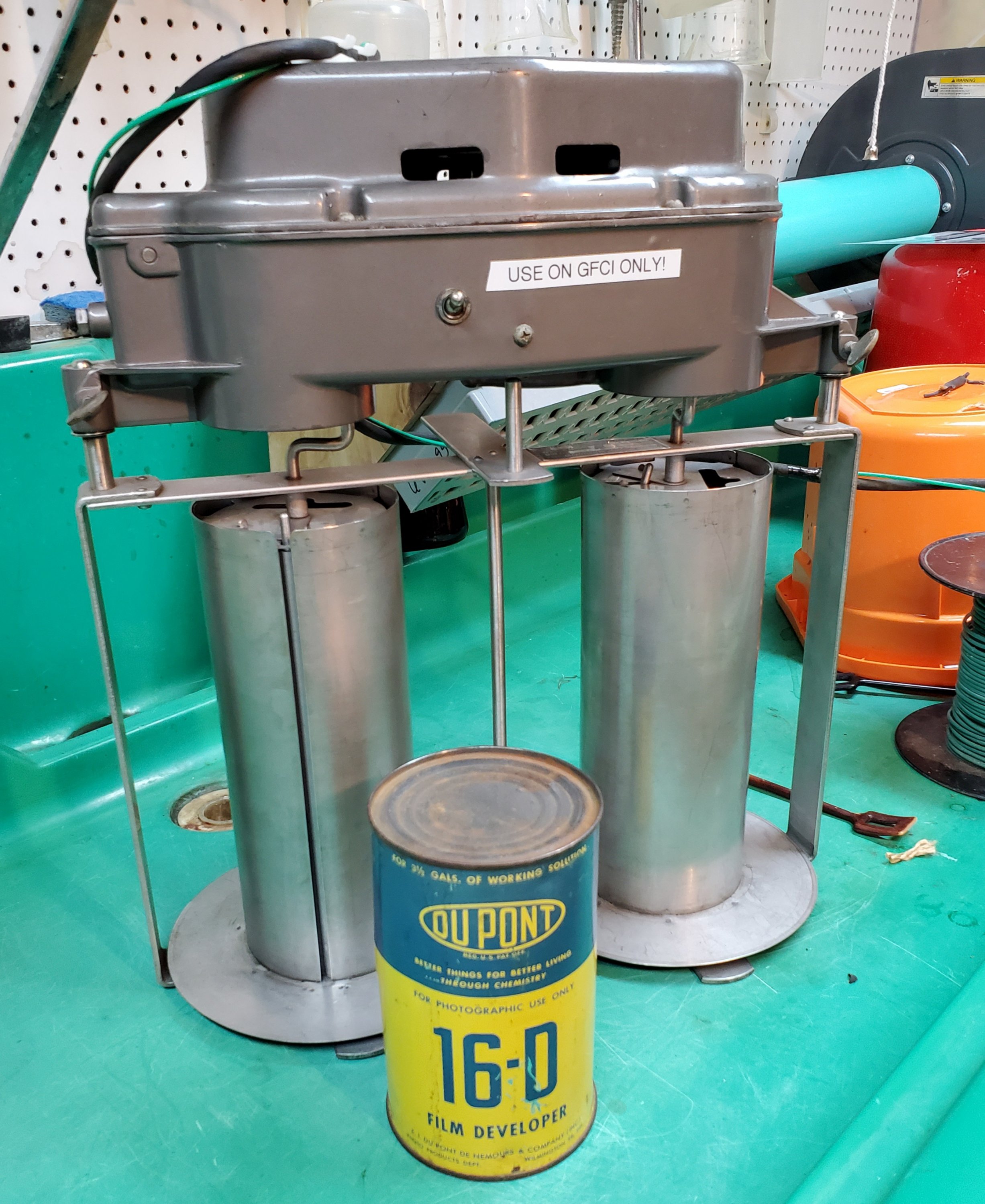

Here's the finished unit grounded with proper plug cord is ok.
