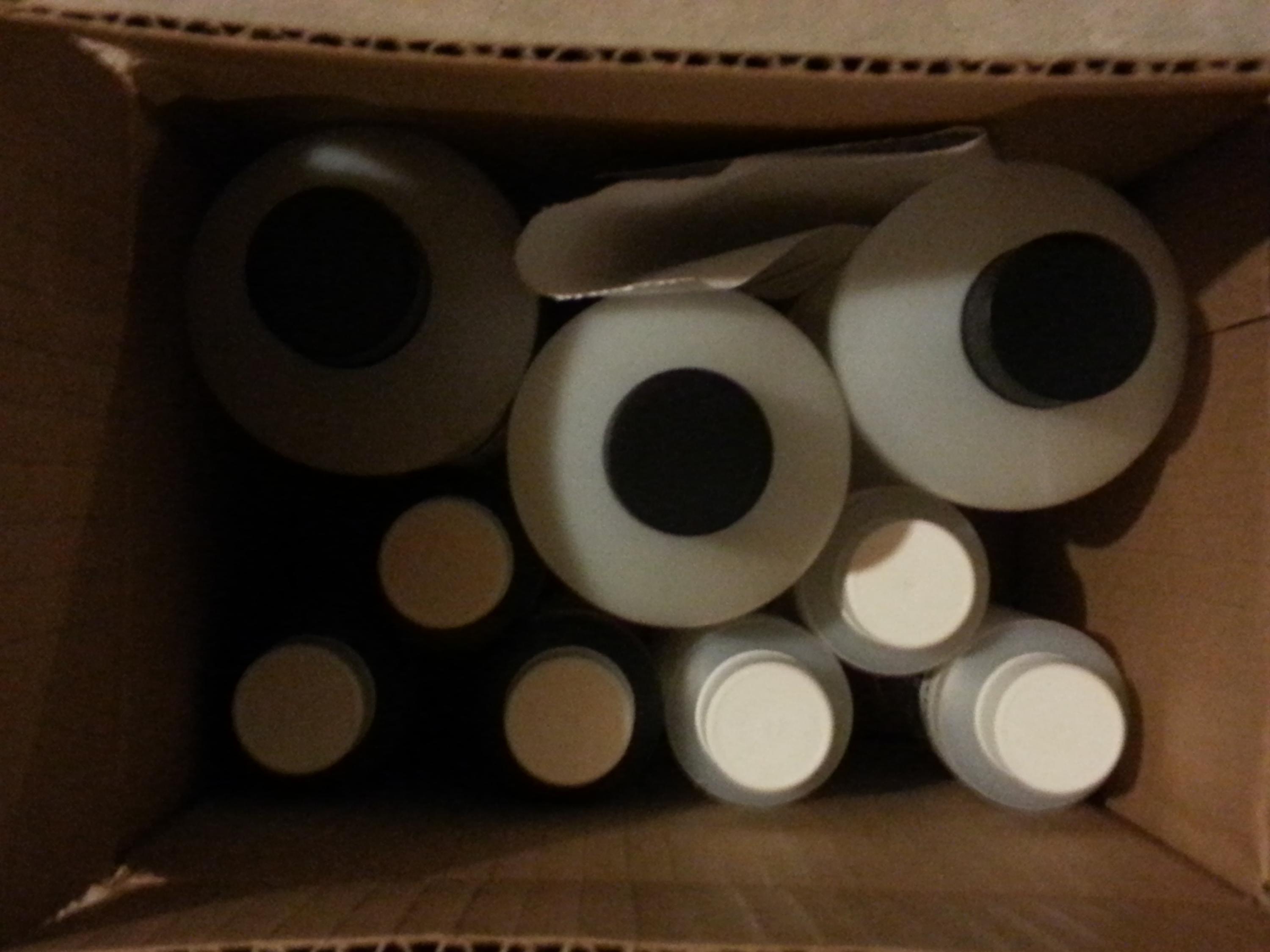

I have a stack of old CPAC Trebla C-41 chemicals. The part C is too old to use. So what I really need is the C-41 developer kit. I've done a lot of research on the chemicals. Now I've finally found the right one.
For individual use, Trebla offers the C-41 HRR Developer Replenisher kit. Cat: 55DE145, 3 x 5 liters. Most of the places sells for $24 and SGA Imaging sells for $14.49. Shipping cost varies. You'll need the starter, which is $2.50 a bottle. So this is about $20 for a 3 x 5 liter kit. The replenish rate is 50ml/sf. Someone can calculate as to the capacity of each liter (how many rolls of films).
This is much cheaper than the Kodak Flexicolor SM kit. This is also better than the Flexicolor 20 liter kit (one large kit). I believe this is the newer kit from the old 55DE571. From the technical data, the new kit is the same as the old kit. I believe the HRR has something to do with the replenishing....
