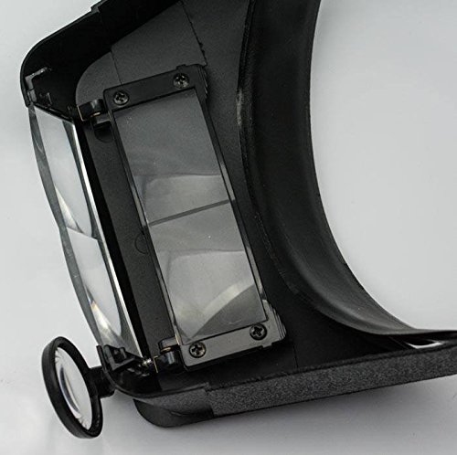

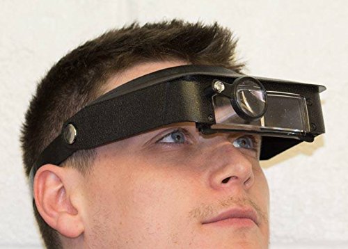

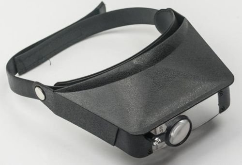

I had a donor give me one of these with a small light table. Dorky - you bet! Awesome clarity looking at the negs and variable magnification. I use it for camera repairs and cleaning, lens inspection and seeing things my weary eyes need to see. (pictures from Amazon) LINK
