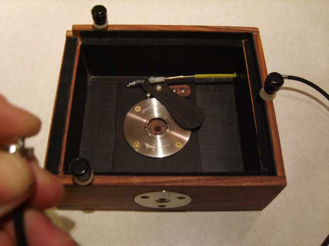

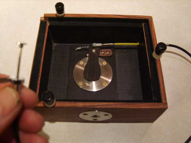

For shutters how about an internal shutter?
John, I made this type of internal shutter for a pinhole camera, and it should work well for your box cameras also. IT can use a standard cable release. What I like are the clean lines of the camera.
