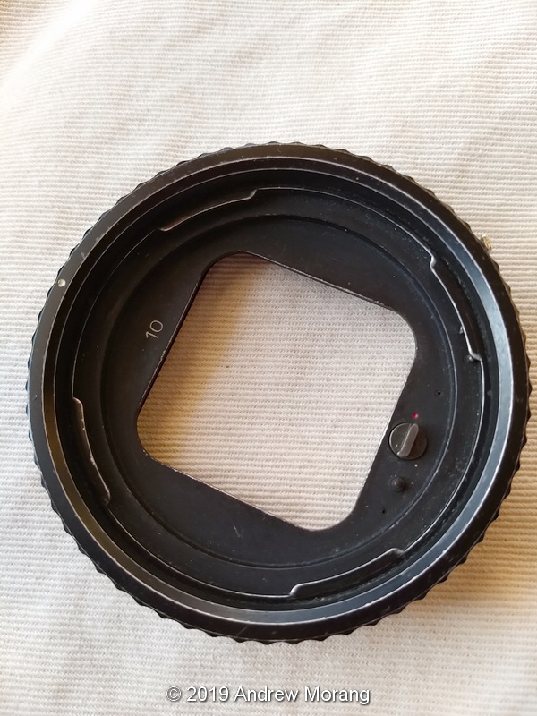

Here is a 10mm Hasselblad extension tube. Note: my 50mm, 80mm, and 250mm lenses mount to the tube. But this tube does not want to mount to my 501CM camera body. It is just a bit too tight, and I did not want to force it. Maybe the tangs are marginally too thick to fit under the body's mount? I just don't know, because my lenses mount directly to the 501CM body perfectly.
Regardless, if you can use it: Free. I would appreciate a couple of bucks to cover postage. Send me a PM with your address, and I will send it out. Please, USA only.

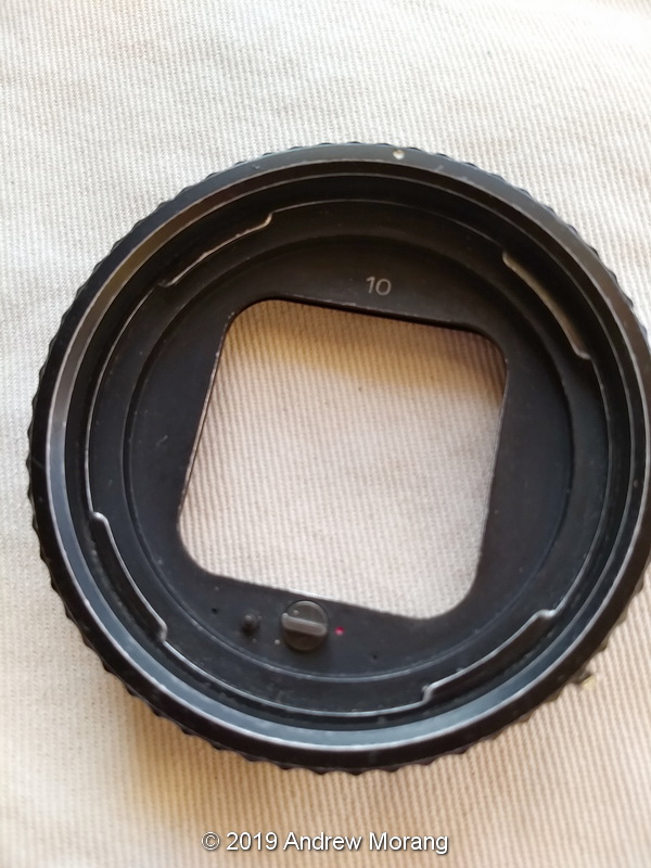

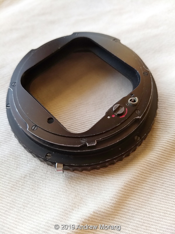

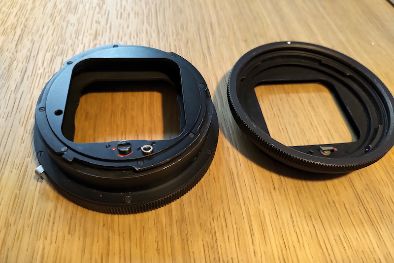

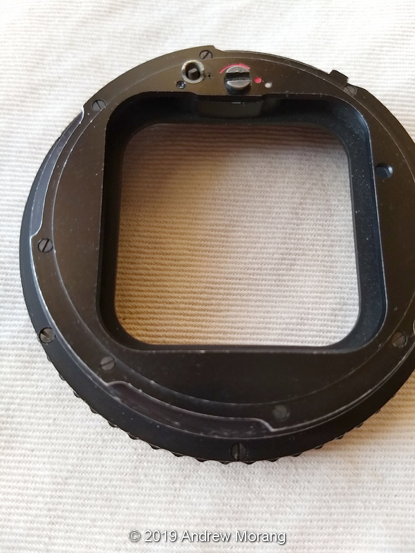

Yes indeed, these older tubes will only mount to 500c and c/m - I fell in the same trap back in the day with my 503CW. They collide with the shutter somewhat larger release button of more modern bodies.
PM sent
Kodachromeguy, here is the kind of tube you need for your 501 - note the different texture of the outside ring:
